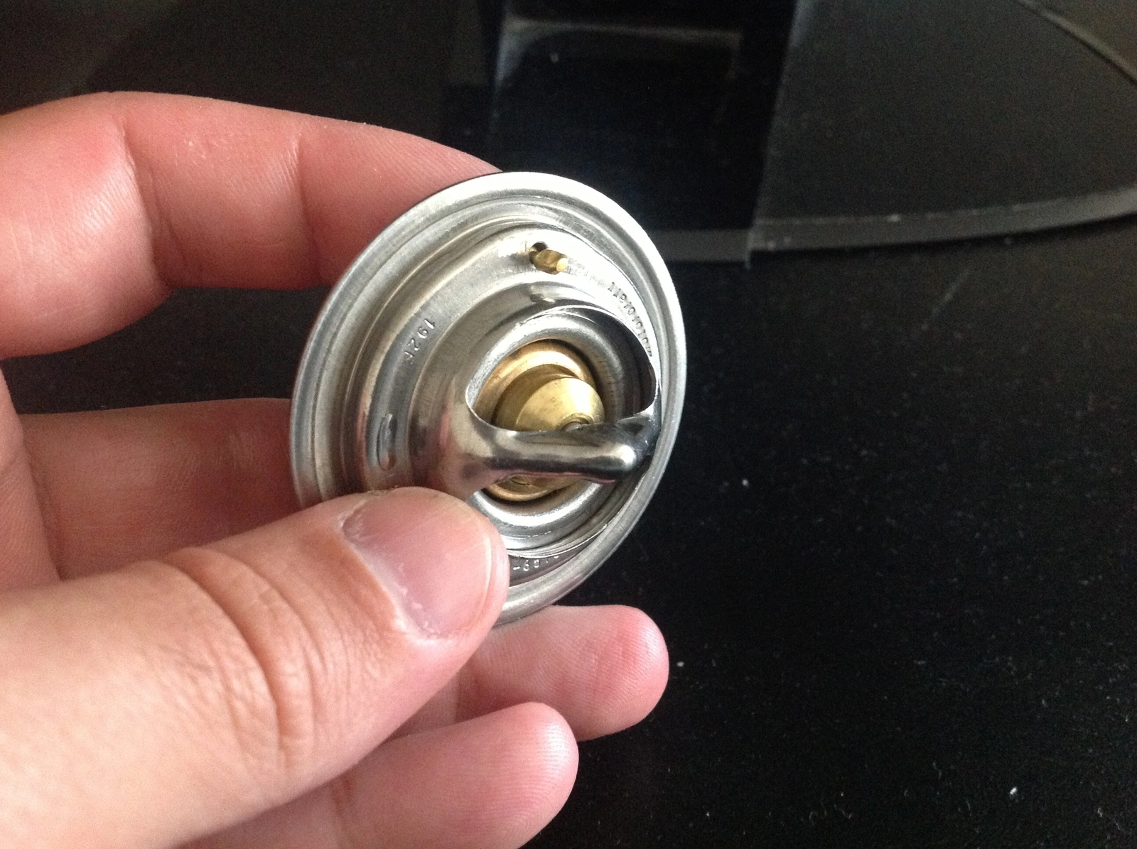

Our cooling systems are a pain to bleed because the air can only move through the tiny hole at the top of the stat. Furthermore, the coolant entering the block at temps less than the stat opening have to share that same hole. This is the reason Ford engineers put a hole at the top of the stat; to allow transfer of air/fluid for bleeding purposes.
