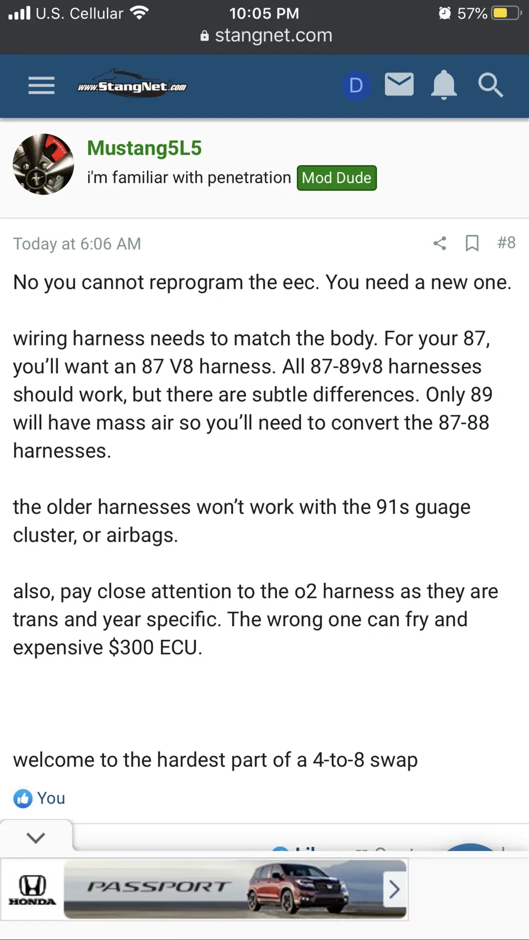

I am about to start swapping over my 2.3 to 5.0. And I was wondering what else I need. I have everything on this list plus parts that my engine didn’t come with when I bought it. But if I’m missing anything I’d appreciate it if I was told so I can grab the part before I start
I just need it to start run and drive and then I can work more into the technical stuff like brake calipers upgrade and all that stuff. Here’s the list of what I have:

Following. Trying to get some information about the same thing myself. I bought the car with the swap almost entirely finished. All that’s left is the wiring. 1987 4cyl to a 1991 GT 5.0. Just can’t find what wiring harness I’ll need and if I have to redo all the wiring.
