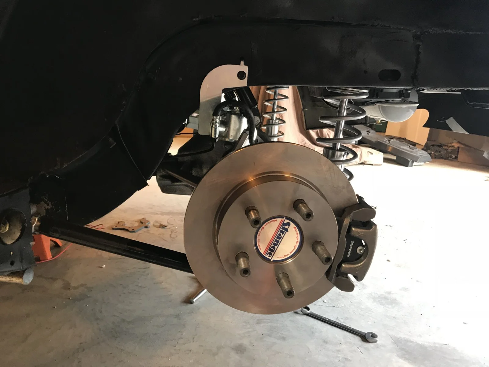

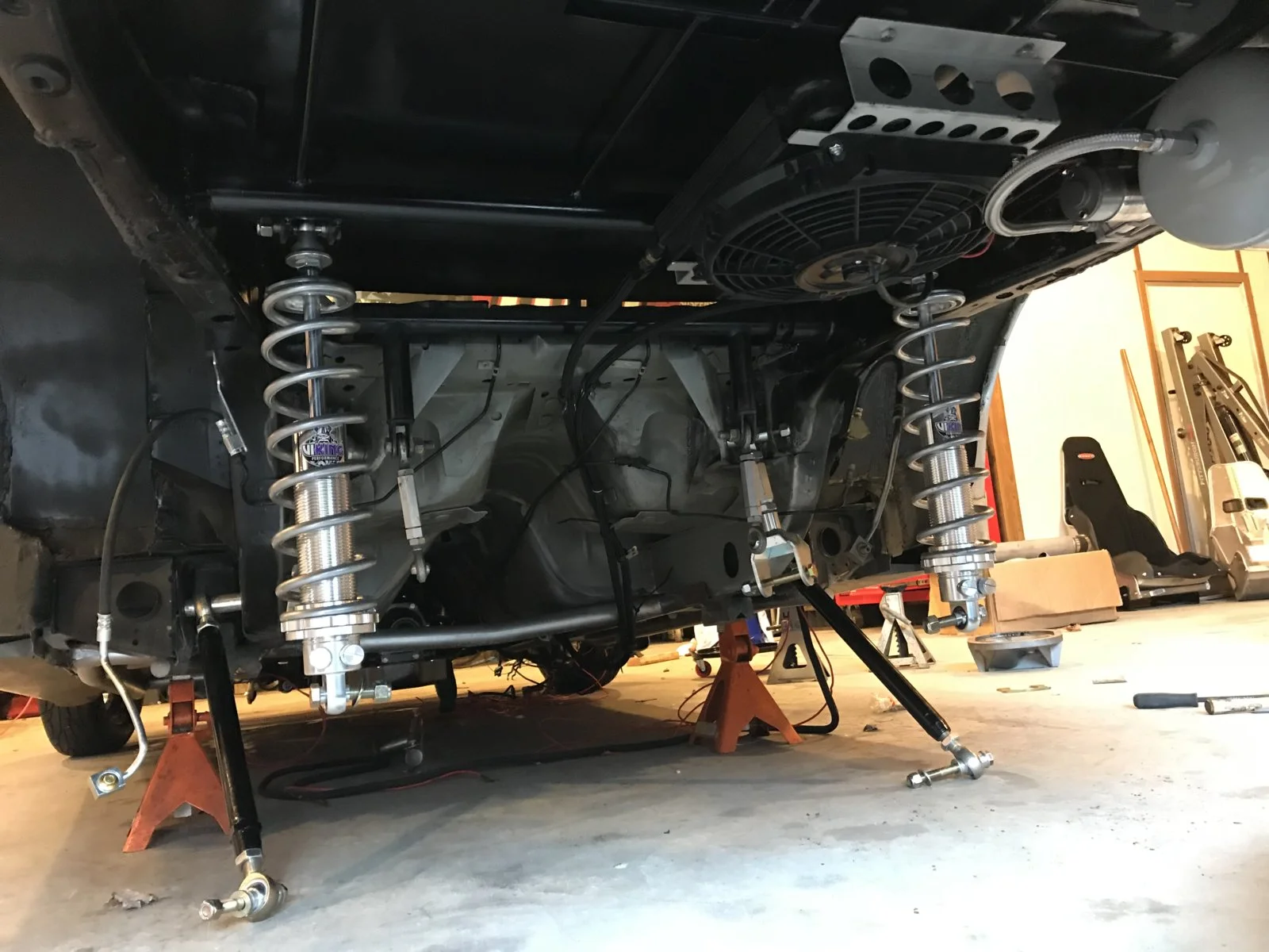

Got the brake caliper brackets modified and the stock brakes bolt up great to the 9” ends.

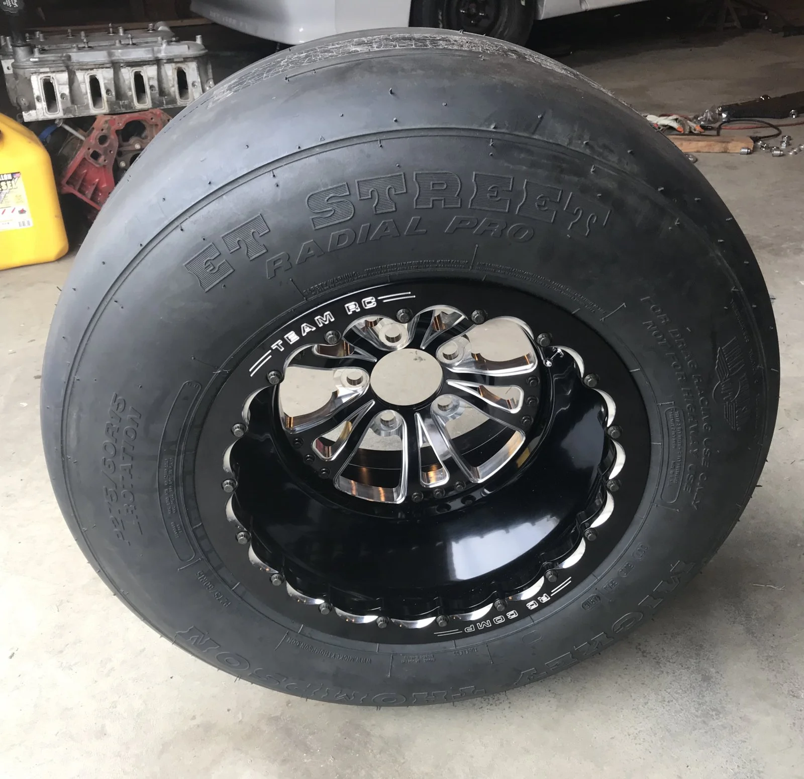

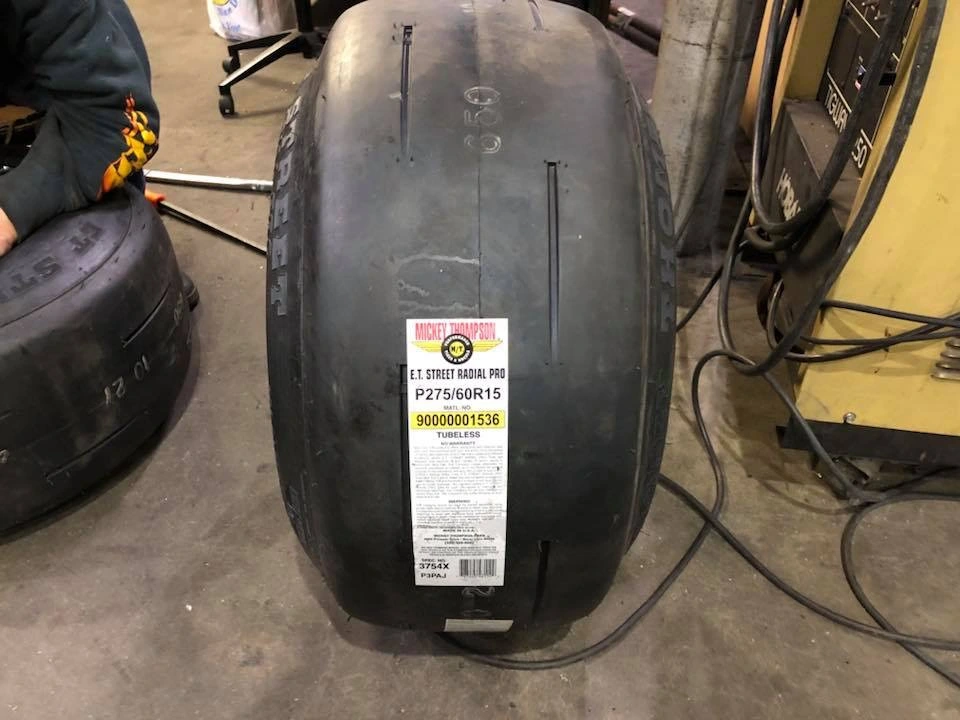

Unfortunately I can’t say the same for the wheels.

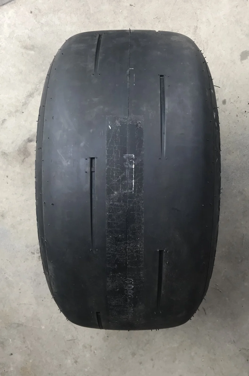

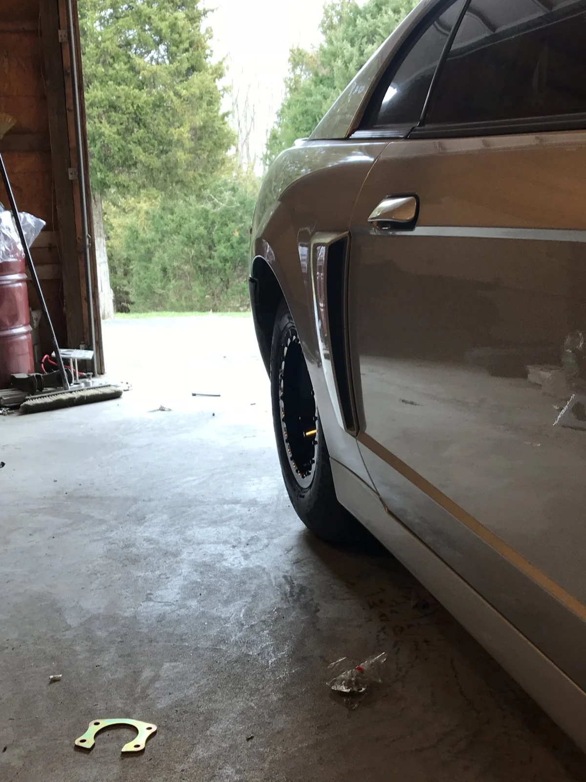

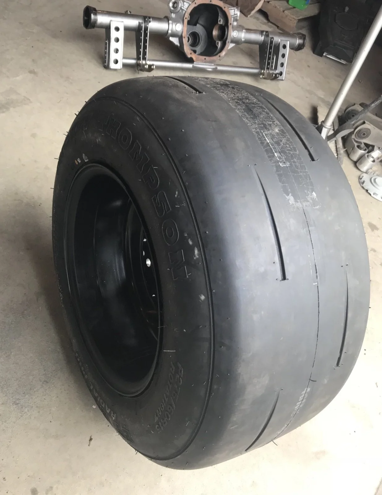

The fitment is absolute garbage. Hits the inside of the mini tubs. Looks like a roller skate. Terrible. Even with a 5/8” spacer(which I can’t run regardless) it’s horrible.
Contacted the chassis shop and as it turns out, they were under the impression it was going in a foxbody. So it’s about 1.5” narrower on each side than it needs to be.
Options are to lose money on ordering wheels with even more offset and hoping to sell my current rear wheels. This would also mean a 15x10 of any variety could never go on the car, ruling out any 8.5 tire events.
Or the option I chose, which involves about 6 hours of driving, an unknown amount of waiting and taking the housing back to the chassis shop to be widened and replacing the custom axles as well.
It’s not the end of the world, it’s not an unfixable crisis. But these are the things that really take the wind out of your sails on a project like this.
Hopefully I’m able to drop it off Friday, and can go from there.
