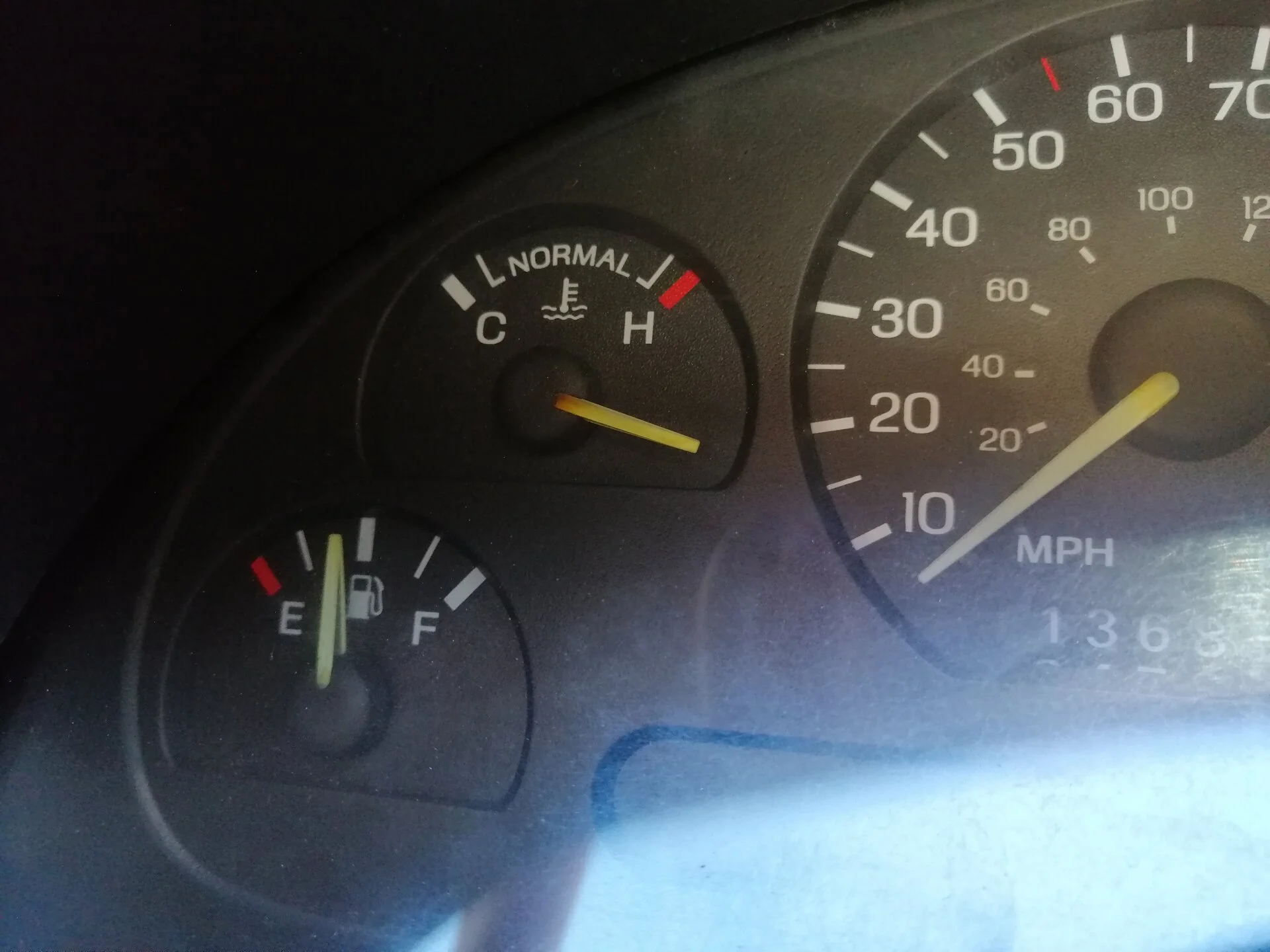

Hey guys, i have stang 3,8 v6 95' and after changing my coolant and few other things I've noticed this wierd thing with my temperature gauge.. I checked temperature sensor and wiring and everything is fine. Any more tips?
What do you mean 'it's not even touched? It's only one wire, use a test light with the clip on the positive batt cable and touch the connector with the probe (key off) if it lights up the wire is grounded someplace,
