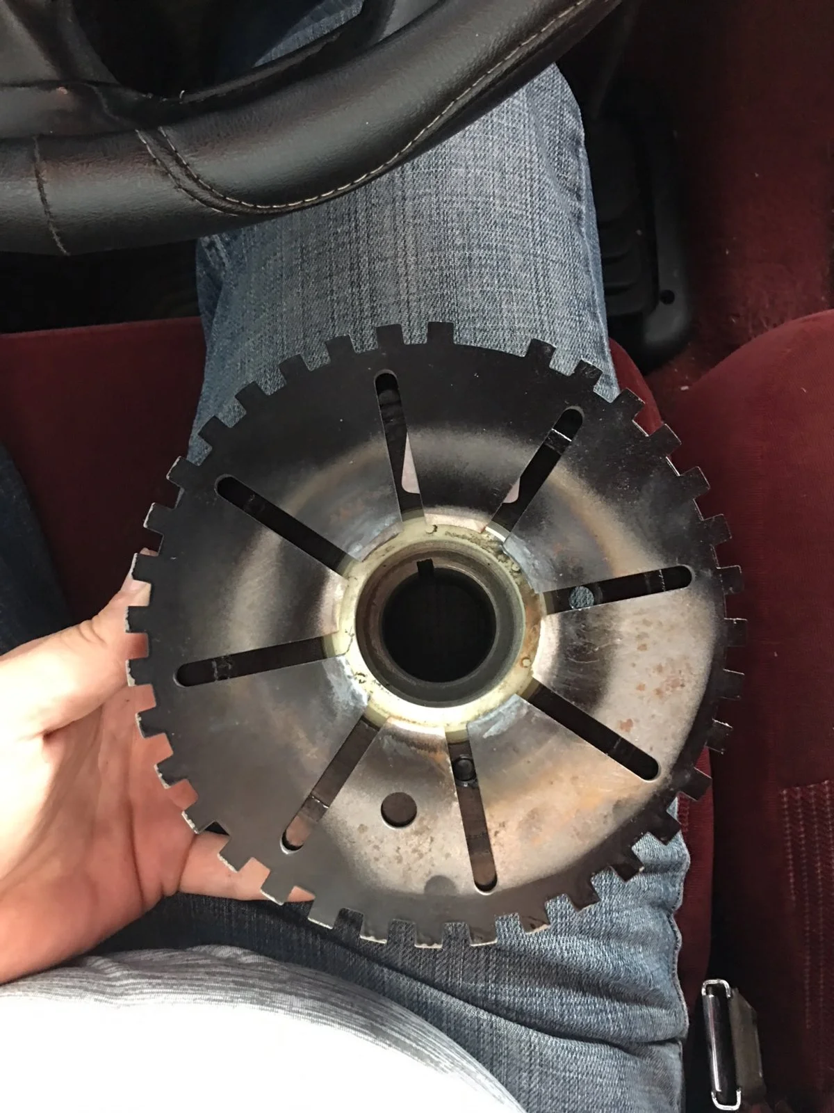

Alright, I went to the machine shop. "Why don't you just grind the opening more so it's loose in the middle, bolt it finger tight, tap it with a hammer to get the run out good, then weld it on?"
If it was a poisonous snake hanging in front of me, I'd have been dead months ago.
Thanks, mr. machinist. Also, you could tell he really didnt wanna fuk with it, LOL.
But what about the spacing. Aren’t you gonna have to space all of your accessories an 1/8” forward now?

I wondered about this too, but the signal wire to the computer is in the shielded bundle for the stock TFI harness. The other 2 wires in there aren't being used. I can log the signal from the crank trigger. It shows up as a square wave and looks like it's supposed to - 35 blips and a gap. I think the issue is within the MS - like I didn't mod it correctly to control the LS coils. All I did was add in a couple of resitors.... That can't be all that's needed! Nothing with MS is that simple.
