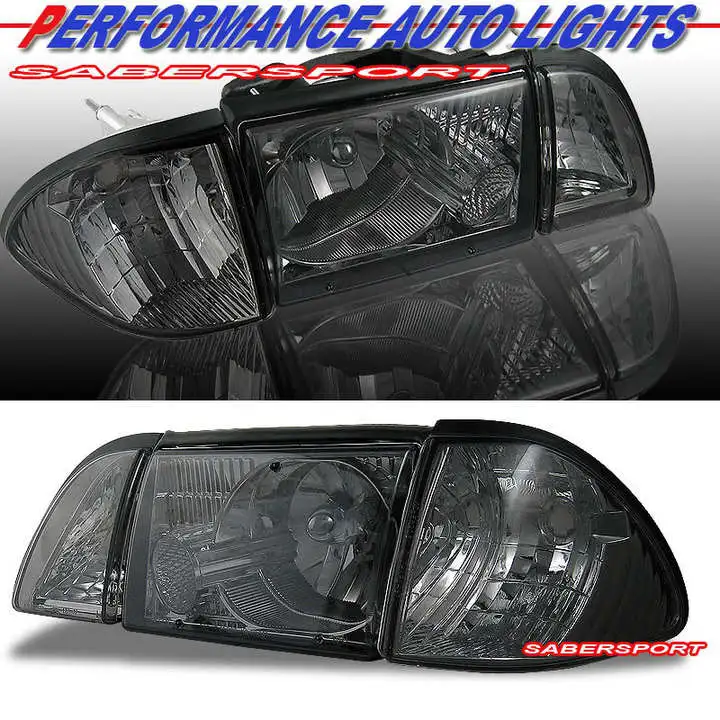

The smoked lens decrease the light output significantly. On a dark road you will run out of light to see with, and even high beams are less effective. Not being able to see well at night is a serious safety hazard.
Smoked/tinted lens are intended for show cars that get towed to meets and not driven on the street. If you area has vehicle inspections, they may not pass them, since most inspections check the headlight output and alignment. The LRS smoked kit even says "NOT DOT legal, for off road use only."

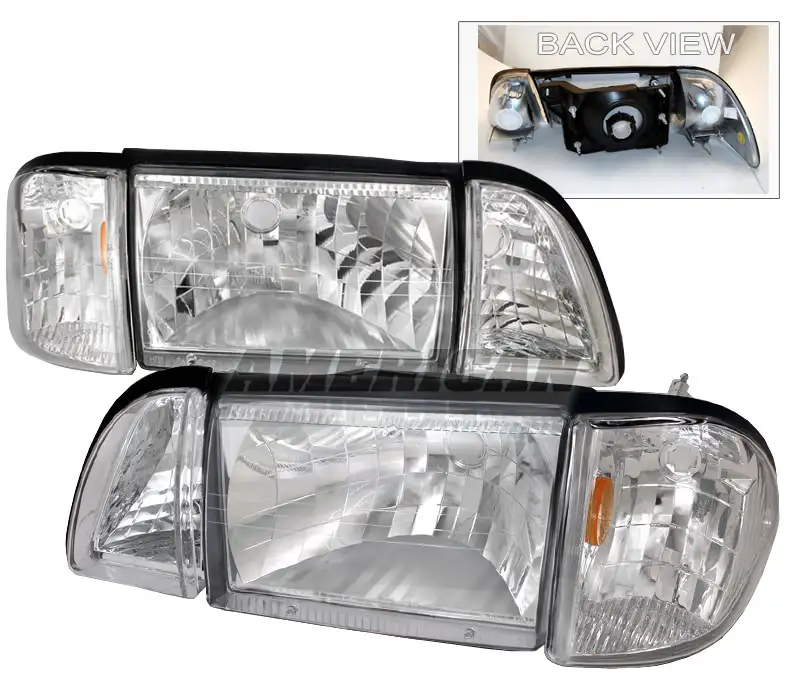

It took about 7 days to get the lenses, 20 minutes per side to install all 3 lenses and forever to try to align them.
I drove around for several days with the driver’s side headlight scanning the upper branches of trees for squirrels, owls and UFO’s. The headlight lens had extra slack between the retaining clip and the screw head which allowed the lens to shift around. Fixed that with some small washers between the screw heads and the bottom of the mounting hole. I would recommend that you find 2 extra adjustment screws per side - they are the ones with the hex ends on the end of the screw where it sticks through the mounting plate. That may help the alignment problems, as the stock setup only allows adjustment with 2 screws, and is hard to adjust in and down at the same time.
If you bought Genuine Ford headlights, the adjustment will be easy. If you bought reproduction headlights, they will be very difficult to align properly. I bought reproduction units the first time, and my headlights could not be aligned: they would shine up in the trees and across the road. I even had all 3 screws set up as adjustment screws.
The set of headlights I now have say "Ford" on them and they seem to line up properly.
The adjustment screws are upper inside and lower outside screws. If the headlights were re-assembled properly, they will have a 5/32" hex on the screw. You can use a 1/4" ratchet with a 5/32" socket. The upper screws can be reached with the hood up, while the lower screws may require you to lay on the ground in front of the car and reach them from the bottom.
