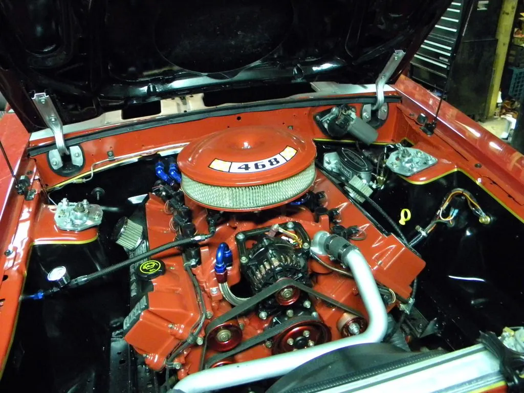

Take my favorite engine compartment as an example, ( cause this was about as sleazy a job as I'll ever admit to)
All of this.......is a rattle can. The holes in the strut towers are filled with JB weld stick.
Compared to the current engine compartment paint that is now failing, ( and which took me weeks to do) this one is the result of a couple of days, and a lot of slight of hand. ( you can see the frame rail is stock, but your eyes wanna stay on the contrast)
Sanding cured JBweld stick is only slightly harder than body filler, and if you press that suff in the hole and put your finger on the back side to mushroom the goop that presses through, you form a "JB weld rivet " that will not want to fall out.
Now,....take your lazy asses to Oreillys, and buy some canned paint and a couple of those 8 dollar JB weld steel sticks, and quit being such a bunch of lazy assed weiners.
