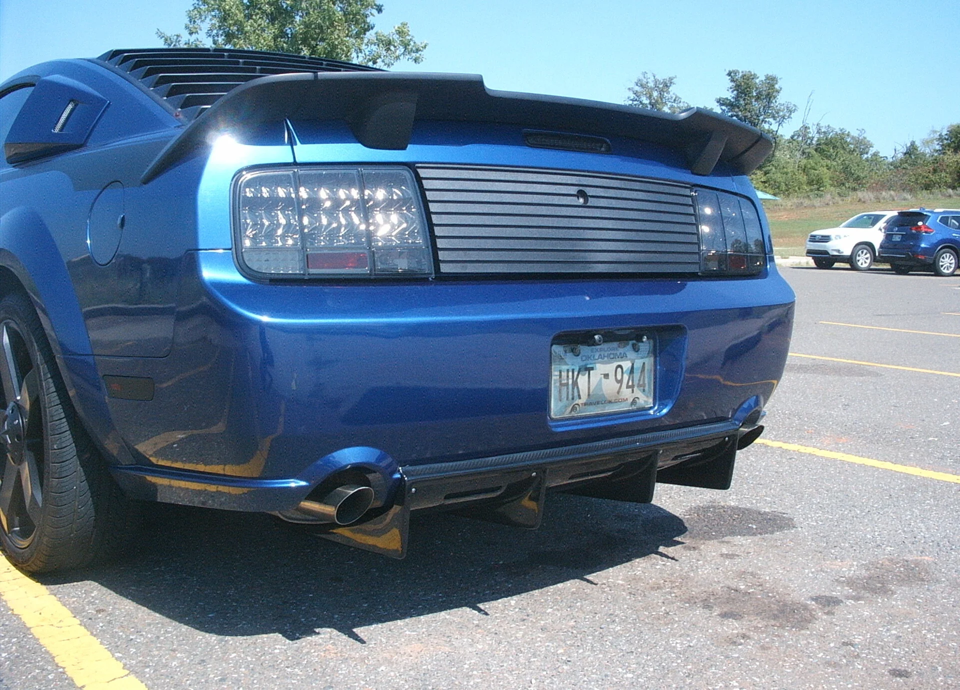

Pictures? My car doesn't look any different at this time. I do have a set of two carbon fiber heat vents to install on the hood. I made a template out of aluminum so I can transfer the inner outline onto masking tape on the hood. Probably won't get those done until next weekend though. I have to go out and put the carbon fiber diffuser back on. Had to remove it so it wouldn't drag on the ground when the car went up onto the flatbed truck used to transport it from the Air Force base to Rick's shop.

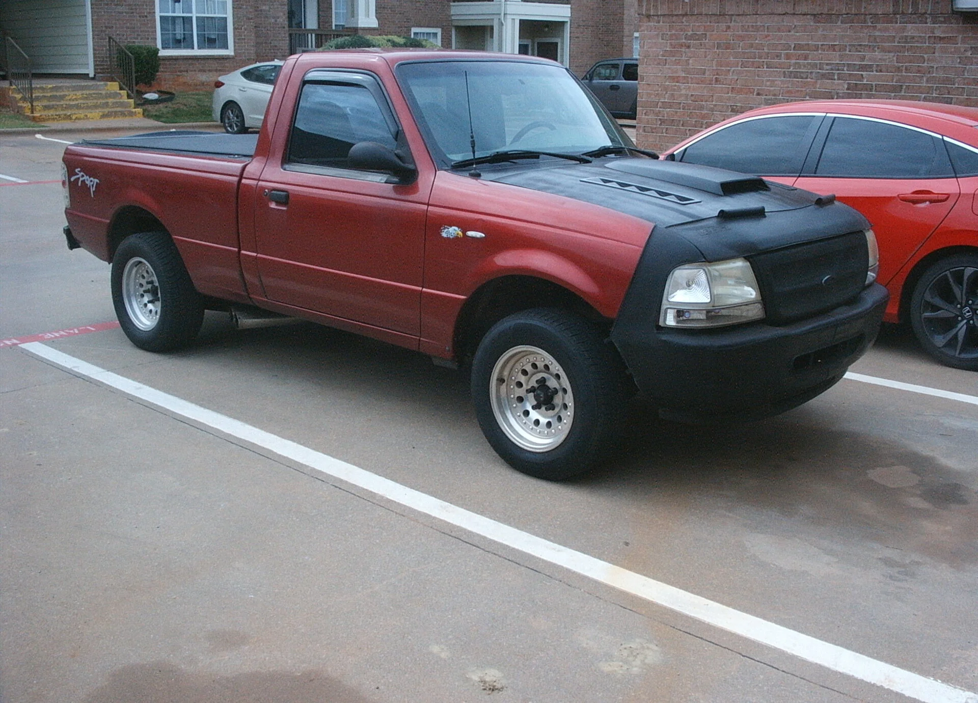

No. I have a 98 Ford Ranger as a daily, had it going on 22 years. It's been super reliable. 3.0 V-6 automatic, with the trans being the predecessor of the 5R55, the 4R44. Never a lick of trouble with it. I did just have a shift kit put in it while it was in my friend's shop getting the rear axle ratio switched from 3.73 to 4.10.
