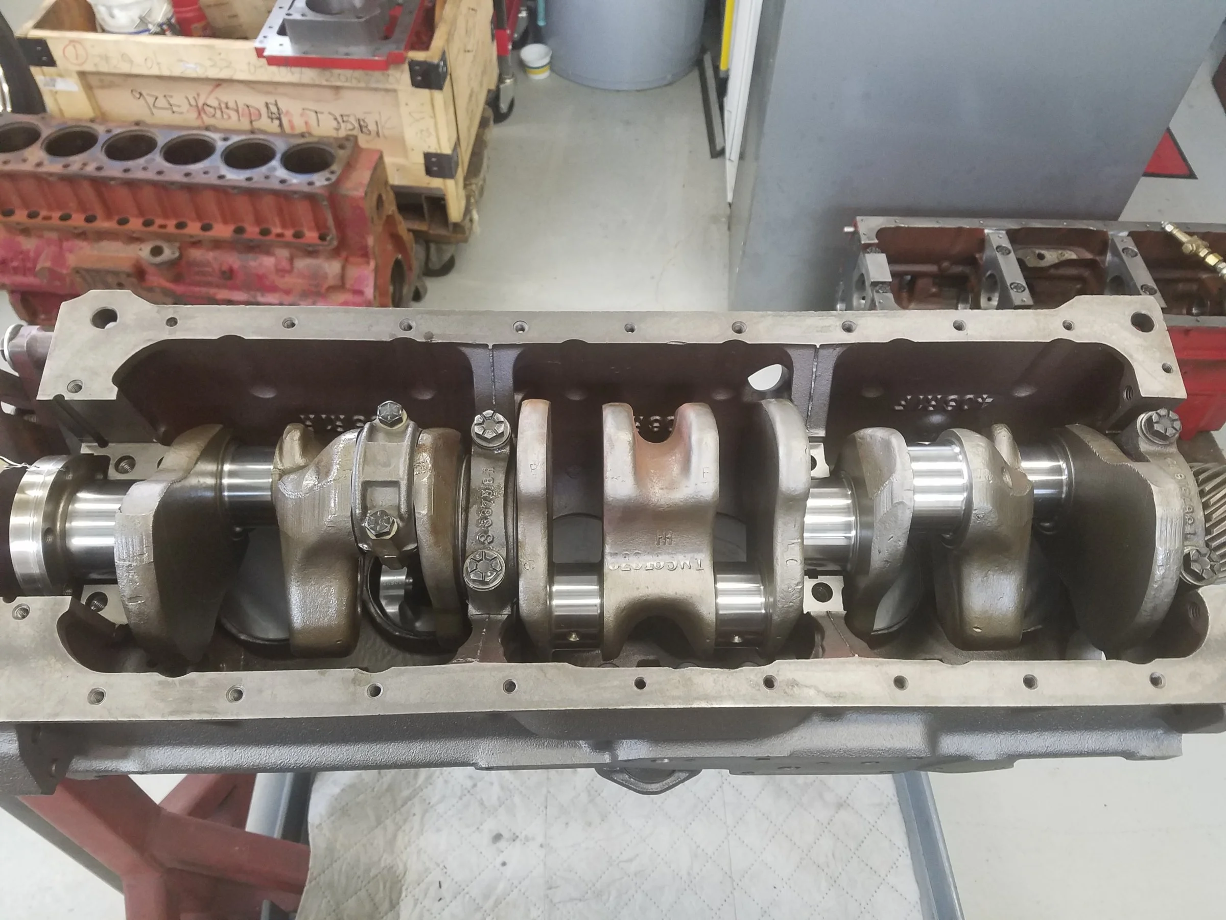

Here is my I6 tractor engine that I am building with LSX ring set, 3.75" bore. These are custom pistons with my combustion chamber design. Reducing ring drag by over 60% with a thinner rings and will be able to run multi weight oil.

Just as a comparison The tractor ring set was .125 top, .125 second and 1/4" oil ring. The LSX ring set .047 top, .047 second, and .118 oil ring. Thats a hell of a lot of reduction in ring drag which translates to HP. This is a pretty much a stock rebuild BTW.
