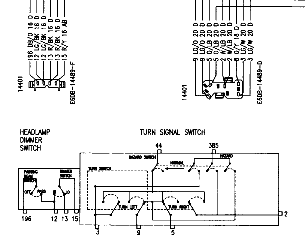

The following diagram is for 87-89 model cars.
Turn signal switch wiring:

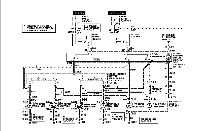

The following diagram is for 90-93model cars.
This may help you. From another post on turn signal problems problem
