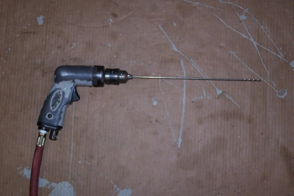

That is a 12" long #40 (3/32") drill bit.

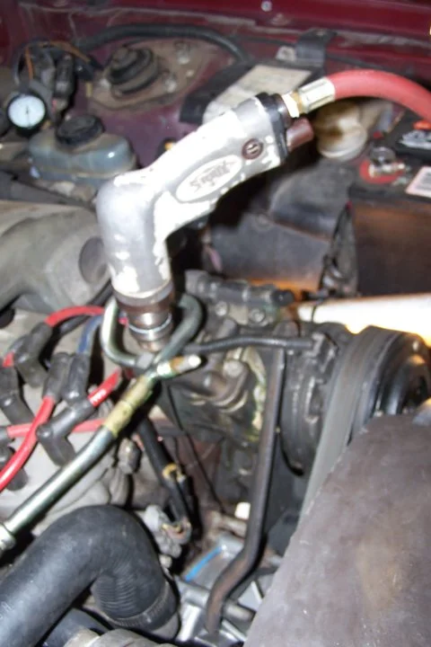

This is where it gets used;

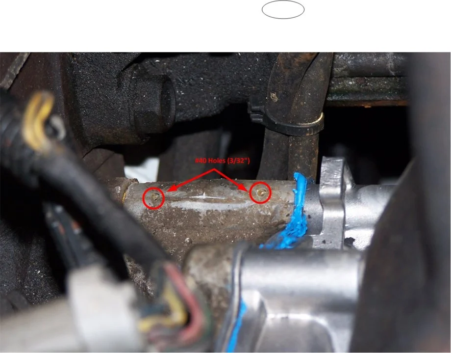

This is the result;
Stick the soda straw on the PB Blaster in the holes and squirt away. Wait a little bit and squirt some more. Rock the bolt back and forth. squirt some more...The bolt starts to turn without excessive force, squirt some more. Then with a 1/2" ratchet, it begins to wrench out without any problems.

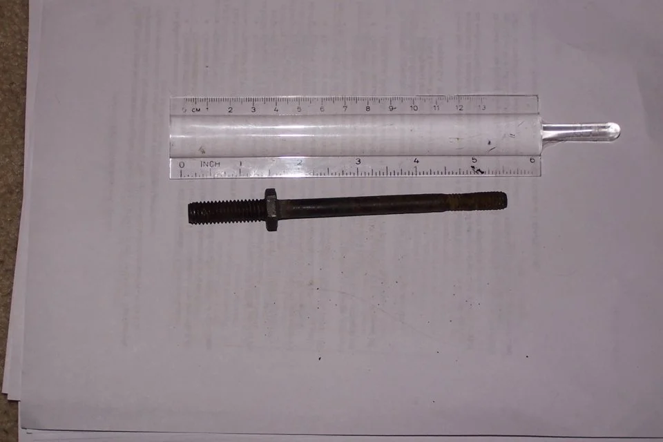

The offending bolt; notice the necked down part just above the threads. That is where the bolt would have sheared off if brute force had been applied.
A couple of dabs of JB Weld will cover the holes and keep out any moisture.
This is the result;
