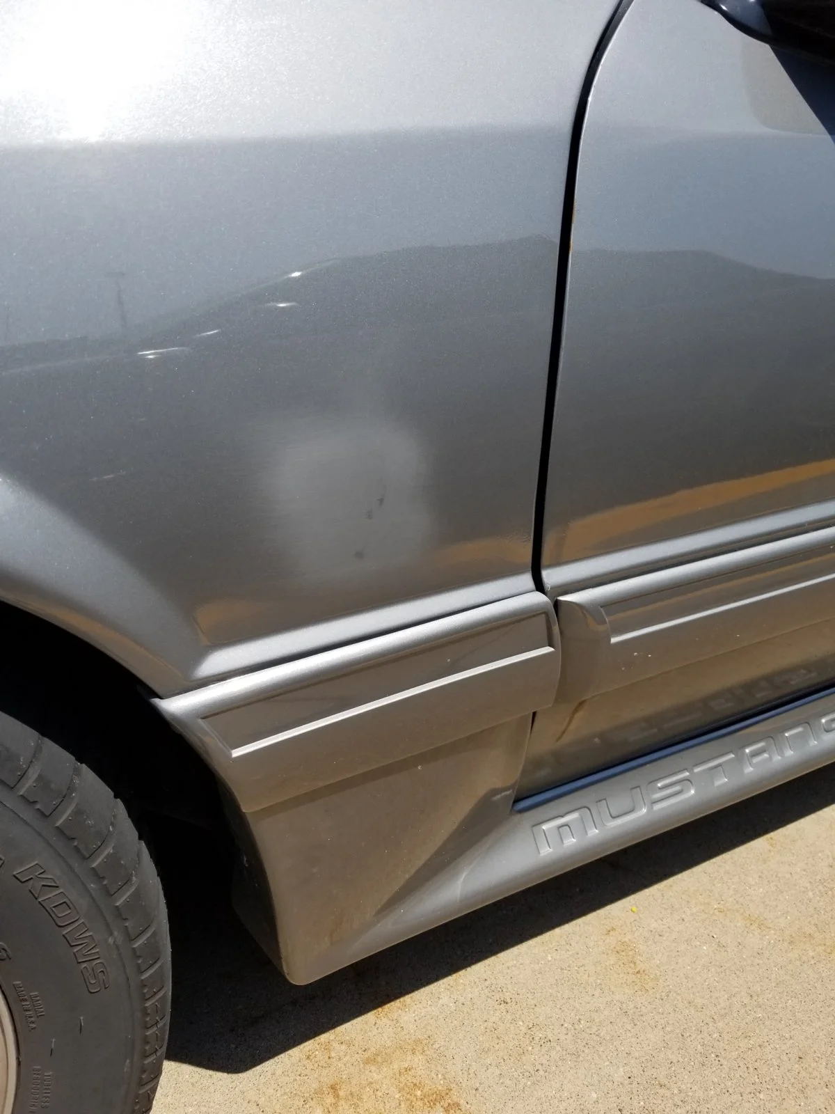

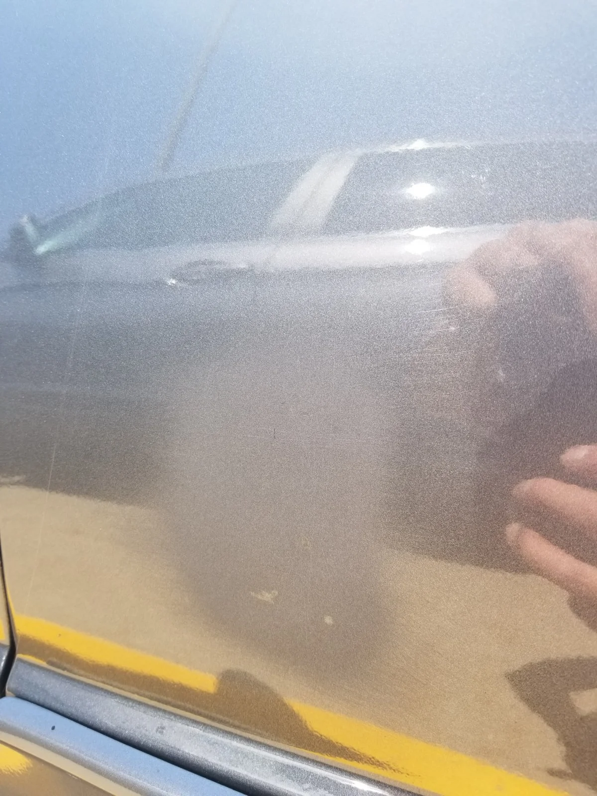

#28
the clear coat has been rubbed off as well...I'm just doing what I thought I read and what some people I've talked to said....guess I better go back and reread!!..lol
You cut through the clear coat with the scotchbrite?
All this talk of buffing the panel was based on the idea that you just scratched up the surface a bit with the scotchbrite. To include getting a fine grit wet/dry sandpaper like 1500-2000 grit.
If you've really cut through the clear coat, you'll end up with what I refer to as a buttthole there after buffing.
Do me a favor and post a picture of the area again except this time get it wet first, water would do fine. Try to get as good of a picture as you can. Try to have decent lighting when you take the picture.
PM me and I'll give you my phone number, it'll take five minutes to figure this out instead of several days of posting messages.

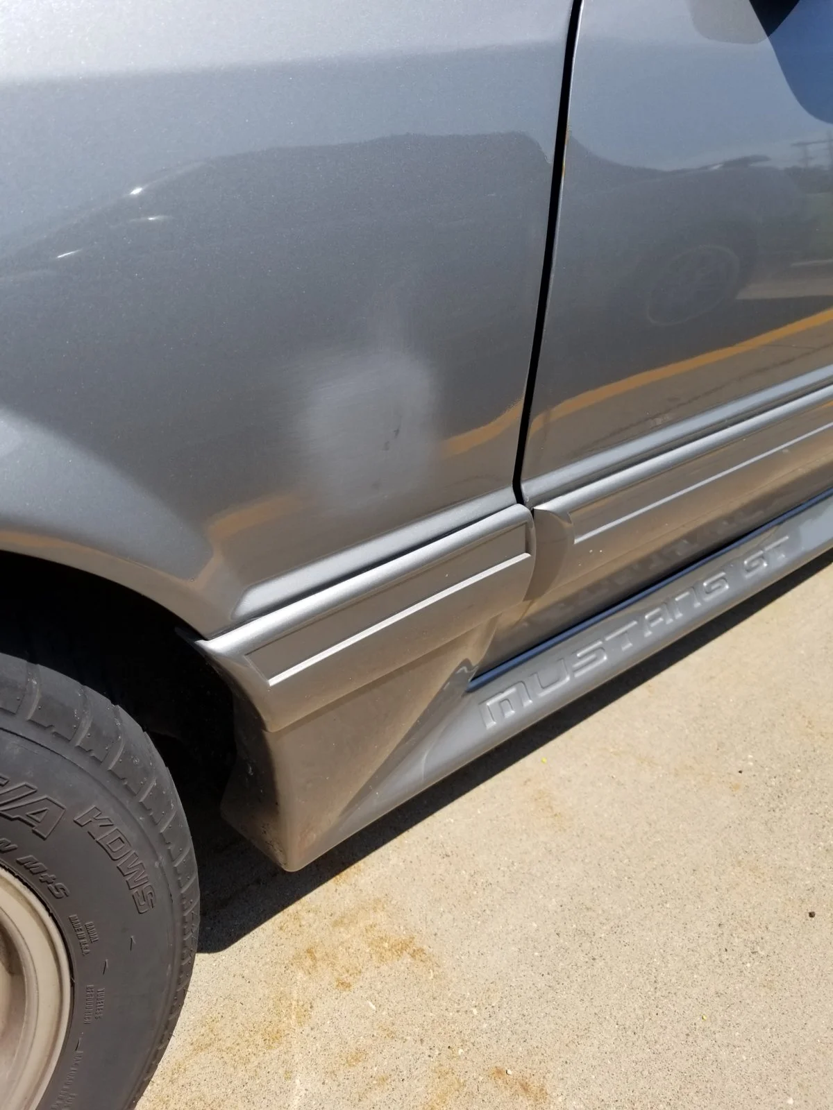

#29
here ya go man...hope the pics are decent

#32
is it bad?...I read someplace to use the wd40
BlakeusMaximus
Mustang Master
Jul 12, 2017
1,060
355
123
#33
Try polishing it out with some the the rubbing compound posted above first. If some of the deep scratches are still there lightly wet sand them with 1200 grit sandpaper and the go over that with 2500 grit, the polish again. The clear coat on these cars is old and there isn’t a lot of it on the car so be careful. If you don’t fell comfortable doing it, run it by a reputable body shop and have them do it. And yeah, Why did you use a scotch brite pad and wd40 on it??
