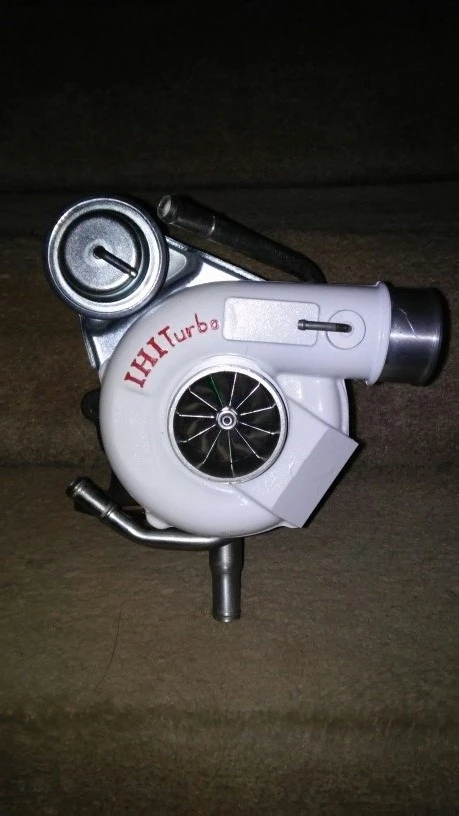

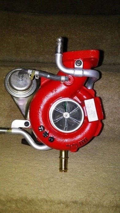

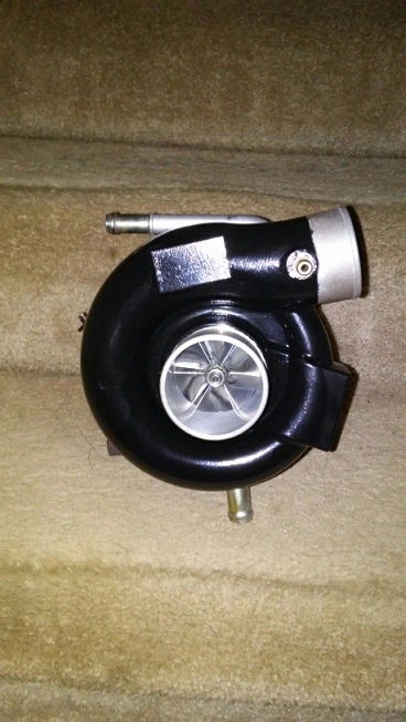

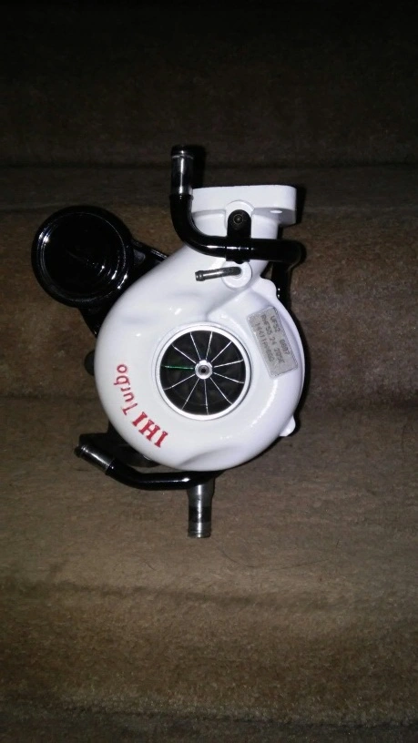

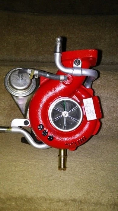

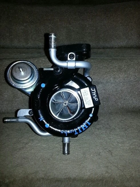

I build OE style and Custom turbos for Subarus and have built some big horsepower turbos. One of them has turned 559AWHP with 603LBFT out of 2.5L DOHC Boxer engine. That number is horsepower at the wheels driving all 4 wheels. I've also built a few for other asshats that "know that I'm doing" and watched them blow the heads right off their cars. I don't build huge custom turbos anymore because no one wants to pay for the work involved, plus most people are expecting something different to happen than actually does. Huge turbos have huge lag, and most people don't get it because bigger is always better, right? NOT...especially for a DD street car.
There's a LOT more to going turbo than just bolting it on and stomping on the throttle, hence the reason I no longer build for people that just want to "turbo their car". If you're building a V8 car, two small turbos will give you a lot more yield in driveability and solid street performance, than one huge turbo. You see the big turbos on drag cars and they work because that particular vehicle is designed around the turbo and it's boost capabilities. Not real world effective for a street car.
Turbos are NOT like superchargers in that the spool time for a turbo gives a lag time up to a certain rpm and then when it hits, it hits HARD and can literally destroy parts if the parts are not correct for the application. Superchargers in street applications put out 6-9 psi of continual boost while a "BIG" turbo will have a couple thousand rpm lag and then immediately can put out 30+ psi of boost, and that does NOT get along well with compression unless it's built to compensate for that big hit.
A few photos of some of the work I've done.
