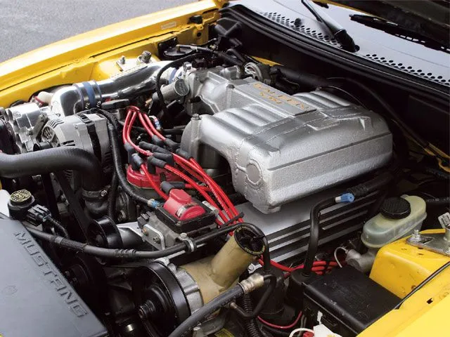

The S-351s started with '94 Lightning 5.8 short-blocks, to which Saleen added Edelbrock aluminum heads, 30-pound injectors, a roller camshaft and lifters, a 77mm mass-air sensor and 65mm throttle body. The final tally was 371-rated horsepower at 5,100 rpm and 422 lb-ft of torque at 3,500
And that sure looks like the stock GT40 style intake.

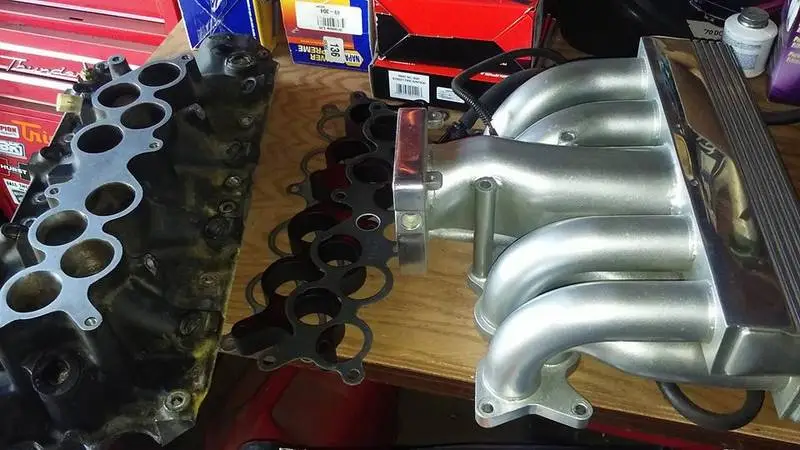

You can keep the Explorer GT40P heads, but you need the Upper and lower intake, MAF and injectors. This is because the air flow of even the Showa GT40 upper intake is lousy.
An upper and lower intake like this
MAF was the 4.6 liter Quad Cams 82 mm item
Mild porting, the right valve springs, rockers and making sure the EECV system isn't running lean will help.

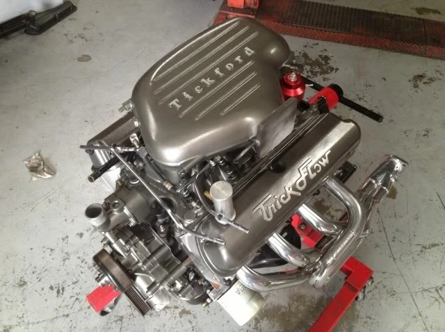

For 1999 to 2002, the 1970-1972 QC process got re-started with Tickfords ex Aston Martin engineer Dave Flint, and then continued with the Quad Cam 5.4 in 2002 and then the later Quad Cam 5.0 engines untill 2016.
The 5.0 Explorer blocks were the low point in quality compared to the early blocks, but a little spit and polish, and you had an extra 120 hp with stock Ford Motor company parts.
The Aussie use of special EFI upper and lower intake air managment, the use of non forged pistons with long rods, cast cranks, and plateu hone bores to be kinder to the block at 6000 pm, all of it has filtered into current US practice.
Main bearing block girdles,
upper block ties, and the simplicity of using the junk yard Aussie EECV, or EMS computer systems when there isn't IM testing,

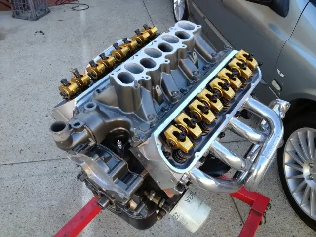

well, that opens the door to streetable 400 hp at 6500rpm 5.0 liter combinations which won't split blocks at 7000 rpm.
That's why I like 5.0 engine build ups like this.

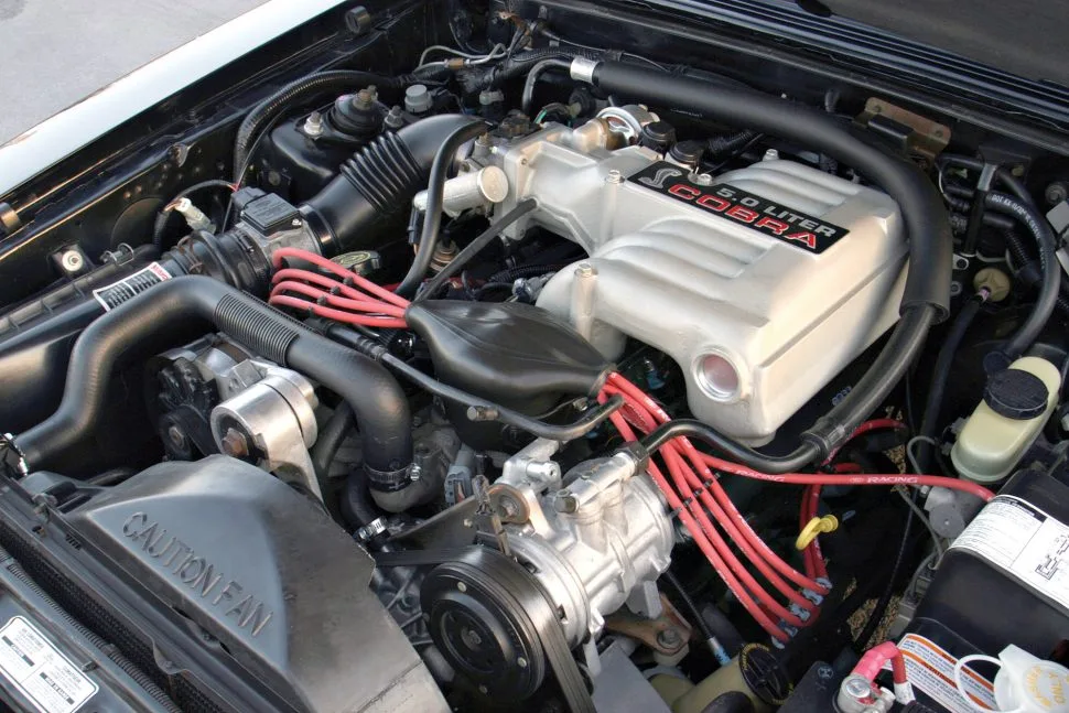

Don't be scared of EECIV or EECV.
Its got some issues, but you can swap the whole system over if you have the pinouts, and its really nice if you have it working with 380 hp and not tripping a check engine light. Some Four eyes have MIL lights... the transfer of a broken scrapped SUV engine into an old Fox platform makes it a HSV...Humanitiran Service Vehicle.

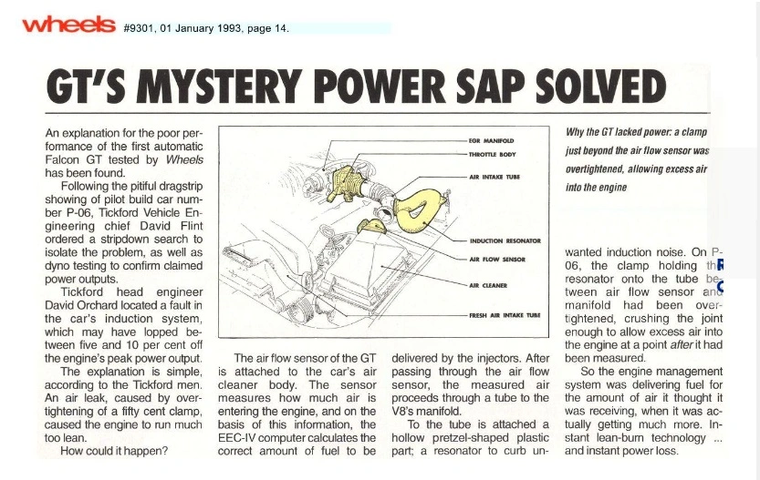

All I know is that its nothing to drop 30 hp by just overtightening a 50 cent resonator clasp.
266 to 274 hp and 15.3 second quarter miles, to less performance than the stock 225 hp 5.0. Clearly, a 1 second 1/4 mile ET loss is more than just 20 hp.
According to the inferred info from David Flint, the loss was up to 24 hp (10%) due to lean WOT air fuel.
I can do it in a few turns of a flat head screw.

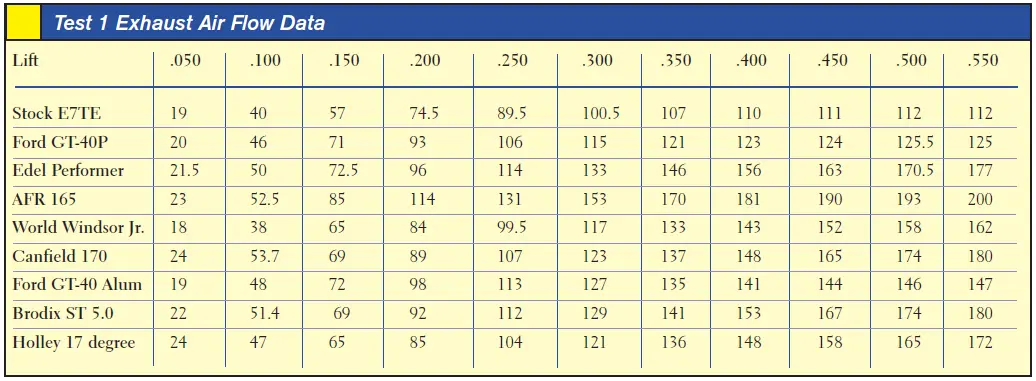

Its the whole combination flow rate, not the pinch point cfm.

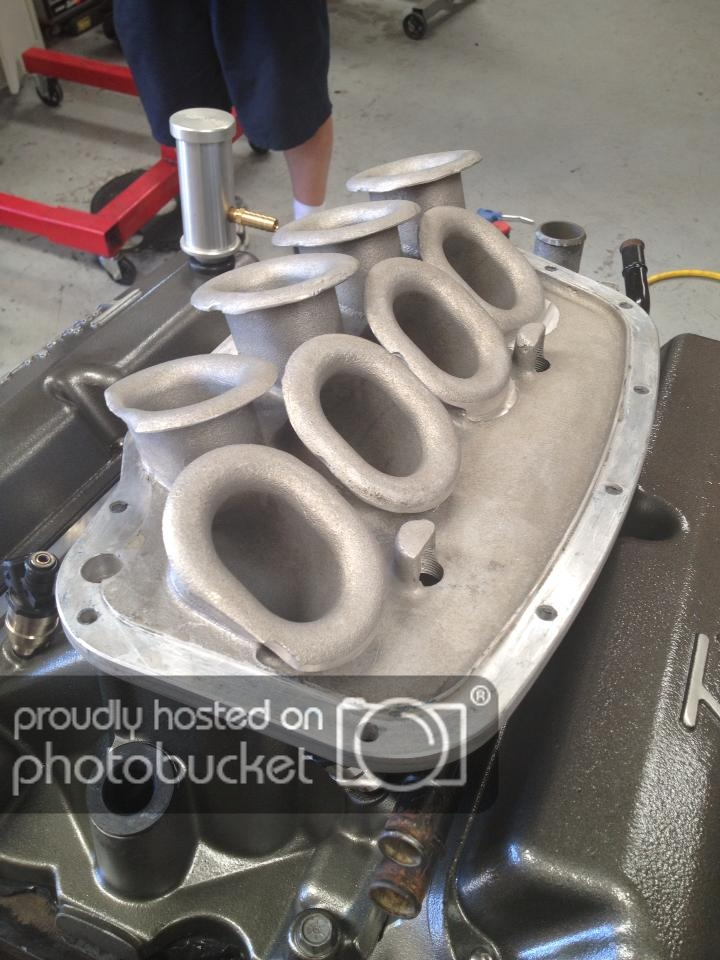

Even Ford hand modified the intake runners on all its Synergy 5000 engines. They weren't 190 cfm after the modifications.
Initially, for 1993 and the return of the GT Falcon, the Australian GT's and XR8 Sprints got a Showa GT40 Tubular intake that was not made in USA, and it had a half inch spacer. Much latter on cars got factory Y303 GT40 alloy heads from Fall 1999 to Spring 2001, but it was withdrawn after the 500 or so heads emptied from the imported stockpiles, and except for the 65 pound weigh saving, there was no HP gain with them as CFM and spark ramps stayed the same.

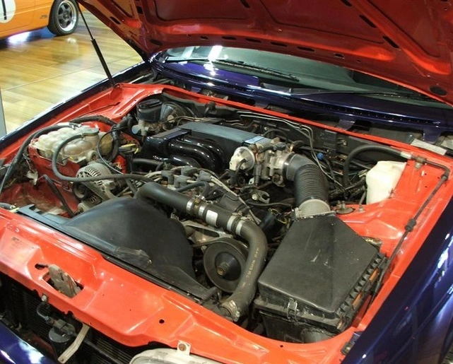

.....Jack Roush from 1988 to 1994, had been playing with the 5.8 spec, starting with the 375 hp twin turbo 351w for the 25 Aniversary Mustang,
then sending a engine overseas in Australia. It was a 1990 EA Ford Falcon 351 GT development 'hack'
which was suposed to be written off. Instead, it is proof of just what Jack was up to for the Ford motorcompany world wide.
Windsor 5.8L 351 CID V8
305 hp, 350 lb-ft
0-62 mph - 7.3 seconds
Standing 1/4 mile - 15.4 seconds after factory emiisions and durability test 50 000 miles. The engine was way down on power, and was on LTD rims with 205 65 15 tires in a 3500 pound car. ...

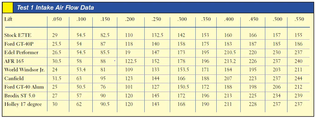

http://www.autospeed.com/cms/article.html?&title=Hints-from-Herrod&A=1704
Its not heads, its the whole flow combination.
The intake system is only as strong as its weakest link. By upgrading your throttle body you can help support other mods your fox has and increase throttle response

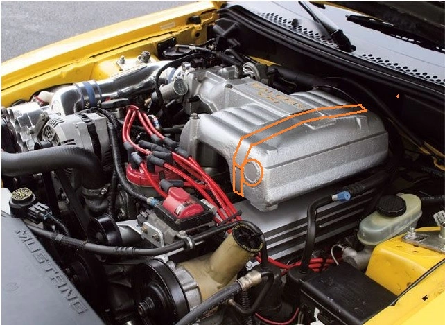

In order to get a 351 to make 371 flywheel hp, Saleen grabbed an EO and OBDII certified intake manifold, and cut and flitched it for air flow.
Look at the orange cuts
Then added those Edelbrock alloy heads to be sure, to be sure.
To get 300 rwhp, they needed 371 emissiones horses at the flywheel. So do you.

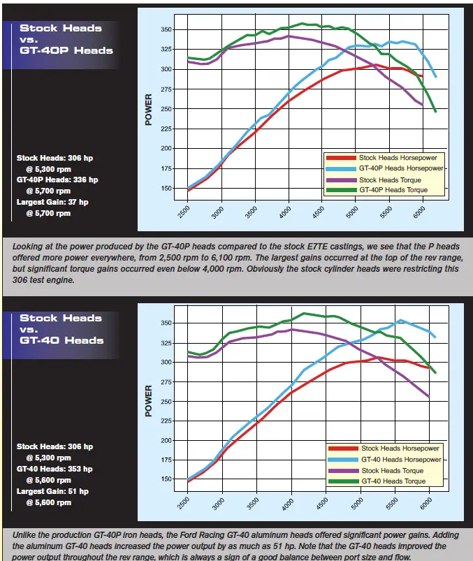

You can do that with GT40P heads....they called them GT40 heads because they are 380 to 390 hp capable heads just like the LeMans heads used in the old Quad Weber GT40 race cars.
227 rwhp is 170 kilowatts. With a four stage auto, you need 340 flywheel hp to make a certain 227 rear wheel hp.
If its a T5 or Tremec, you only need 380 flywhell hp to ensure for certain you hit the big 300, and you'll do that with the best modified iron GT40P heads with a cam and good valve springs.
What you'll then have is an engine that will be strangled from 5000 to 6250 rpm, too lean, and you won't be able to calibrate the engine management system.
The intake, upper intake and exhaust have to match the heads, and the car has to be dynoed to ensure you match it. I wouldn't spend a dime on alloy heads.
Before the Explorer engine, non Cobras, the HO 5.0, had bad heads. After the GT40P, Ford fixed that. Down here, Falcon EB, ED, EF and EL V8s got E7 headed or early GT40 heads, and they just didn't respond unless you added alloy heads. The GT 40P's, (the Aussie AU Falcon V8), they lapped up every 77 to 82 to 90 mm MAF or Throttle body, and you had to use a proper high flow upper and lower intake with a much better single exhaust.

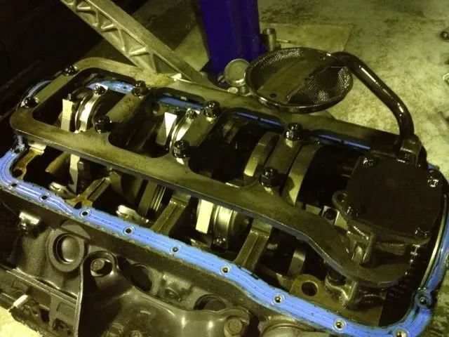

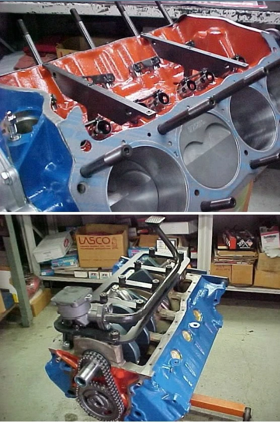

Now you got them, you'll have to do the cam, and find a crank girdle and upper block stays.
Ford Australia added the 335 hp 5.6 stroker 342 to the Explorer 5.0 engine block in the last year of OHV V8 production.
It got a crank girdle to hold it all together, as well as a proper intake manifold.
I've seen a lot of cracked 5.0's, so I too would go for these two additional things every time. The stock dog bone valley chest drilling is also a known stress propogation as well, so link bar roller rockers as per NASCAR would be a choice i'd make too.

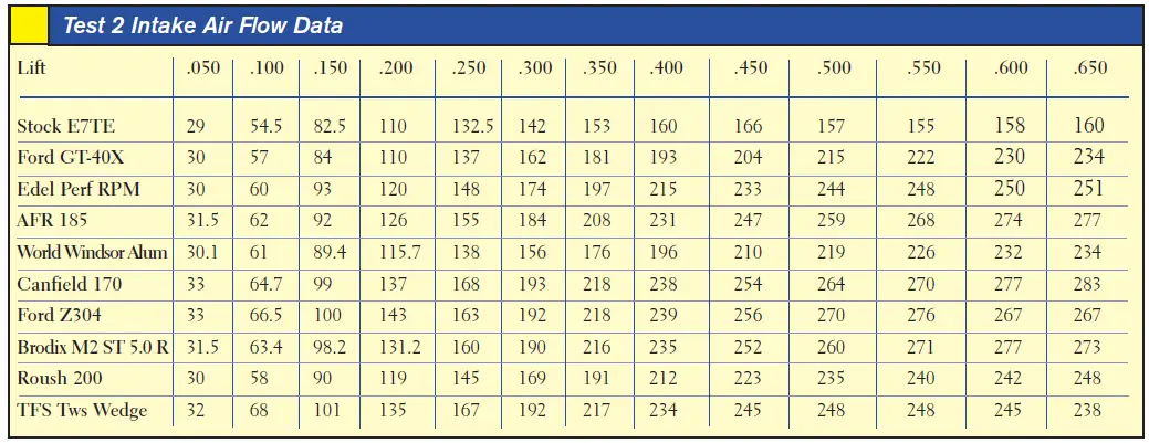

Come on, man. That's not what a guy who just spent money on x-heads wants to read, and it's misleading, anyways. Ford did things differently in Australia, I presume, but you're talking to an American in America with American Ford stuff. 'Murica! :flag:

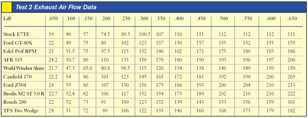

X303 (64 cc) and X305 (58 cc) heads are far superior to non-ported GT40P heads:
628408
628409
628410
628411
I've seen untouched X heads at 300 rwhp on a stock bottom end 302, though that takes a good combination, and is easier to do with a more premium AFR or TFS offering. Yes, people can run 300 rwhp with P heads or even E7s when ported, but there's no reason to imply they're a better or even equal head. That said, final5-0 must have been referring to the Y303 heads, which, according to common knowledge, are effectively like GT40P castings, but as you can see from the flow charts above and dynos below, that is also not true, though they are not cost effective heads, IMO. I personally haven't seen many Y heads around, though.
GT40P vs. GT40Y aluminum heads on a 302 by a dyno sbf book (Unfortunately did not see a direct P or Y vs. X dyno).
628405
The GT40 intake CAN support 425 hp, though that's at the crank. It is pretty commonly known that the lower end of the GT40/Cobra/Explorer intakes are the restriction. I've never seen anyone dispute that a GT40 upper is slightly better than a stock casting Cobra upper. However, @89stang1 made 364 to the tire (~428 hp at the crank) with an unported Cobra (upper & lower). It was clearly choking the motor at that point, but that's proof positive that they weren't exaggerating about the GT40. Presumably, a ported lower would pick up more, and a GT40 Upper would also pick up more. The best of those intakes would be a ported lower and a ported Cobra/explorer upper pair, though the 10-15 rwhp may not be worth the $$$ or time.
Also, aftermarket block girdles (both crank and lifter valley) are a waste of money on a stock block, as they will break north of 500 rwhp regardless. Maybe Ford Australia did a better job with there girdles. I personally wouldn't spend the money, and I don't know why Ford Australia felt it was necessary for a 335 hp engine. The only thing that keeps these blocks together is avoiding detonation, high RPM, 550+ rwtq, & 500+ rwhp (perhaps 450rwhp with a blower).
