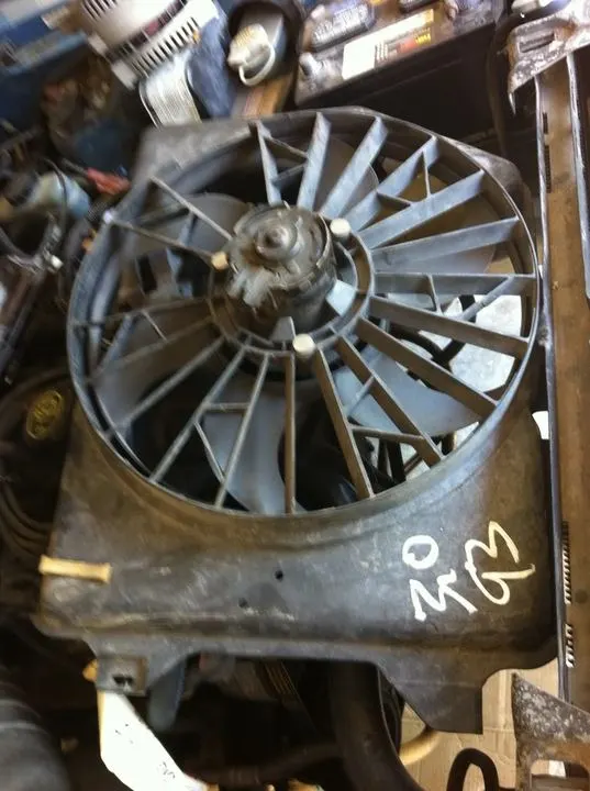

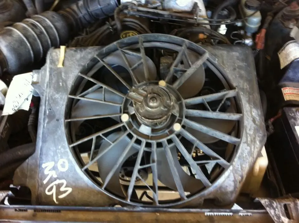

  13. and heres a picture of the fan. its from a 1993 Taurus. it seems like it pulls more air, but the motor looks to be the same aize and has the same plug. it does have a full shroud and 6 blades though. so even if it doesnt pull more air, i do believe it will cool better.
    i also received my 3G alternator today, and will start that swap next week along with mounting the fan. then need to pull the old trans, install new and install clutch cable. also ordered new shocks, going to do fluid change on everything including differential. hoping to have her on the road by the end of the month!

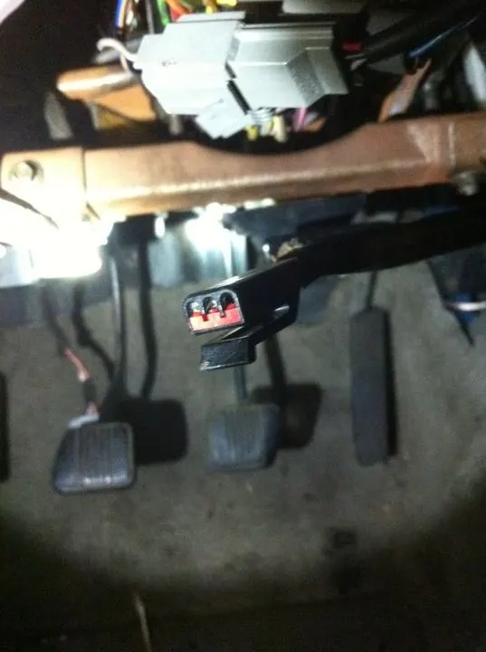

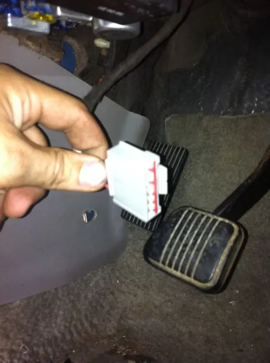

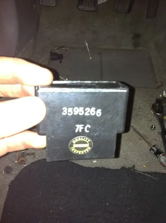

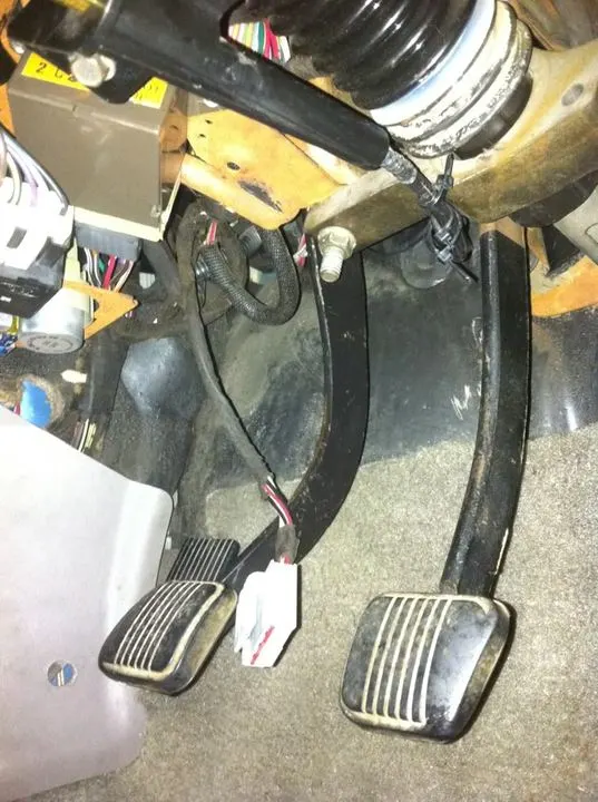

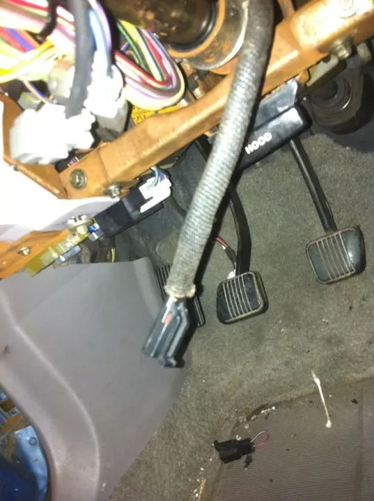

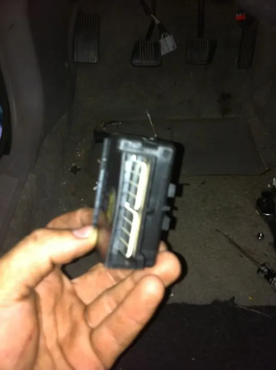

  20. Well I got the steering column bolted back up and clutch cable run. But I've run into a few issues. First being there are 2 plugs/harness I can not find where they plug into. And second being I can't find the location of this fan controller that Rock Auto sent me anywhere. Hopefully y'all can help me out
    The connectors. The first one comes out near the steering column and the second is near the brakes
