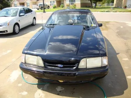

Ok, fine. It's definitely a work in progress, but I guess that's the point of these threads. The front of the car looks terrible, I know. I'm planning to replace those lights with either darker lensed lights or those euro looking lights that are similar looking to the ones on the new vettes with like 3 lights in one. The front fascia will eventually be replaced with the saleen one. It'll help to cover the intercooler without that ****ty looking cutting. I'm thinking about replacing the 2" cowl with a cervini heat extractor if it fits. If not, I'll repaint and straighten out the hood on there.

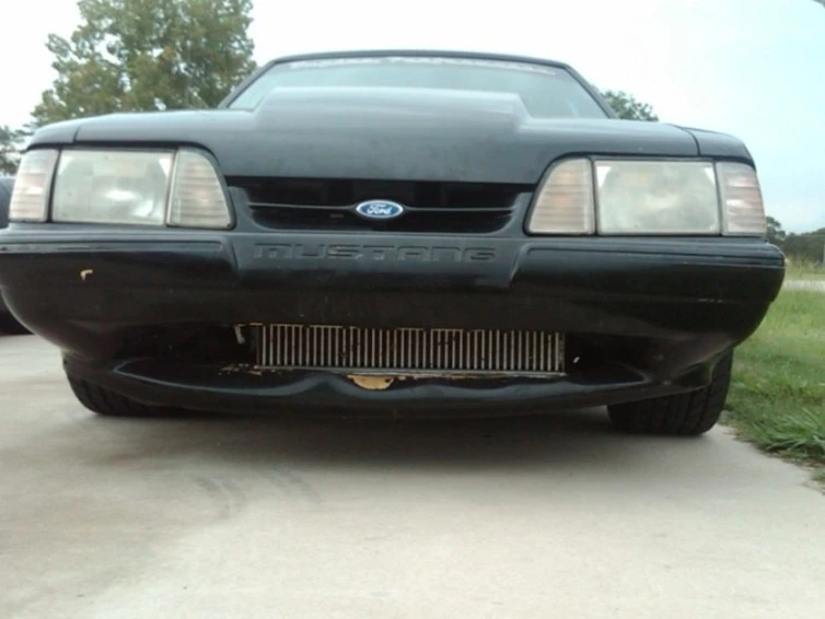

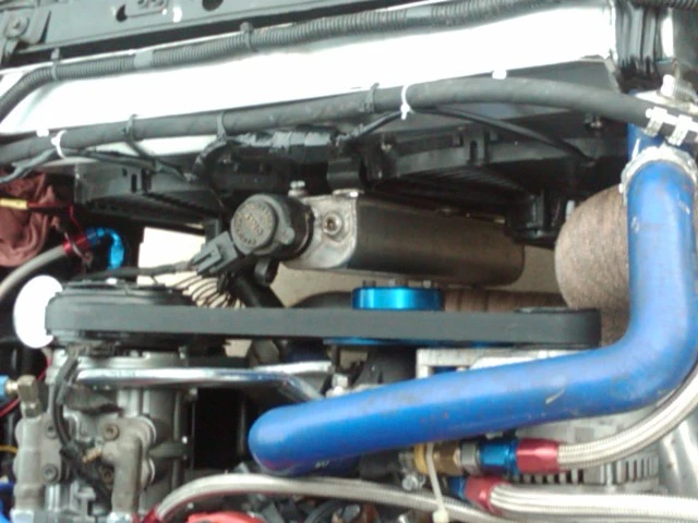

- I adjusted the front-mounted intercooler so that it actually looks straight, and I moved it forward cutting a little more out of the bottom front fascia to give it the room I needed. I replaced the condensor, compressor, hoses, accumulator, and lines. The old condenser was taking up the space the new radiator needed. So I pushed the intercooler forward with the condenser and that gave me enough room for the radiator, shroud, and fans. A mechanic nearby flushed the system and installed the lines. All it needs now is a charge and to hook up the electrical connections and the A/C will be fully functional. The mechanic used and heat-wrapped metal line from the condensor back to the firewall/evaporator since it ran right next to the exhaust tubing.

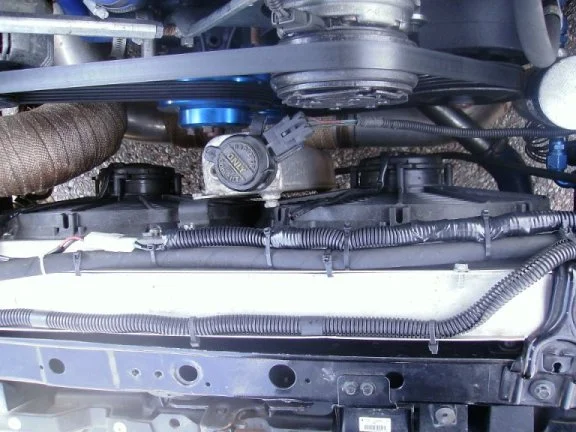

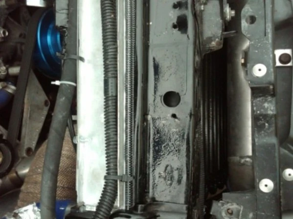

- The Ron Davis Radiator with this really trick-looking metal shroud, and twin spal electric fans is also installed. I heat-wrapped the exhaust side of the turbo so it wouldn't melt the passenger side fan. Plus it'll keep the A/C line a little cooler.
The attachments show the intercooler from the front. At least it's level and affixed on both ends, now. The other pic shows the stack from right to left: intercooler pipe (best I could get with the camera from above), the condenser, and the radiator from the front.
Quick picture of the radiator with the dual fan shroud setup. That's the best I could do with the overflow tank right now. I'll probably get a custom one and fit it into the battery tray since my battery's in the back, now.

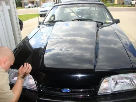

I'm in Afghanistan, again until December of this year. My bro back home is showing my car some TLC! Here's his work on the headlights... Even though I've done it several times on my mustangs, it still amazes me how much of a difference it makes!
Before (notice that the brackets are broken causing the lights to be misaligned):
standalone
After (all better!):
standalone

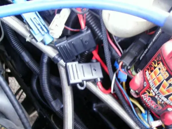

Dual fuses:

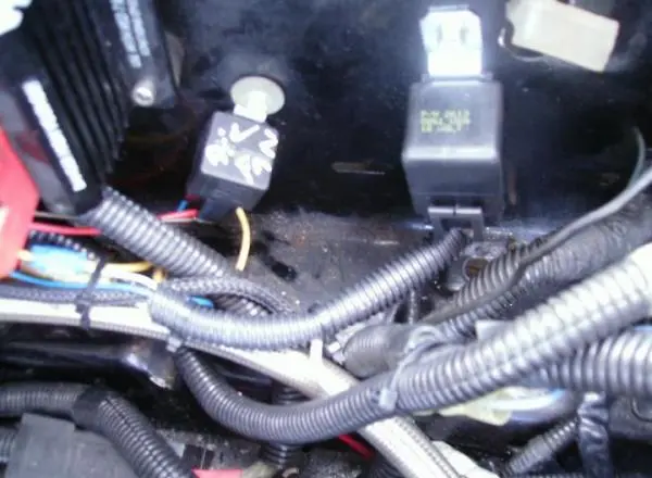

Here are the dual relays:
