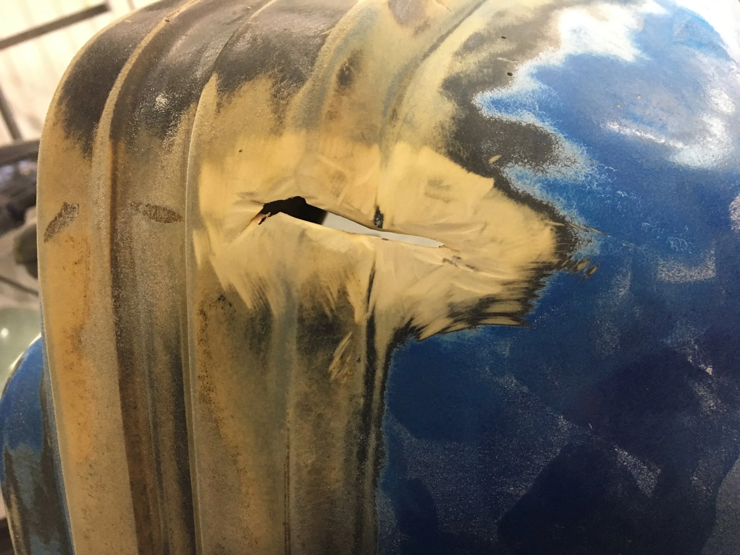

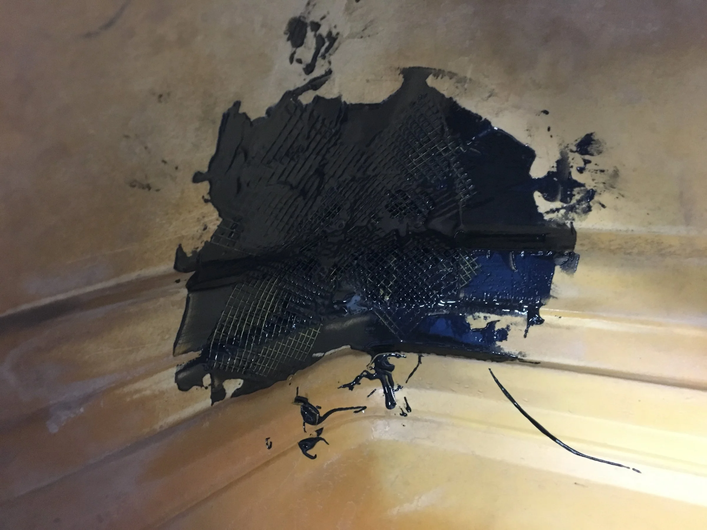

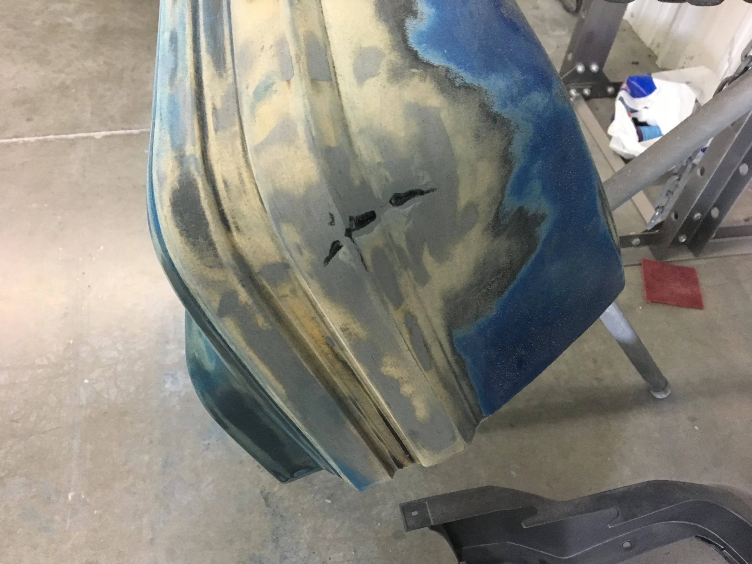

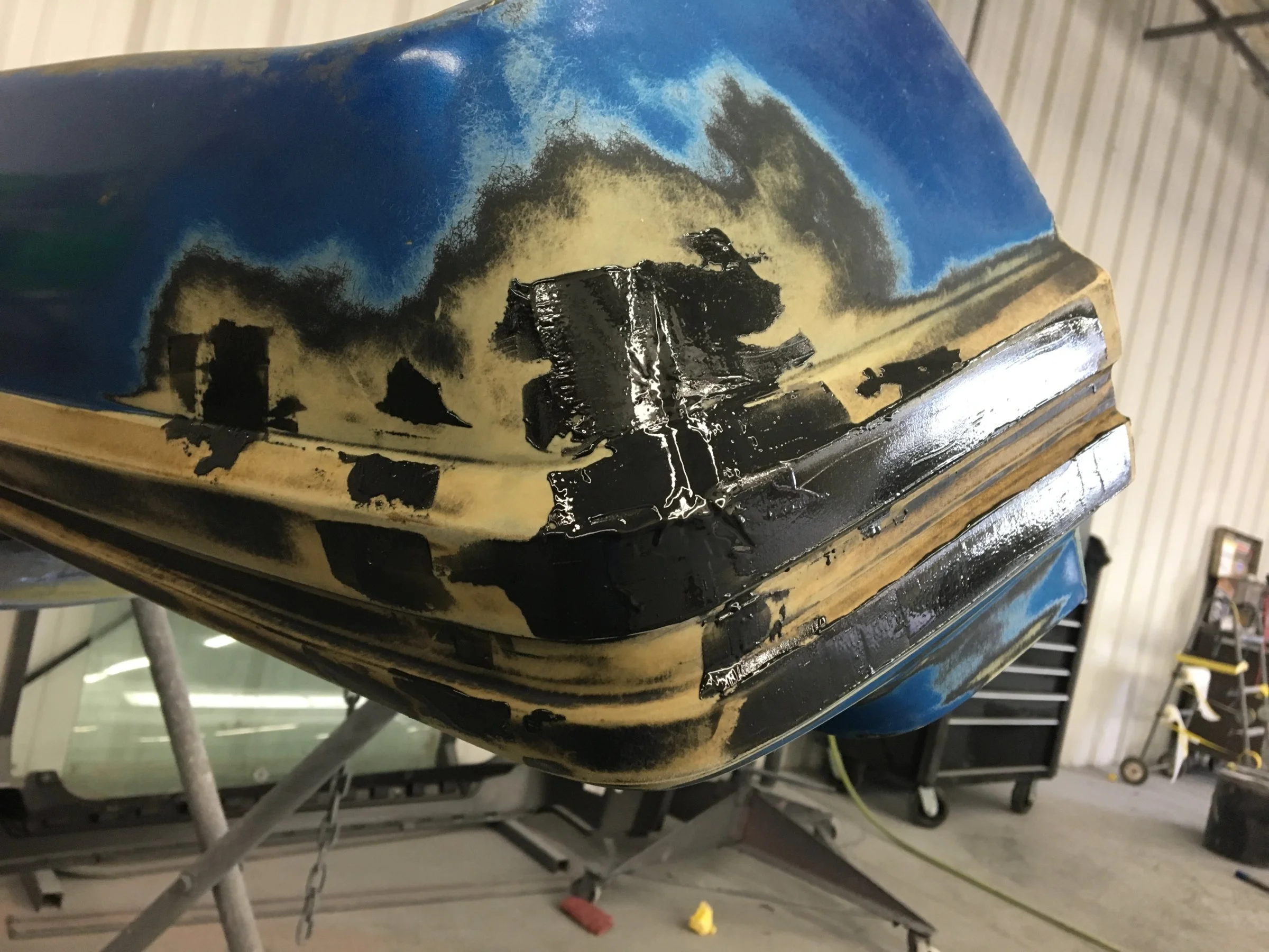

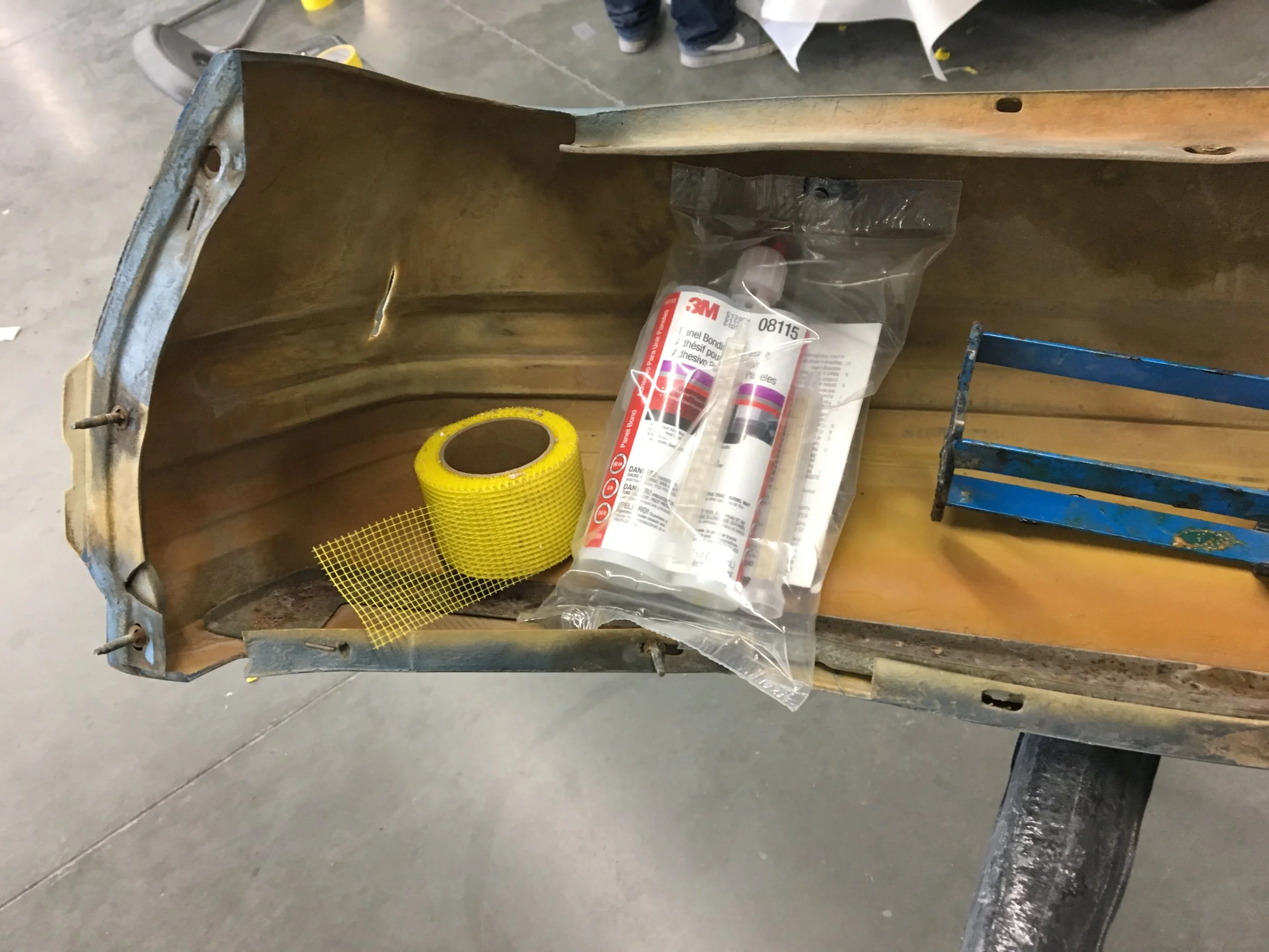

Here's a couple pictures of the tear repair on the left side of the bumper. I need to finish it out with a little polyflex on monday.
