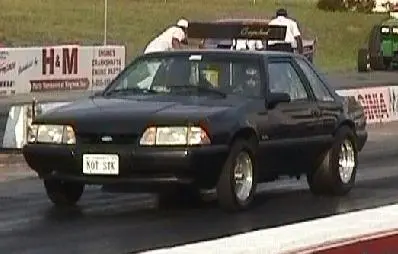

Next up is the record he kept on his own notchback foxbody. Of note, I pulled this from his site on 7MAR01, but I think it was pretty much the end of the saga for the car:
Options, Specs, and a Chronological list of Modifications (with ET)
I ordered my 1988 Mustang LX Coupe from Hill Ford in Champaigne, Ill. in May of 88. I took delivery in June. Delivered price was right at $12,500. I didn't take a car off the lot because I wanted very specific options. This cost me a little more (mainly because I couldn't get the $500 rebate that was offered at the time), but was well worth it in my opinion.
At the time, the 5.0 Mustang was THE CAR to buy if you wanted good performance at a low price. I have always tended towards acceleration vice handling. The best competition for the Mustang at this time was the Buick Turbo, although there were very few new ones to be found by the time I bought this car. Besides, they were over 17k new and I just couldn't afford one. I have no regrets!
Here are the options I ordered:
  • 225 HP 5.0 H.O. Engine
  • Power Windows and Locks
  • Premium Sound
  • Cruise Control
  • Intermittent Wipers
  • Rear Window Defroster
I ordered those options individually vice in a package because each available package contained something I did not want. Also, you might notice that I did not order A/C. That was intentional! I optioned the car this way in order to have a decent daily driver that was light and powerful.
Below is a chronological list of mods, and what the car ran with the addition/deletion of those mods...
- Pure Stock except M/T Indy Profile S/S G60-15's, Microburst Computer Module. July 88, Indy Raceway Park - 14.07 @ 99 mph.
- Off-road exhaust with mufflers disconnected, removed front sway bar. Great Lakes Dragaway (Union Grove Wi.), Sep 88 - 13.75 @ 100 mph.
- Underdrive pulleys, 160 deg Thermostat. Great Lakes Dragaway, Oct 88 - 13.54 @ 101 mph with a best ever on street tires 1.91 60 ft (still stands to this day for me!).
- 26x8 Goodyear slicks. Coles County Dragway (Charleston Il.), Nov 88 - 8.28 @ 83 mph. NOTE: I didn't ever get to a 1/4 mile track in this configuration, but an 8.28 should be in the high 13.1 or low 13.2 range.
- 3.73 gears, short-belt. Great Lakes Dragaway, Mar 89 - 12.99 @ 103 mph. NOTE: My first 12! I was estatic, and was able to back it up with a 13.000 on the next run.
- Bumped timing to 14 deg. Great Lakes Dragaway, Jul 89 - 12.93 @ 103.5 mph.
- Homemade Ram-air. Texas Motorplex (Ennis, Tx.), Sep 89 - 12.83 @ 103.5 mph. NOTE: Very good air this day. That ET would be my best until Aug of 1994.
- Air bag in passenger side spring, moved battery to the trunk. Great Lakes Dragaway, summer of 90 - ran a best ever to date 105.2 mph.
- Borrowed 65mm TB from Rick Anderson. Coles County Dragway, Nov 90 - 8.03 @ 84 mph. NOTE: That should equate to a low 12.7 or high 12.6 run. This was my last time at the track until 1994.
- Full-length 1 5/8ths headers, 65mm TB, Zoom Kevlar Clutch, Z-code (2.95 1st gear) T5, Hurst Shifter. Virginia Motorsports Park, Aug 94 - 12.70 @ 106 mph.
- No changes. Virginia Motorsports Park, Nov 94 - Back-to-back 12.52 @ 106.9 mph, 1.67 60 ft. (7.93 @ 85 mph 1/8th) *****This stood as my all time best until Nov 97*****

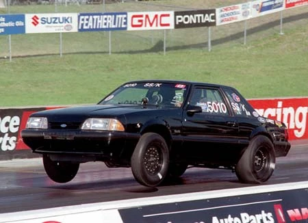

- SSM Lift bars, subframe connectors, manual steering rack, FMS Heavy Duty clutch. Old Bridge Township Raceway Park, Englishtown, NJ, Sep 96 - 12.70 @ 108.1 mph. NOTE: I went back to an FMS clutch because I didn't like the Zoom Kevlar on the street.
- No changes. Virginia Motosports Park, Oct 96 - 12.68 @ 108.32 mph. This was my best ever mph until Nov 97.
