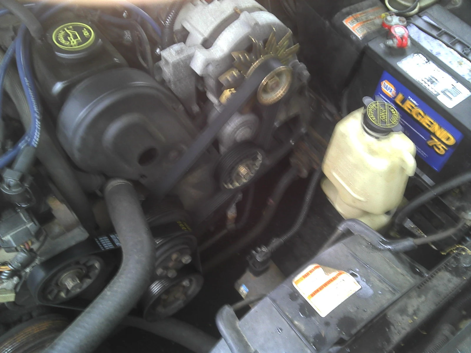

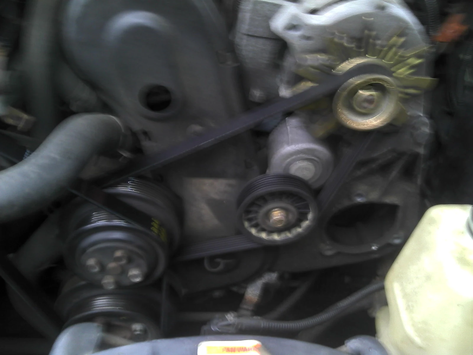

When I deleted my p.s., I had that issue with the belt drive also. I'm assuming you have the dual serpentine belt drive. I got a new idler pulley that matched the one for the a/c compressor drive belt, put it on the tensioner by the alternator, and got a smaller belt (25 inch) that just runs from the waterpump, to the alternator, and around the tensioner, with the tensioner on the inside of the belt. Sorry my pictures are kinda fuzzy.
