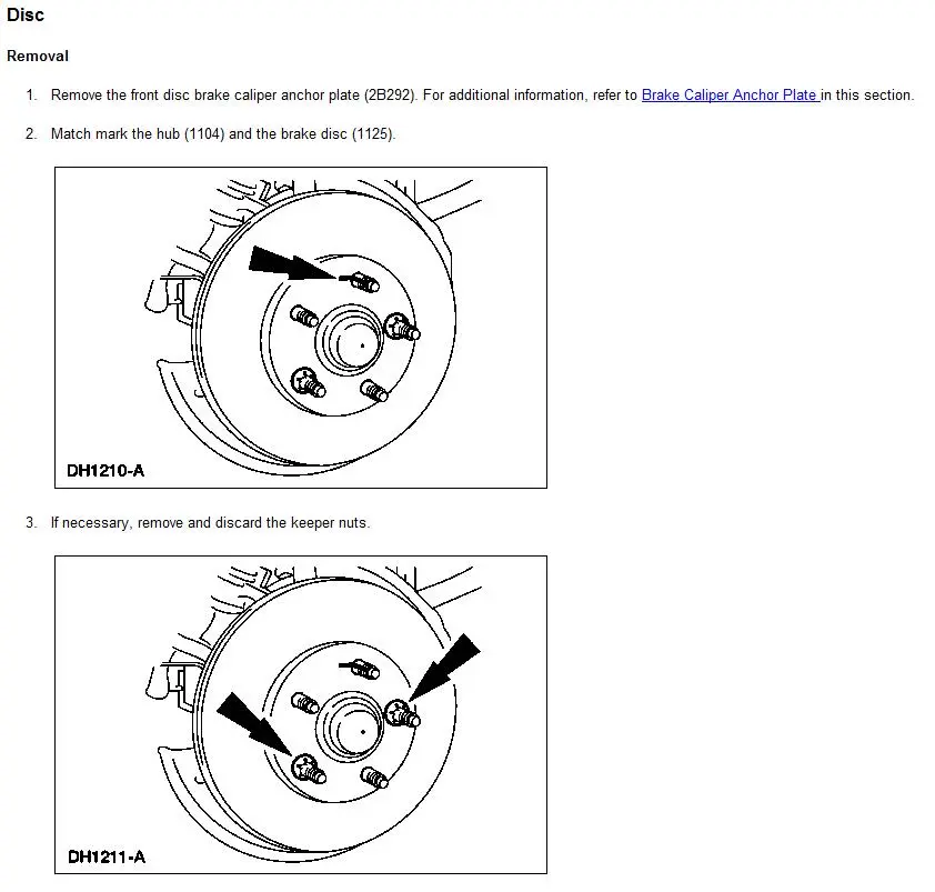

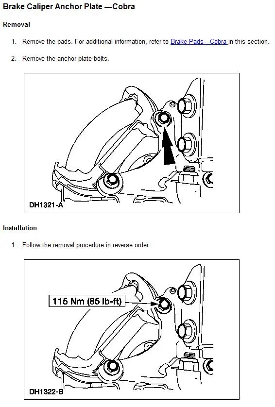

Well if you've already removed the calipers and pads the next thing to remove are the anchor plate bolts (see attachment 1). Then remove the keepers (see attachment 2). The disc should come off. You may need to spray some penetrating oil in and around the studs and let it sit. Some gentle tapping with a rubber mallet will also help.

ok i am talking about the front rotors. the rear have 2 bolts that hold on the caliper then 2 bolts that hold on the bracket the pop the clips and the rotor came right off. the front only have 2 bolts that hold the caliper and bracket on that is off and the clips are off and the front isnt budging any thoughts????
