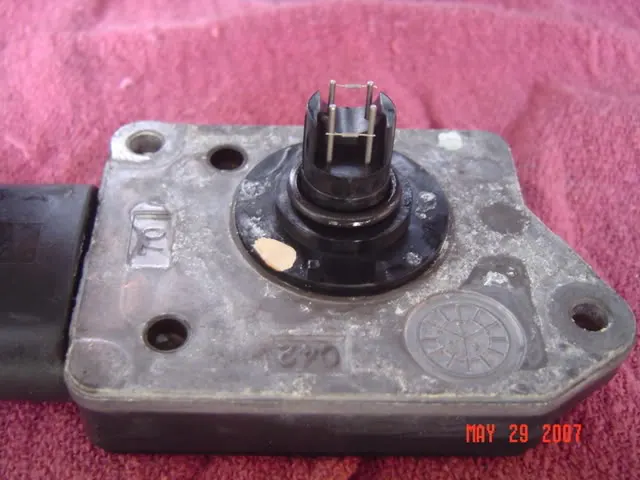

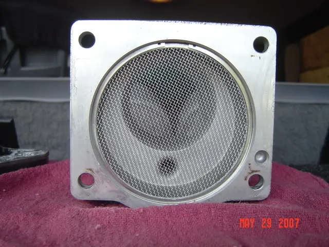

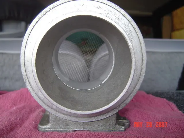

    I just recently cleaned my maf sensor due to code 72, probably oil from the K&N got on it, but they won't admit to that :rlaugh:
