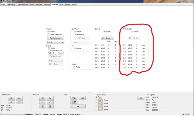

    I would also recommend the rotary switch. It's nice to be able to switch tunes on the fly.
    http://www.moates.net/product_info.php?cPath=31&products_id=204
    And, as posted above, you don't have to disable your EGR to datalog a LC1.
    [IMG]
    BE has native support for the LC1. From the BE help file..
    Oh, and last but not least, if you have a 64 bit operating system, it's a little more work to get the drivers installed and working properly. If you are, let me know, and I'll walk you through what needs to be done.
