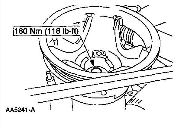

  6. cjones Founding Member
    Member Since:
    Jul 20, 2002
    Message Count:
    1,557
    Likes Received:
    Trophy Points:
    36
    Location:
    Avondale, AZ
    it would be best to get an underdrive pulley set for a 99 3.8L. the 98 has the same setup as a 97 according to my program.
    on the 99 it's one piece. the 3 holes are to mount the puller to remove the pulley/balancer.
    here's an image of the 1999 balancer/pulley...
