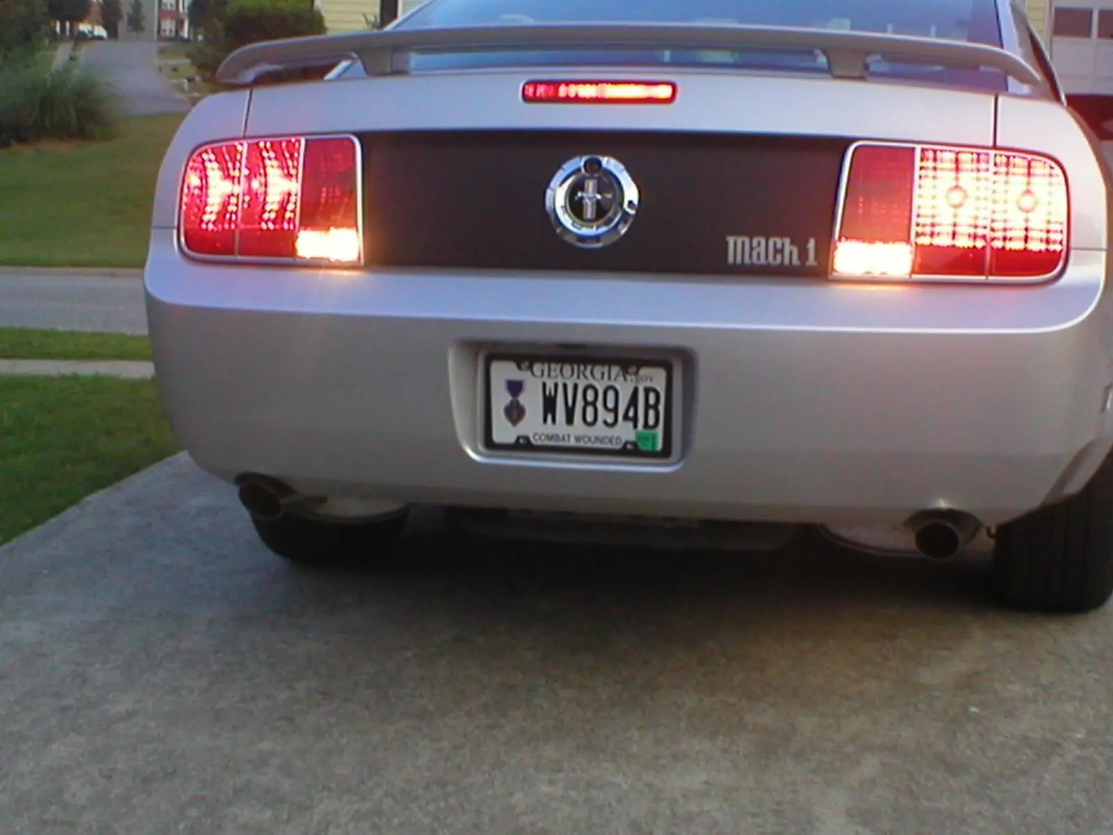

Here is what I did and I have done 3 of these bumpers so far:
1 - Cut out the passenger side opening so it does not have the recessed material and both sides will match. I tape over the entire opening and then draw a line JUST on the outside of the opening that is already there. I score the line with a snap knife available at any Hardware store. Then, I extend the snap knife blade out far enough to cut through the bumper. Once you start, and can get a little pressure on the piece that you are removing, you will get the feel for it. The snap knife really leaves a CLEAN edge!
2 - Tape the drivers side of the bumper...measure 3 times...then hold the pc that you cut out of the passenger side backwards against the bumper and trace the shape onto the tape. This will give you a cut that is very similar to the other side. Then use the snap knife again and...viola...dual exhaust holes.
3 - To finish it off and give that factory appearance...get some black door edge moulding from your auto parts store and carefully slide it onto the cut bumper. It makes it look like it came that way and the adhesive in the door edge moulding ensures that it will stay attached for a long time.
I have attached a pic of my FIL's 05 "Mach 1" with GT Take Off Duals
This was before the door edge moulding but still a clean job.

My biggest concern during installation was that after cutting loose the stock exhaust, I noticed that the distance between the x-pipe inlet tubes was about 1/2" narrower than the stock pipes behind the cats. And you can't just bend that stainless x-pipe by hand to make it fit! So, by using an innovative combination of a three ton hydraulic floor jack, some wood blocking, and David and I looking like we were playing a game of Twister; we got the pipes spread enough to go on. I used the Dremel with a rotary bit and cut the bumper using the Pypes template. I didn't realize how much the rotary bit was going to jump around while cutting, so I cut well inside of the template outline. I then put a sanding drum bit in the dremel and slowly worked it out to the template line. It turned out alright and when the car is on the ground, you can't tell any difference from the passenger side outlet. I plan to get a GT bumper some day, so this will do for now.
