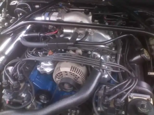

    i have no egr, i took it off when i did my engine build, and erased it in the tune, it cleans up the engine bay too
    [IMG]
