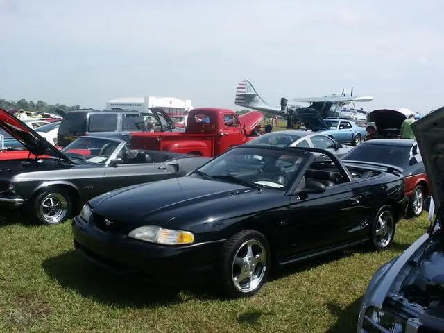

    She did...I got this and saved most of the insurance money.

    Hey '66 coupe's that's great, nice looking vert.
