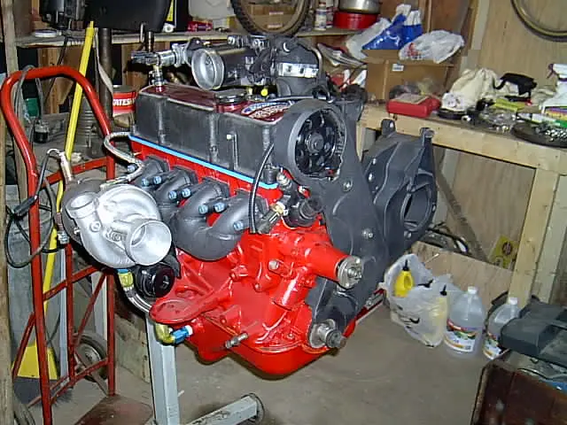

    Well, I lost my job on Monday (apparently I'm uninsurable due to two speeding tickets, and I drove cars all day for my job, so they had to let me go), so now I have tons of free time, even with still being in school. I've done more to the new motor in the last two days than in the previous six weeks. There are some new pics up on page 2 of my Cardomain (link in sig), and I also added a page covering my SN95 brake upgrade. This is what the motor looks like at this very moment:
    [IMG]
    Leave me some feedback on the page if you get a chance, nobody ever seems to. :p

    Looks good, Did you shiney up the Alum? or did you paint it? Also i see the stock turbocoupe oil sender, My car reads low oil pressure with my new motor, and i am told its due to the TC sender being different. Dont know if its true or not. But you might consider putting the mustang sender on. Did you throw in the roller cam?

    I painted most of the aluminum parts with wheel paint. I figure it should hold up to the light heat that those parts will see, and should be fairly durable. I did put the roller cam in that I had lying around, so that should help at least a little bit. Thanks for the heads-up on the oil sender - obviously I can't use the Mustang one right now, but I'll keep it in mind if I have a low pressure issue. :nice:

    looking good. If you plan on not running a cam cover , you will want to panint your pulleys :)

    Ash, what is your motor sitting next to? Pre 87 eh?

    I painted the pulleys, but apparently not very well. I may have to go back with a brush and do 'em in the hard-to-get-to places. Besides, I am running a cam cover - it's polished and powdercoated. ;)
    The motor is sitting next to my buddy's '86 LX. The car is actually for sale right now, minus drivetrain. '86 LX hatch, original 5.0 5spd car...I think he wants $500 for it as a rolling chassis.

    its true. if this is going in a mustang with a mustang harness and oil pressure sensor plug from a mustang you will get a very, very low pressure reading with the thunderbird pressure sending unit in. use a n/a mustang from your specific year mustang and that will be gone.
