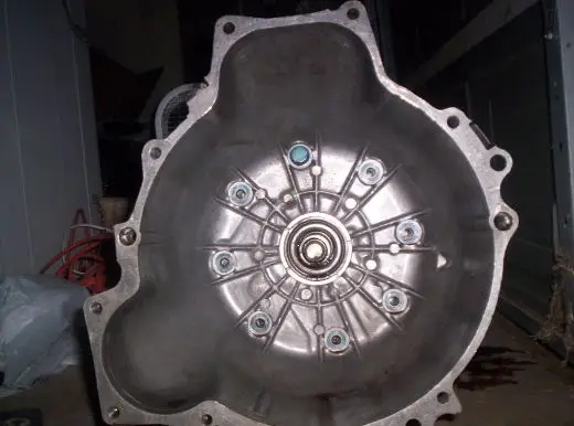

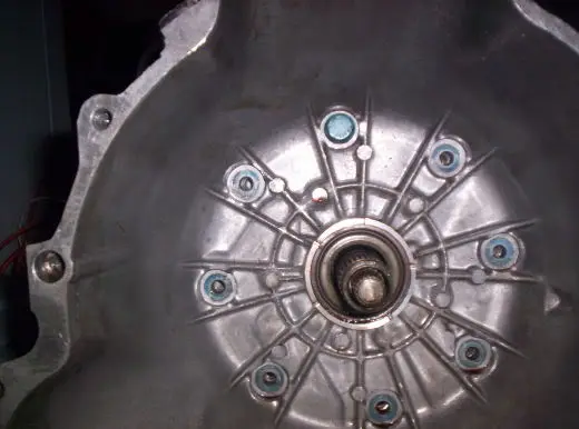

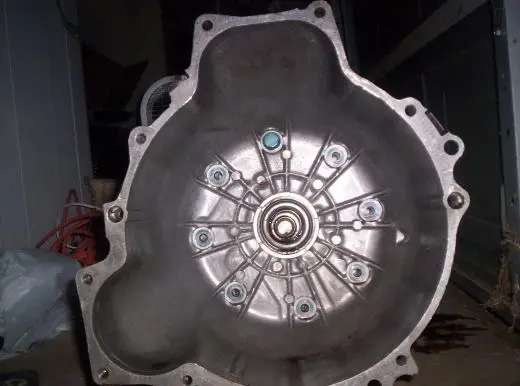

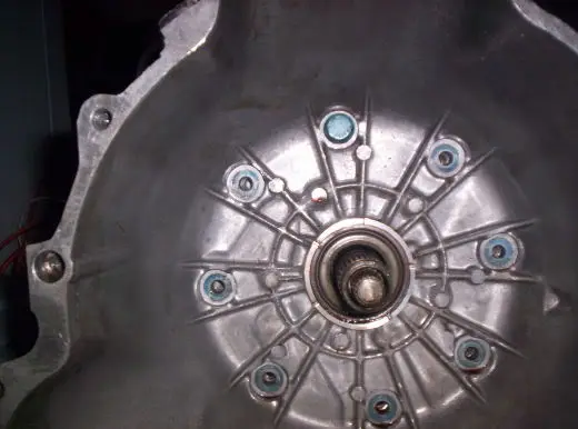

I pulled the tranny today to change the pump seal and when I got the tranny down I'm pretty sure they gave me the wrong seal but any way do I need to remove the bell housing to replace it
I pulled the bell housing and that was a mistake but got it back together okay. here is a pic of the front of the tranny and I assume the pump seal is the one around the shaft.
help is desperately needed cause I have to finish this tomorrow
thanks

Out is easy!
Fast way is to put a screwdriver on the outside lip and give it a whack. This will bend it up so you can grab it with pliers or get something under the lip to pry it out!
I have an old screwdriver that I heated and bent the last 1/4ths inch on.
Amazingly useful tool!
