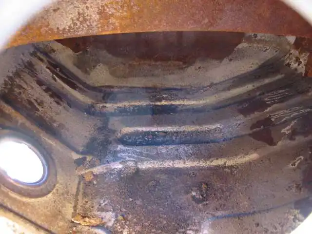

I finally got some pictures ready to post. The first 2 pics are the tank during cleaning. I used Eastwood's 4 or 5 step method, and their supplies. Basically Pic 1 is after a thorough cleaning with water, detergent, and degreaser. Pic 2 is after cleaning with their Eastwood's caustic wash, acetone, dilute muriatic acid, and their rust remover. If you look close in Pic 2, you will see dots where I didn't get all the way to the tank metal. These show up again in Pic 3 after the liner is in...

The coating is nice and hard, but I couldn't get it to coat evenly. Mainly the tank got too hot outside, but I would have died from the fumes (acetone) inside. So the liner dried too fast to get a smooth coat. But worse than teh uneven coat was the "pimples" in the liner where some dots of corrosion were remaining on the steel. I decided that I needed to try again...
Not pictured is the tank after attempt #2. I was able to dissolve the first liner with acetone, and purchased new materials from Eastwood (they love me). Unfortunatley I didn't do any better on the evenness of the coating. But at least I had the tank clean enough to eliminate the "pimples".
