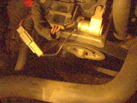

    I have a 91 2.3 Mustang.
    I get codes 223 and 224.
    sometimes the check engine light comes On and the tach only reads out half of the RPMs.
    The previous owner told me he had a new coil pack installed. (The Front One)
    because the car was sputtering. it doesn't sputter, but bogs a little when i hit the gas lightly. i
    also theres a wire thats hanging in front of the Front coil pack.
    thanks before hand

    here a pic

    I replaced the ignition module, still have the same problem.
