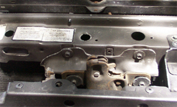

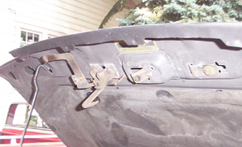

    I never thought I'd have this problem but it began yesterday. The same day some debris gauged my door on I-94 and the same day my charging system went kaput. The damn hood won't latch!
    Had this problem on my last 5.0 but it was actually that chunk of metal in the hood catch that eventually commited suicide and broke out after years of hood closing. This time it's not as obvious to me. The large springed hook mechanism-watcha-call-it catches but the actual hood locking mechanism doesn't. I took some pictures I thought might help.
    Nothing seems to be blocking the path of the hood, nothing I've seen has looked out of place and everything seems to be operating correctly. But I have noticed since I owned the car it's become more and more of a pain in the ass to pull the hood release and culminating in my having to pound the front of the hood the other day just to get it to release so I could pull the lever.

    wait a min, when you put the hood down does it sit all the way down? cause from the pics it looks like the latch is already in the closed position.

    It sits about an inch too high and bounces around. I can even lean on the front of the hood so it's in a closed position, but get up and it springs back. :drool: (these smileys are great)

    If by hood latch you mean the spring loaded 'S' looking thing enclosed in the assembly pictured in hood1.gif, then that isn't catching on anything. The hood is bouncing around on the springboard and the lip around that isn't catching on the latch. There aren't any signs of the latches moving out of place.

    man, can you guys really not tell? on the first picture, you can see that the locking arm is locked down already....my friends explorer was like that too. Just pop the hood and then go into your car and pull the hood popper. It should unlock the hook and let you close your hood again.

    Got it. There's a little tiny nub of a mechanism hanging off to the driver side halfway down the lock mechanism. I need to push down on that with a screwdriver before closing the hood. I guess the hood release is shot or at least needs some grease. Thanks guy!
