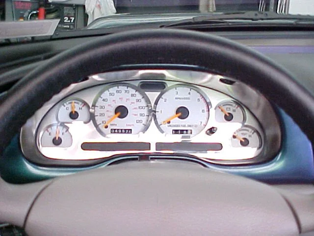

Heres a pic of my MAC white faced gauges and 35th aniversary bezel on my 95...
i couldnt get a pic of it at nite, my bro has the camera somewhere...
otherwise i plan on taking some LEDs or something and lighting this baby up in blue!
