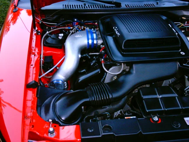

    I went with the C&L intake setup for reasons other than the performance gains of the intake alone. It's a good, solid intake, and when used in conjunction with their 85mm MAF and Mach 1 air box, performs great with no stalling or surging issues.

    That kit looks really nice. Hows the nitrous in these cars? I Had nitrous in my camaro ss and that car just loved the juice.

    I'm looking at teh C&L myslef, why would we really need a 85mm MAF? What size is the stock TB?
    Also wouldnt you need a retune for the MAF to work right?

    The C&L system doesn't use a new MAF per se, it uses a 85mm MAF housing with the stock sensors. A tune is almost a guaranteed requirement, as the C&L tends to significantly lean out the A/F ratio.

    He's right, it's kind of a misnomer to say MAF, when it's actually the stock MAF electronics in a 85mm MAF housing. I never had the leaning out issue with the C&L unit, even with nitrous. It was so on the money, I went back to the stock tune while running a 100 shot of nitrous!
