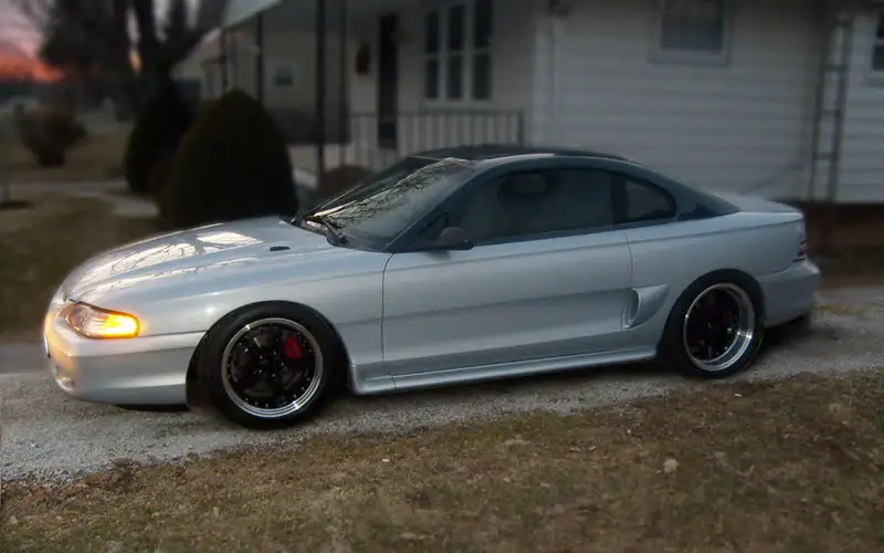

    i would say it depends on what you want to spend
    if your gonna just do springs/shocks+struts i would go with H&R and bilstein
    Maximum Motorsports makes some really nice C/C plates (dont cheap out with knock offs or 3 bolt designs, the MM 4 bolt ones aren't all that much more and its a product you know will handle the abuse)
    For ~1500 i think stangsuspension.com sells the full maximum motorsports front and real coil over kit that comes with everything needed. benefit of coilovers is the adjustable ride height as well as better front suspension geometry.

    as far as steering... on my 02 im running 275's up front and its on eibach springs (car isnt slammed but its not 4x4 either) and steering hasn't changed much from 245's, its really not noticeable unless the road is pretty grooved.
    I drove my friends new EVO MR the other night (badass car BTW) and his car with 235's seemed to track the roads worse then my stangs... but it could be the way the evo suspension is setup.
    ride quality.... did our cars ever have that? spring rate is probably what would make a big difference here, stiffer springs, stiffer ride. same goes with shocks+struts, but with those you can get some adjustable ones and soften them up for day to day driving and then dial em up for track use
