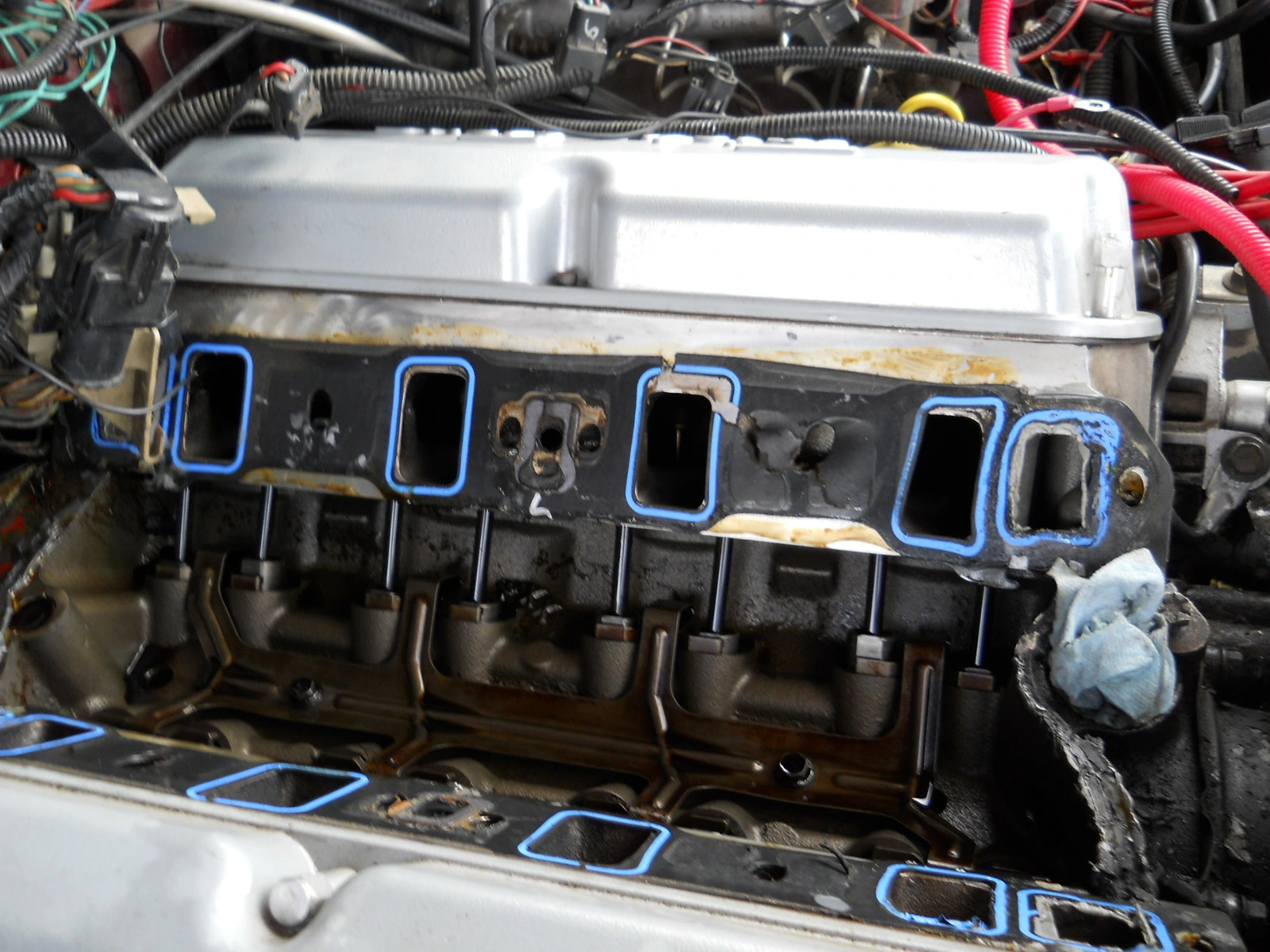

    when i took my intake off there was no gaskets on the front or back just tons of rtv is there a part number for some i can pick up i have a holly systemax intake
    thats the gasket in reffering to....
    thanks

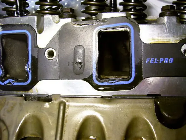

    Mine litterly melted and tore 008 (2).JPG 008 (2).JPG 008 (2).JPG I have the pictures to prove it

    ...those look like they were overtorqued...and installed wet?? What is that brown crap? Gasket shellac?
  11. larrym1961 Member
    Member Since:
    Dec 18, 2010
    Message Count:
    241
    Likes Received:
    Trophy Points:
    Location:
    Post Falls Id.
    Yes they were overtourqed from 8 to16 to 23ft. lbs! it's not the first Intake job I have ever done! And the brown stuff is Edelbrock Gasgacinch. The first set of gaskets were installed by a professional Mechanic And they failed the same way as the ones in the picture like the ones I installed as you see in the picture.

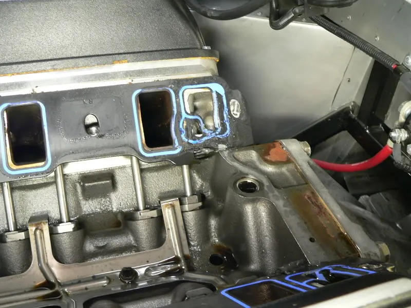

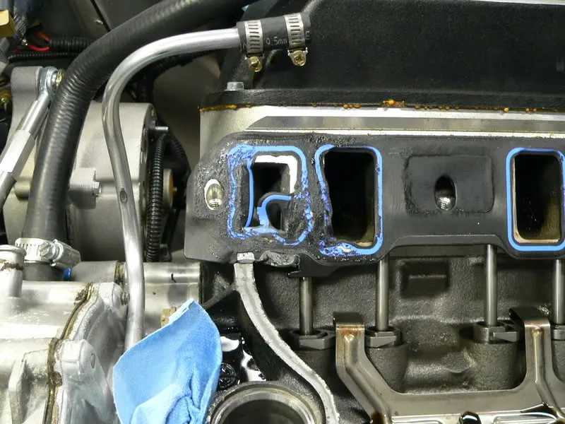

    Yeah mine were torqued to a whopping 19lb-ft in the proper sequence and they REALLY went to hell on me. It's no secret these gaskets fail, I have a nice collection of pictures.
    [IMG][IMG][IMG][IMG][IMG][IMG][IMG][IMG]

    Man, I'm sorry to hear/see all this...I've used FP1250s over 15 years and at least a dozen engines and have NEVER seen that...

    I was told these are vynil gaskets and that is the reason why they melt then tear. How I discovered mine were bad, I was smelling coolant while my engine was running and I was seeing coolant puddling up on top of my timing chain cover because it was leaking from the lower intake gasket. I removed the intake and that is the mess I found twice.
