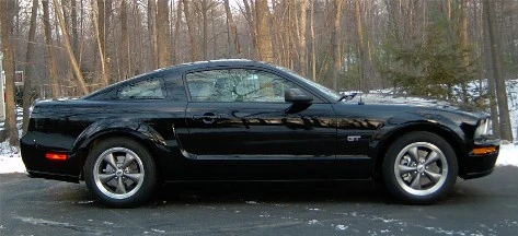

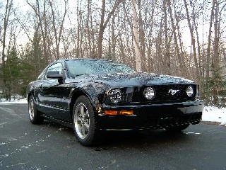

With the ProKit do the rear coils first; the axle will go right (pass side) about 5/8". BMR has top quality adjustable panhard bar. Entire job on the rear is pretty easy and can be completed in under 2 hours (and that includes making fine adjustments and road testing.) I will say this after doing the rear, the stance of the car is perfect and the spacing between tire and wheelwell on all fours is about the same. I wouldn't want the front any lower. I feel this looks perfect and I don't want to compromise ride quality in the front suspension any; also I like knowing I don't have front ground clearance issues, especially a concern if a aftermarket front fascia is intended. ...hey just my opinion; I'm not going for the low slung road racing look. ...more the retro and straight line look. (attached pic)
