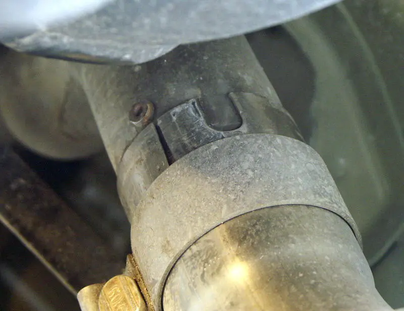

I have ordered the Magnaflow AxleBack kit myself but it hasn't arrived - should be here tomorrow. My vehicle is not scheduled to be built until the week of 1/10/05. I will most likely have the same problem. Others have simply added an additional notch in the inlet pipe for the existing alignment pin to fit properly - see attached image. Is this the same problem you encountered? The CatBack kit doesn't seem to have this problem due to the (2) pipes from the muffler forward being included in the CatBack kit. Problem seems limited to the AxleBack kit.

Actually the problem was on the passenger side. Both sides however did not come close to the alignment pin. It was an easy fix to add a notch to line up with the pin. The passenger side sets up higher and to the right so the tip is not centered in the bumper opening. This will be fixed today at the exhaust shop. The exhaust is a quality product that just needs tweaking to match what Ford is doing
Here's a follow up. Just got back from the shop and the passenger side muffler was an easy fix. After making a new notch for the alignment pin a slight rotation of the exhaust pipe just prior to the muffler lined it all up. The driver side muffler is another problem. To get it close to the proper alignment requires not inserting the pipe fully into the muffler pipe. In fact it just barely makes the connection. I will be contacting the man mentioned earlier in this thread for an explanation and hopefully a proper fix for the problem. As said earlier it is a lot of money not to fit right. More to follow
