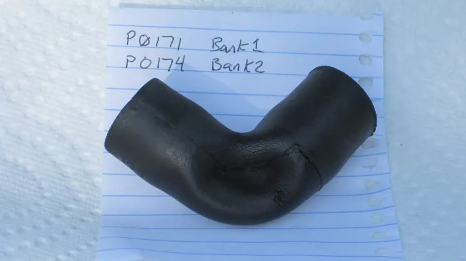

RPMs seem to hang at initial start-up and when coming to a complete stop. They eventually drop to normal idle RPMs and there is no stumble or rough idle. I think it may be a sticking valve, because fuel consumption has not increased and power levels seem fine.
everything air related between the TB and exhaust manifold is original 2003 stock.
I've listened for vac leaks, and can't seem to hear any.
Any other suggestions before I take the IAC off for cleaning/replacement?? Is there a how-to write up somewhere??

(you will see why this is funny in a moment) it appears that I do indeed have a vacuum leak.
