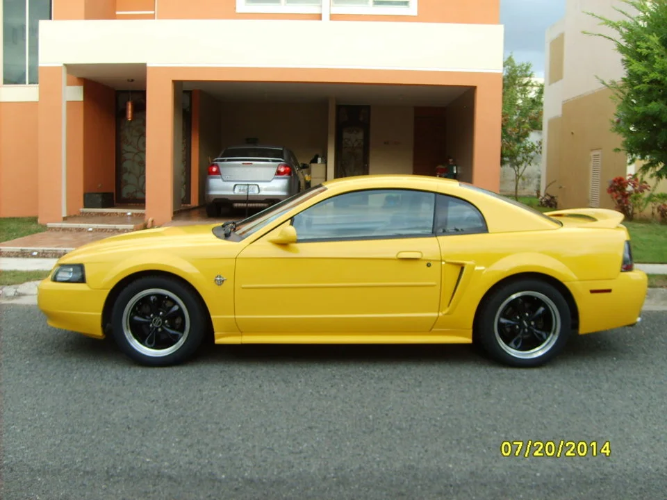

    When I bought this car back in June, and even though it has only 58k miles on the clock, this car did have repairs that needed to be attended to. The first thing on the to do list was take care of the suspension whoas and stance. As you can see from this pic, the car's front suspension was sitting on rails. The previous owner had bought lowering springs and then cut 2 coils out of each spring which caused havoc on the camber and bump stops. Not to mention distroying the inner fender well skirts. And ride performance was spine jolting. He fit the car with 20x8's with 265/45's all around. Not enough sidewall for my liking.
    So I went online to American Muscle and bought new SR lowering springs, and new staggered AM 17x10.5 and 17x9 black 5 spokes, with 315x35 in the rear and 275x40 up front. I further found that the lower balljoints were trashed along with the tierod ends and swaybar bushings. So I ended up replacing the bushings, tierod ends and balljoints and installing new SR caster/camber plates for proper alignment.

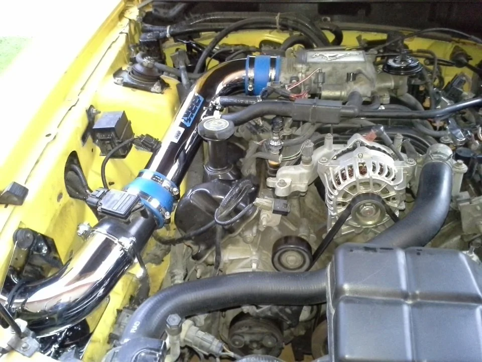

  2. Then after I got the ride height right and waiting on my caster/camber plates to come in so to get the alignment issues resolved, I started with taking care of the intake and installed a BBK CAI system.

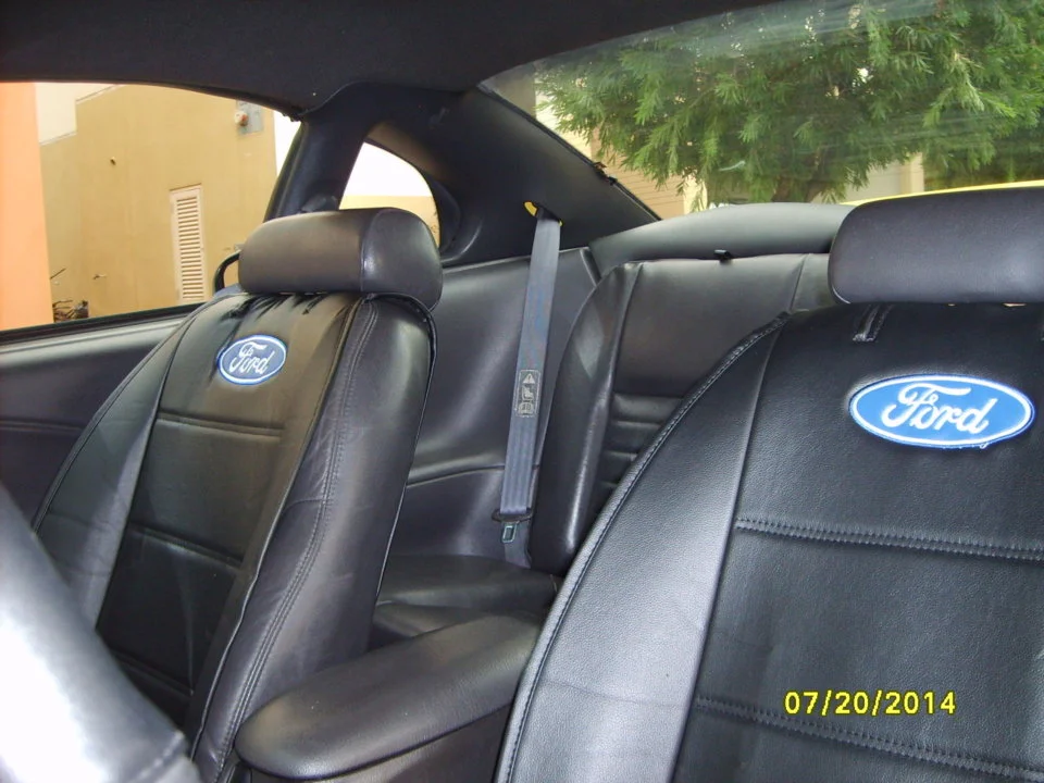

  3. After that, I got the plates installed and took it down to the alignment shop and got it riding straight again. I installed some Ford logo goodies on the inside, floor mats, seat covers to protect the nice seats, wheel cover and foot pedals.

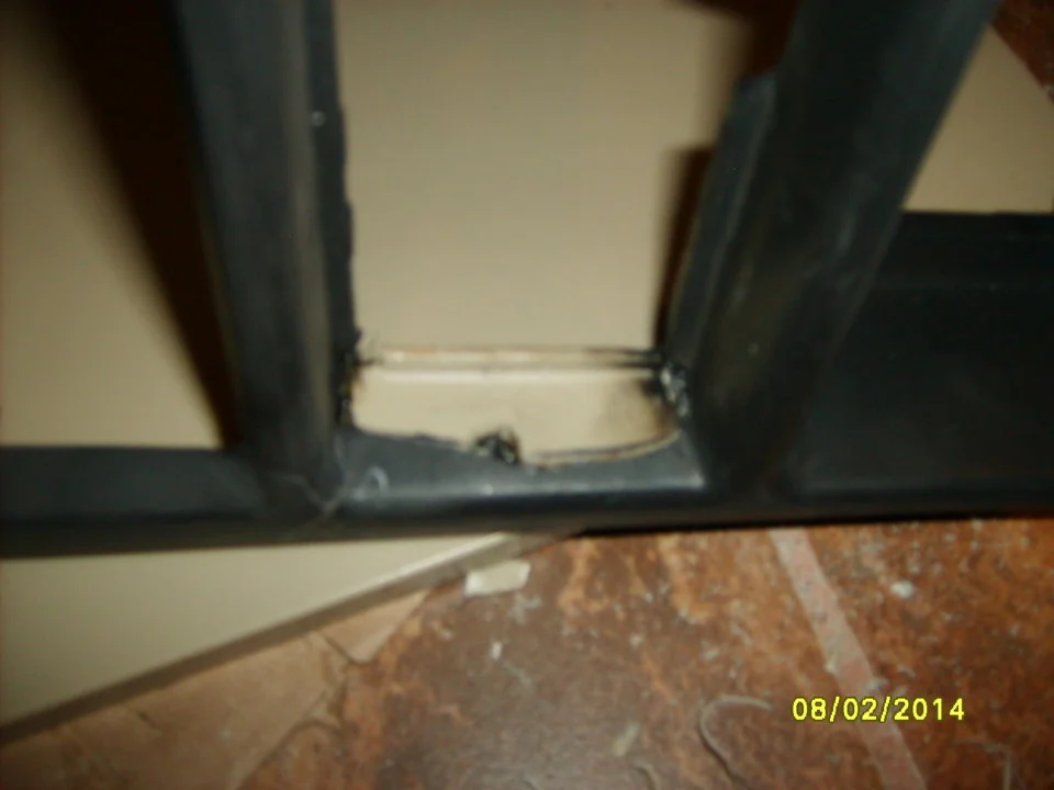

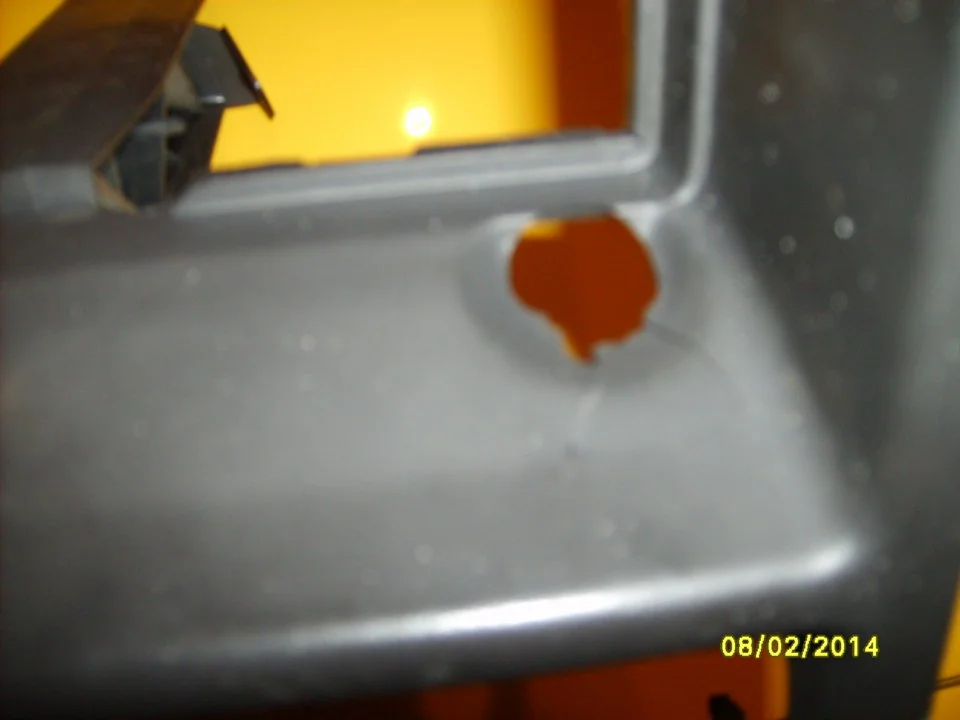

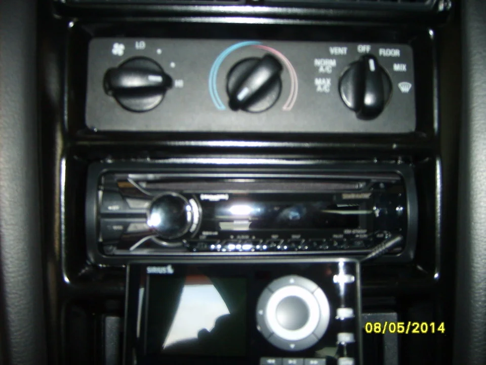

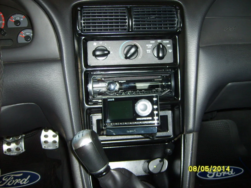

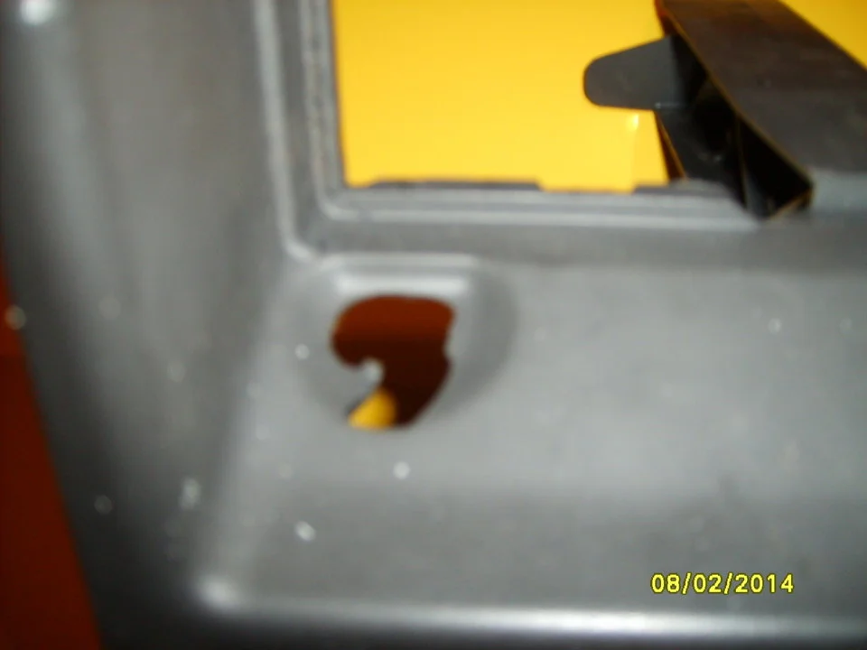

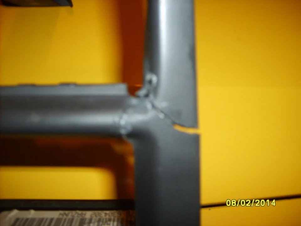

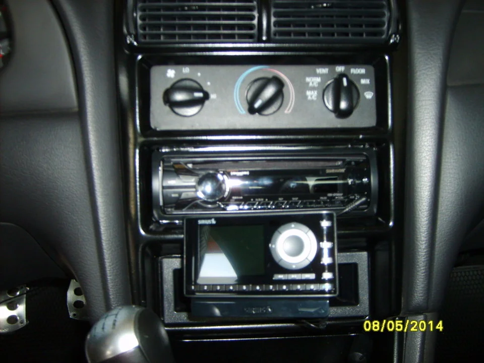

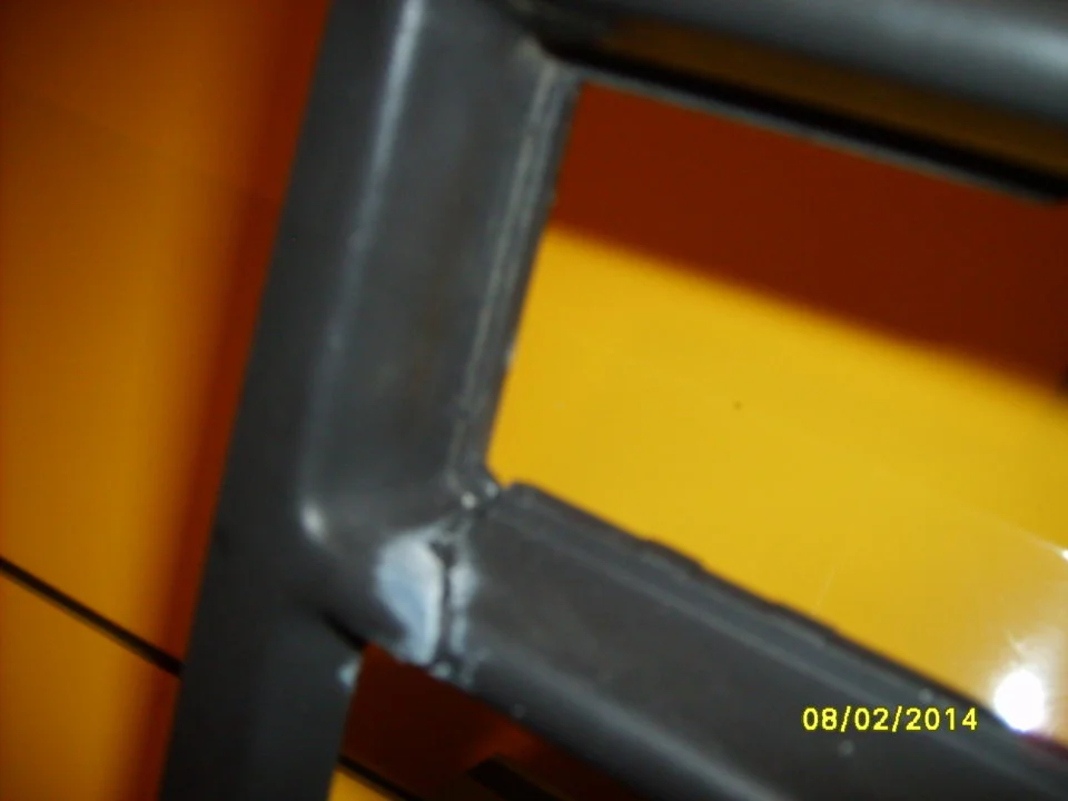

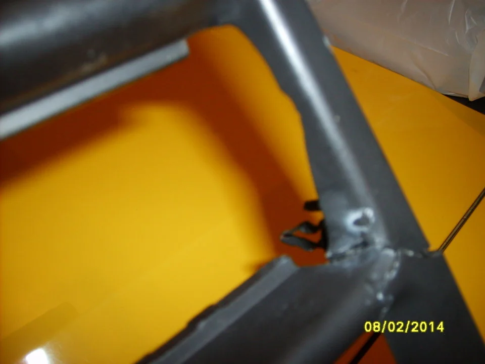

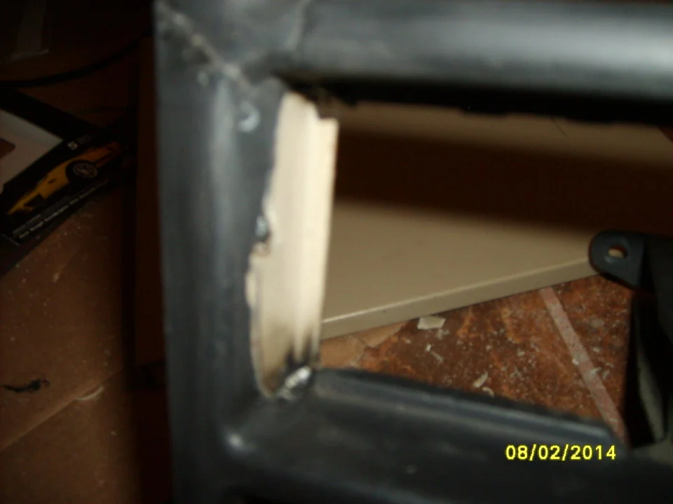

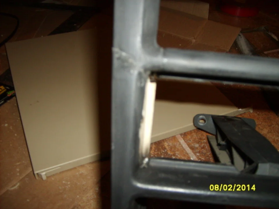

  4. Then I put my attention to the radio / A/C bezel that was all broken after the previous owner installed a sound system in it. Once I repaired it, I installed my own head unit and satelite radio. The bezel was pretty much trashed as it has both horizontal seperater bars broken at each end, and the crown edge on the left side of the stereo was missing. So I had to create a new piece of plastic to fit in the crown of the bezel where it wraps around the radio and also plasti-weld the cross bars back into place. Once I got the plastic piece to fit around the radio on the left side, I had to plasti-weld it in and fill and sand multiple times until the desired look of original was created.
  5. Here is the bezel during shaping and plasti-welding adn filler and sanding to original shape.

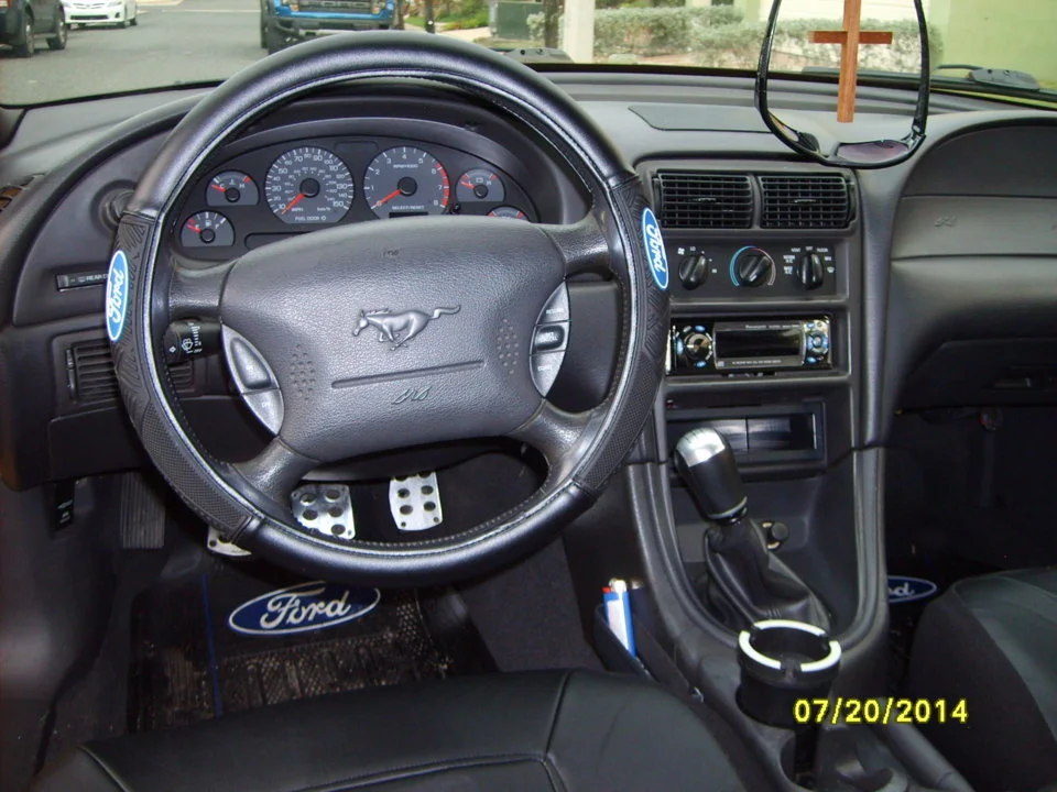

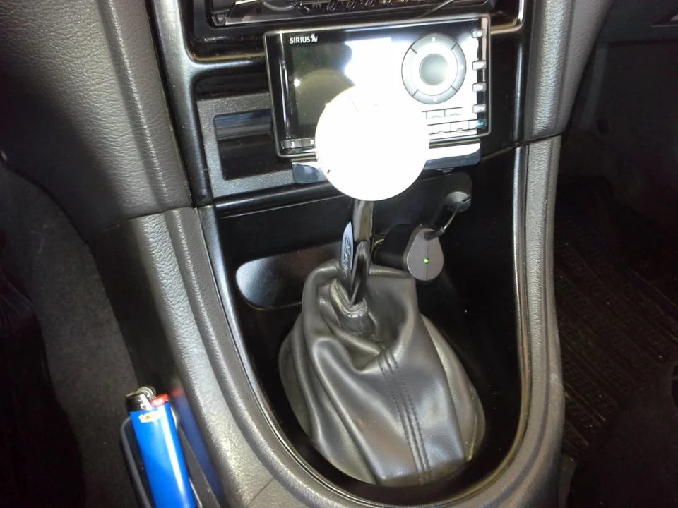

    In that last pic you can see I installed a 2006 shifter knob that came out of my 06 Chip Foose Stang that I sold a couple years ago. Fit nice like original and I was able to get rid of the one that the PO had on there that was a 3 piece Euro POS.

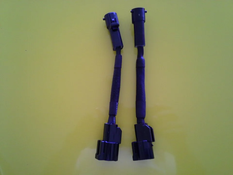

  7. Now my next issue on the list to do is installing the MIL Eliminators from American Muscle. They should be in in the next feew days. Then after those are installed, I still have to work out the CEL PO455 code.

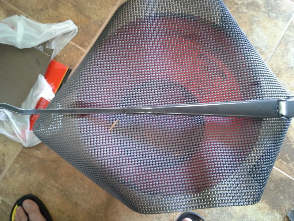

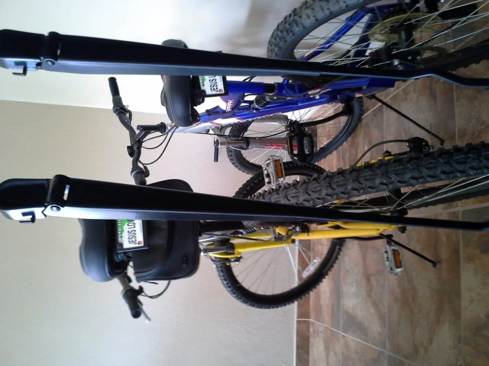

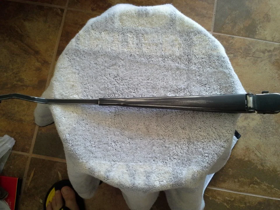

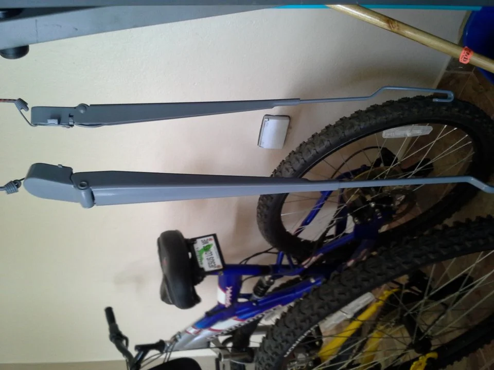

  10. Well as I mentioned before this is my progress thread of things I do to this car, small or large or just out of the ordinary.
    I took the wiper blade arms off today as they are paint faded and look like crap from all the weather exposure and sanded them down, primed and painted them. Once they were done, reinstalled them and they look brand new again. I always hate the fact of looking out the windshield and seeing faded discolored wiper arms.

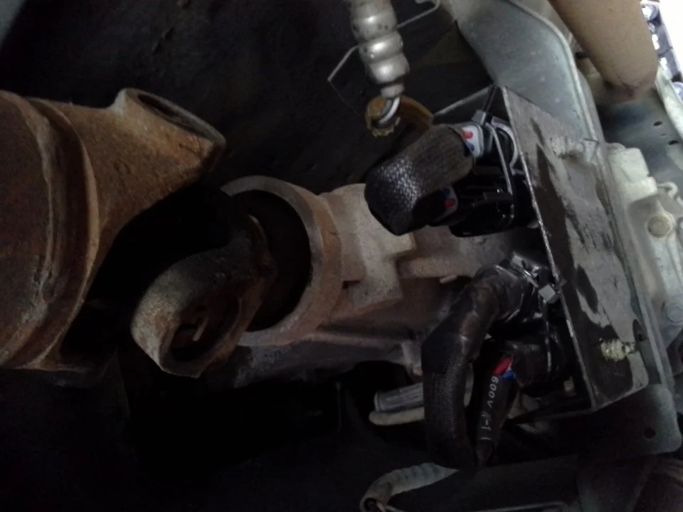

  11. Well I received the MIL Eliminators, and got them installed.
    Wait and see in the next 30-50 miles to see if it takes care of the PO420 and PO430 codes.

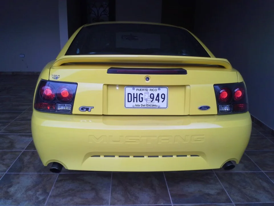

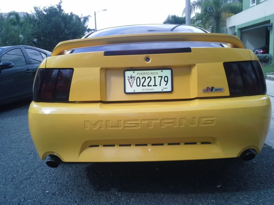

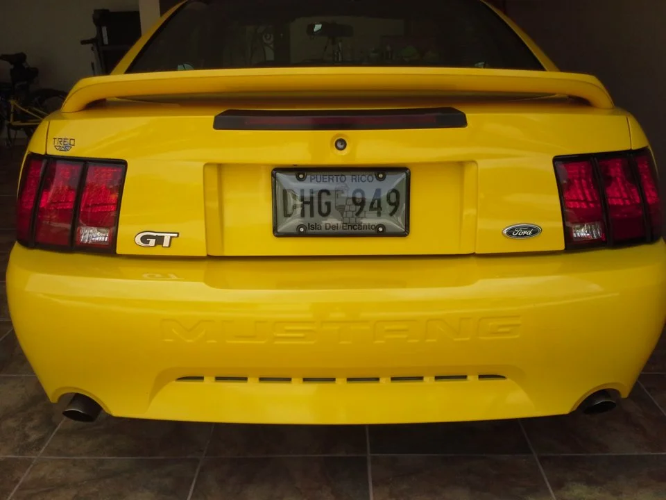

  12. Well after 3 weeks, received my tail lights in (OEM) and was able to get rid of the euro tail lights.
    Before
    After
    Much better than those euro's in my opinion.

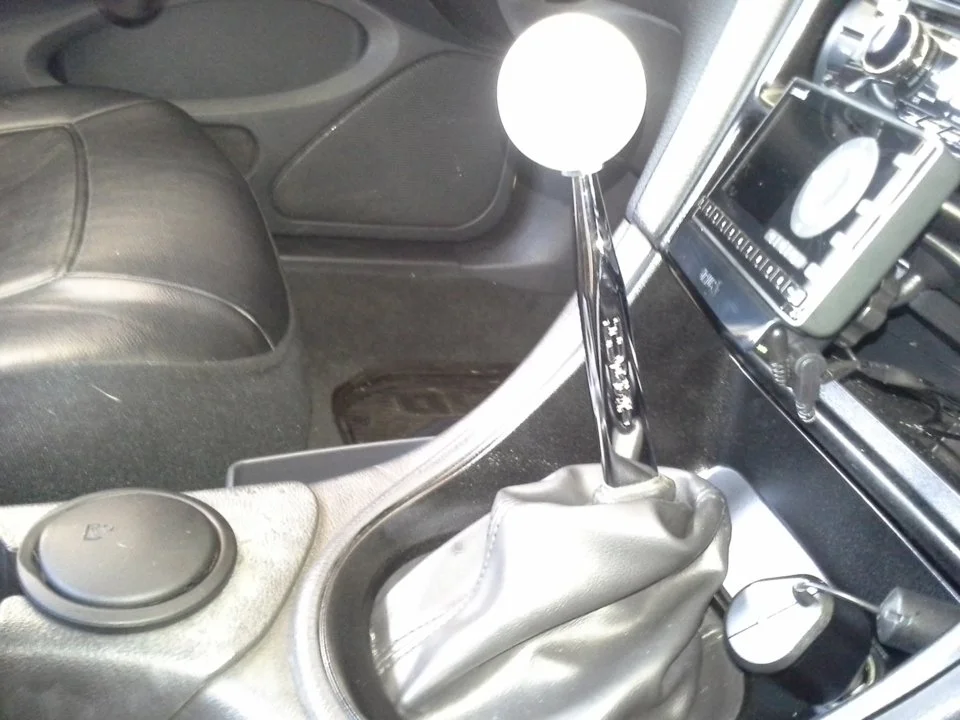

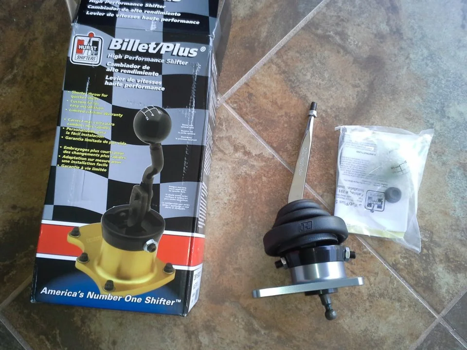

  14. Well got the hurst shifter on order with Summit Racing, should be here in 2 business days. Next will be the chin spoiler and mach I grille delete.

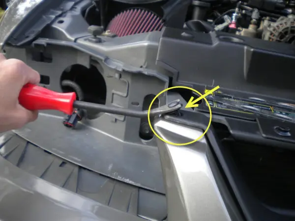

  15. Great thread stangr5oh! Enjoying the read. Just a word of advice on the Mach 1 Grill delete kit. When removing the push pins on the factory setup, use caution! The pins in the image below are difficult to get out and the plastic on the header panel below can be brittle. If the plastic tabs on the header panel break then you are left with a sloppy hanging bumper as this portion provides a great amount of structural support! I performed this apperance upgrade on my 01 GT and really liked the results!
    Best of Luck!
    stangr5oh likes this.
  16. Cool, thanks for the heads up. I have been waiting on the kit to come into stock at AM. I just got an e-mail alert from them on the 21st and then again today, but it is not so. The kit comes with the grille delete and also the chin spoiler, well each time they say it is in stock, it is one piece and not both at the same time.
    The shifter will be here today, and the headlights will be here tomorrow. I purchased the shifter rubber boot at PEP Boys for the Hurst shifter, and I am going to mess around with it to make it fit and hopefully make it look liek a Ford option instead of the stock shifter vinyl boot. And try and use the chrome trim ring that comes with the rubber boot. I purchased another shifter plastic bezel to experiment with and go from there. The goal is to make the bezel opening square instead of oval.

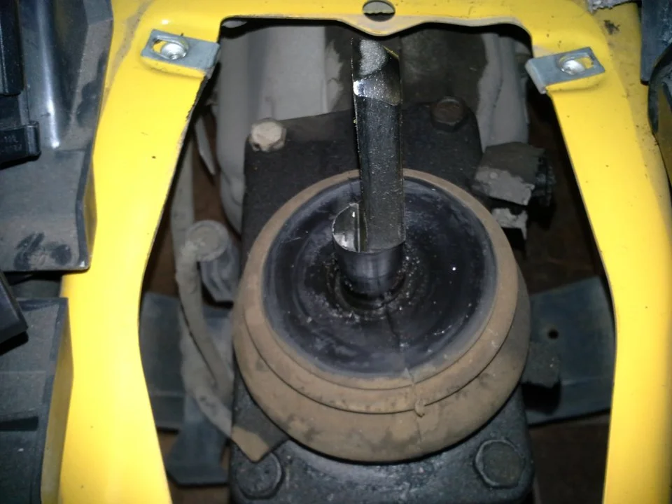

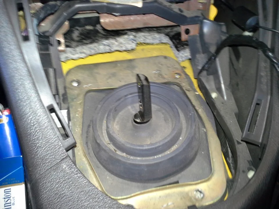

  18. Well I got the shifter installed today. Took it out for a test run for about 75 miles, enjoying the ride. The new Hurst shifter is so precise and smooth when shifting. 10x better than the stock shifter.
    I was in the process of installing and got the old shifter out, then I realized I did not have any RTV to seal the base plate and spacer to the tranny opening. Had to put the old shifter back in and head down to PepBoys to get some. That sucked ass for sure. But all good.
    20140828_085454.jpg 20140828_092436.jpg 20140828_092514.jpg 20140828_105110.jpg 20140828_111209.jpg 20140828_111227.jpg

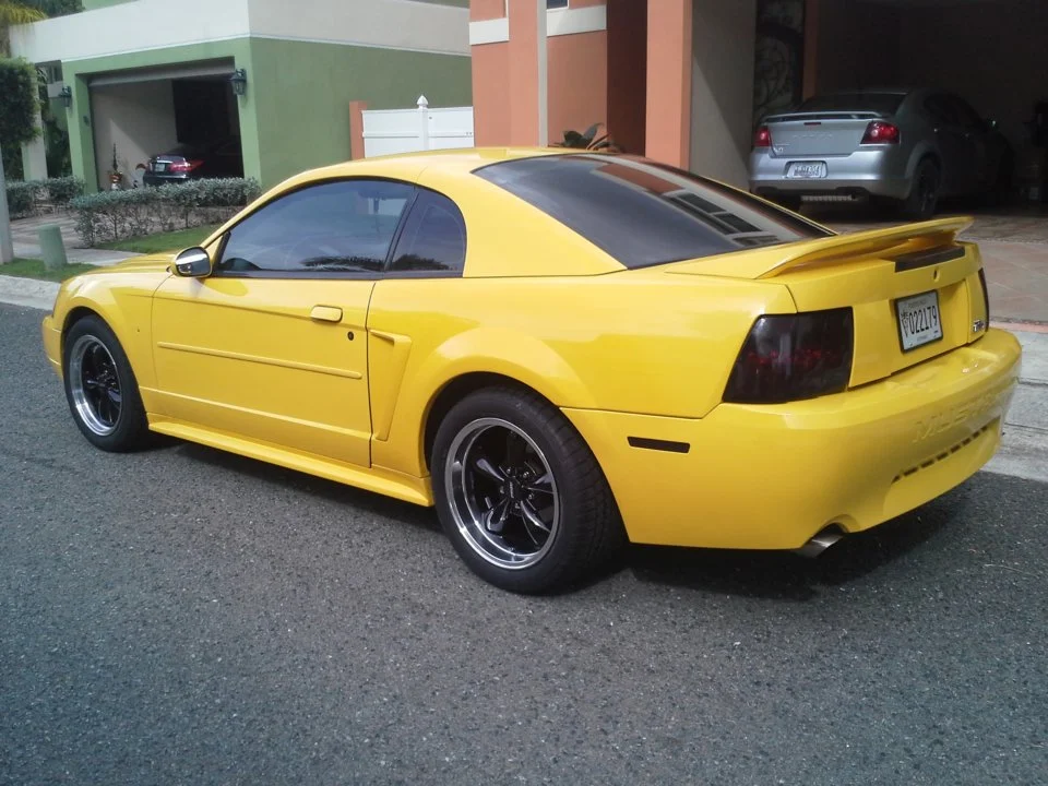

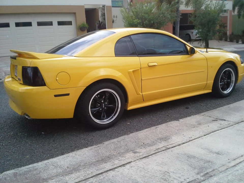

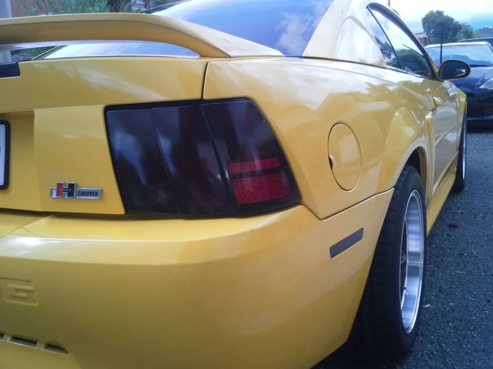

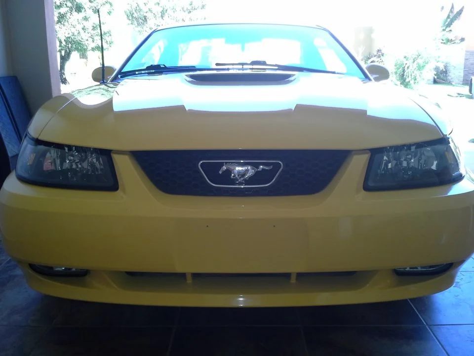

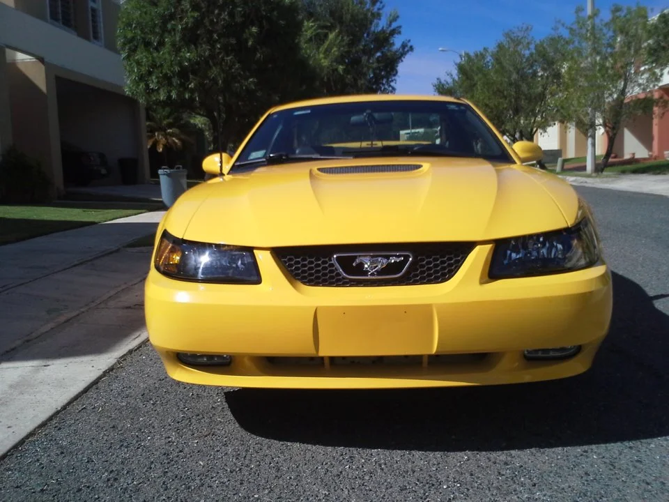

  19. Well I got the new headlights installed today, out with the crappy euro projectors and in with the AM black OEM, much better, and got the windows tinted, along with the taillights and side markers tinted. Also I rent to the tire store and had them put on a new replacement rear driver tire as the one I received mounted on the rim from American Muscle had a bead rip that happened when they mounted the tires and rims. So all good now. Still awaiting for the chin spoiler and grille delete to come in.
    20140829_092152.jpg 20140829_092246.jpg 20140829_155044.jpg 20140829_155141.jpg 20140829_155516.jpg 20140829_155058.jpg

  20. Looking good!! One other thing on the grille and chin spoiler. Those grille pins are definitely easy to break as said above. Also, the chin spoiler I bought came with a similar type of pins. I used small stainless nuts and bolts on mine instead and have had zero issues. Worth the $4 or so it cost to use them instead of plastic fasteners.
