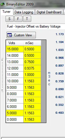

    Also, try setting injector breakpoint to 2.500 for all values, and try this injector offset table.
    [IMG]
    Those are the settings provided with the newest version of binaryeditor for 42 lb injectors.

    thanks for the reply, im going to try it this weekend and see how it goes. going to try doing the basics injector slopes, maf transfer, injector breakpoint, and battery offset voltages.

    Just an update, got the battery in the trunk mount now and hooked all the wiring to the engine back up. Changed the plugs out again as the car was running really rich and finally got it to idle (after adjusting the throttle body and messing with the tps voltages in BE). Doing some data logging and downloading my brothers tune we saw my AFR was in the 6:1 ratio. We played with the maf values that you guys gave and recalculated them using the analyzer, and brought the AFR into a respectable range 12-13:1 which is still a little rich but ten times better than it was. Next I plan on installing my lm-2 wide band o2 and reading the real AFR's. Thanks for all the help guys.
