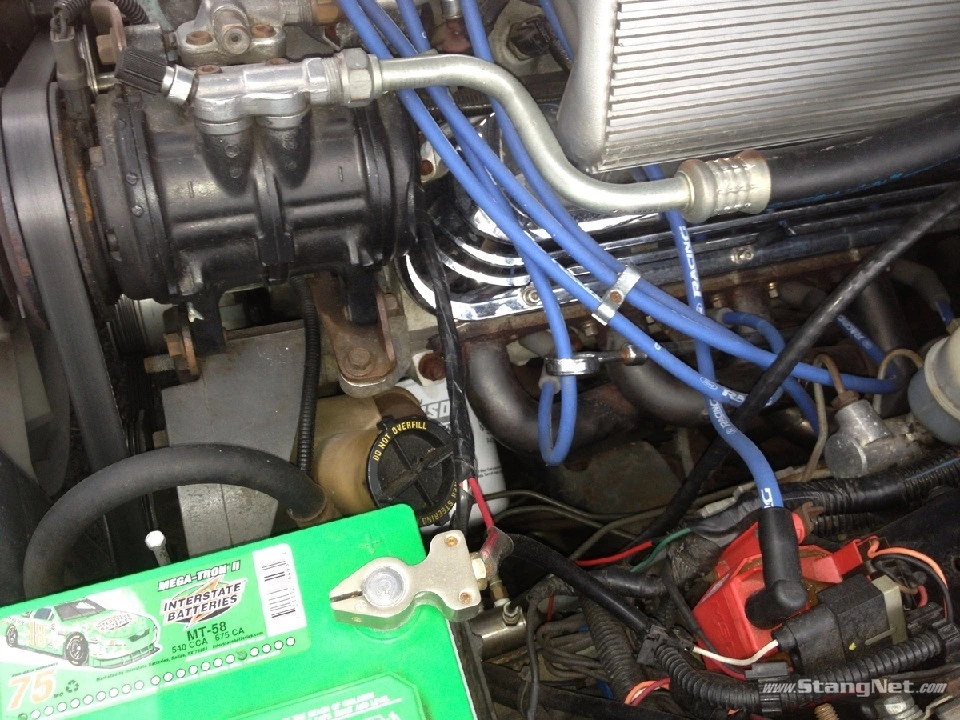

Here's a car I bought two days ago from a nice fella named Ron in NJ. Yes, it's identical to the other 1991 black hatchback, except that it has a black interior. I am getting back to work on the turbo '91, and I plan to work on a couple of things, like swapping a couple of body panels and the black interior for the grey in my other '91 hatch. In the mean time, I'm going to enjoy driving this one, as the drive-train is fantastic:

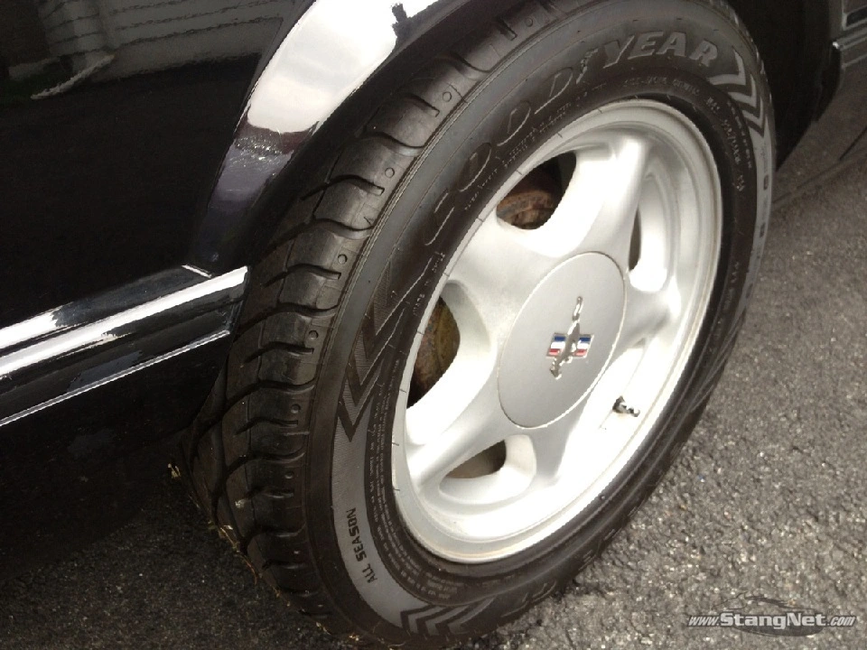

- 17x8" OEM Mustang Bullet Style Wheels w/ Michelin Cross Climate 245/45/17s all around for daily driving
- 17x9" 20th Anni Wheels in anthracite
- Front: (245/45/17 Michelin Pilot PS4)
- Back: (Nitto 555RII 275/40/17 out back)
- 17x9" OEM 95 Cobra R's w/ Bridgestone Potenza RE-71RS Autocross Tires

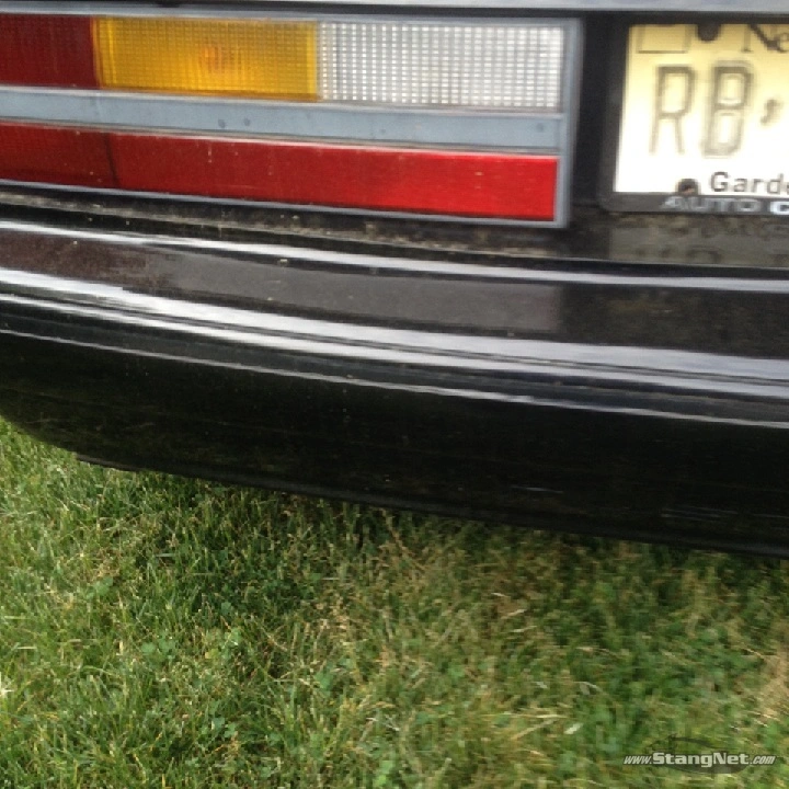

- half-dollar sized bubble in right rear 1/4 panel (repaired)
minor rust in the door wells, but the frame/suspension/body otherwise look great (repaired)

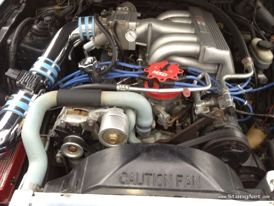

- Overheats gradually at idle or low speed. (repaired)
- No Headliner... Swapping black interior into my other car, and I'll order one from LRS (repaired)
- Whistling sound in vicinity of the driver's side of the GT40 upper... I'm thinking it's a vacuum leak, but don't see anything. (was BBK TB repaired)
- CAI tubing rattles into the strut tower (repaired)

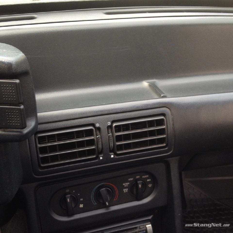

- No sub-frame connectors!!! How is that possible, given all the other mods? (custom subframes installed)
- Center dash vents are missing the center fins (replaced)

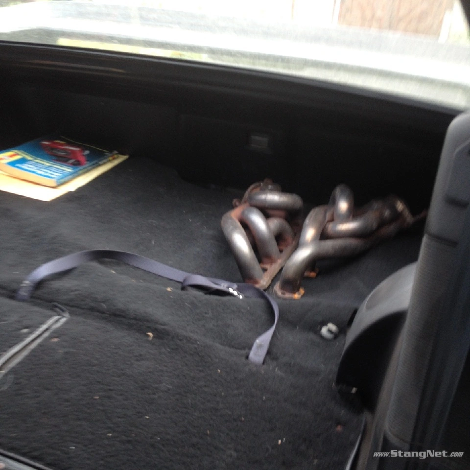

Came with extras: front B-springs, distributor w/ TFI, BBK equal length shorties, A9L box, Sunroof,

Seems I solved my minor overheating issue today. After replacing the stock fan, fan clutch, t-stat (from 180 to 195*), and water pump, what actually fixed it was replacing the ASP under drive pulley on the water pump with the stocker. Well, I might have wasted $33 on a water pump, and $60 on a fan clutch, but I appreciate the peace of mind that comes with knowing the cooling system is in good shape.
