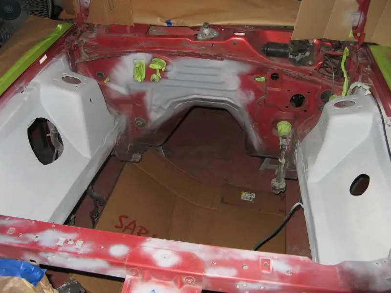

    Actually, DAY "4" is combined into a few "part" days. The E9 is ready to go on tomorrow, hopefully before dinner, at which point I can shoot some photos.

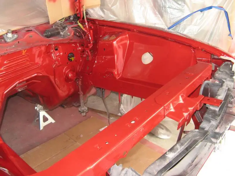

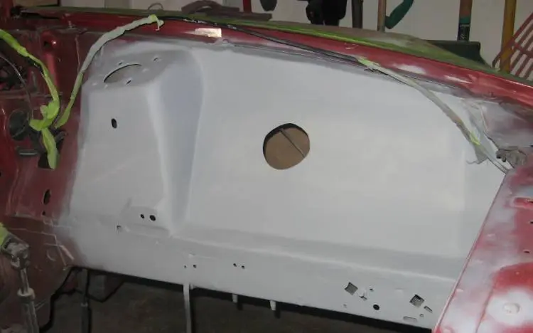

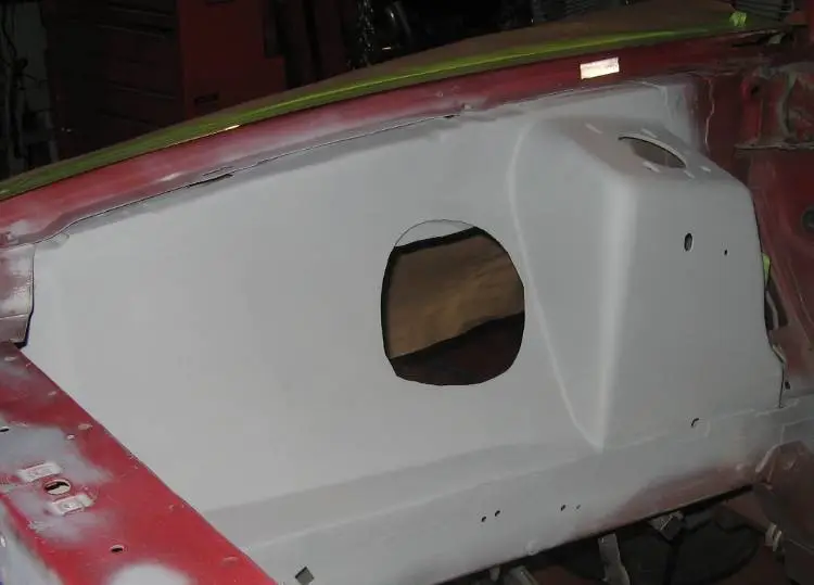

    Here is the area primed and ready:
    [IMG]
    [IMG]
    [IMG]
    Took me about 4 hours today after Wed primer to sand out all the black paint spots put over primer (to detect pits, etc). Got the area cleaned up really good around the car.
    NOW, according to my painter, who has been doing this for 25 years, we do NOT need to put primer over the current red. He said that we only need to clean the red good and scuff it up with a Scotch pad. The only areas that need additional primer are those with bare metal exposed.
    Sat morning we need to rig up a bay using drop cloths hanging from the garage door. Look for finished pics on Sat or Sunday
    Thanks
    RC

    Looking good. Do you plan on keeping it lazer red or is there a color change in the works I dont recall reading the color?
    I have heard from many body guys you only need to scuff up the old paint to give the paint something to hold on to just make sure there is no rust under the paint. I have painted or worked helping buddies repaint 3 cars in the past. Not that I am any kind of expert...but I did ask experts for some tips.

    That would be "E9" above ...Laser Red Metallic....Want a clean blend-in.

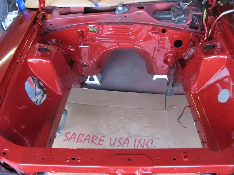

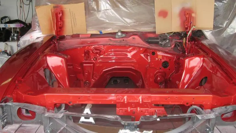

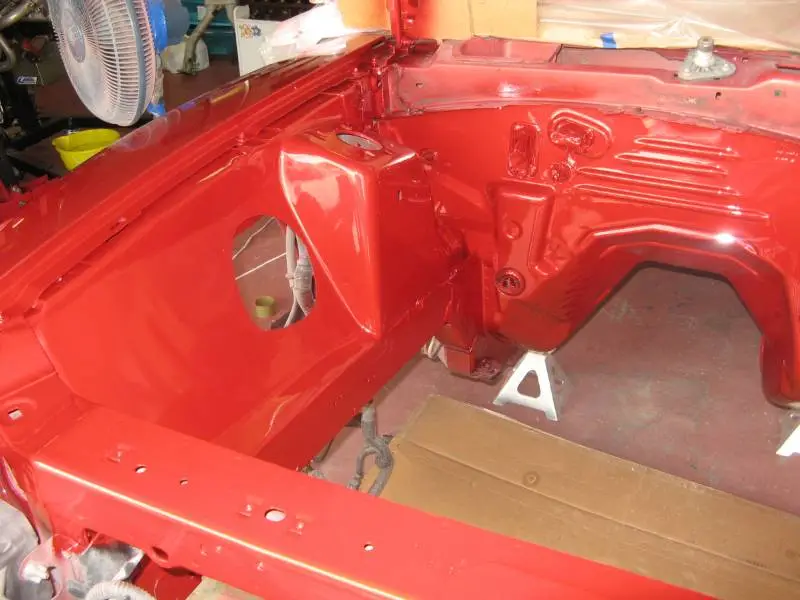

    Paint is done...Have a Headache from the clearcoat..LOL
    Had a big stumbling block....will explain later.
    First pic is after first coat.....next 3 are after 3 coats of red and 2 of clear.
    RC
    [IMG]
    [IMG]
    [IMG]
    [IMG]

    It's much deeper red than the pics look....pics make it look more Vibrant red...up close is nicer

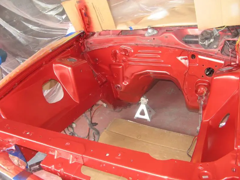

    [IMG]
    Higher up shot with NO FLASH...this is more realistic to what I am seeing!
