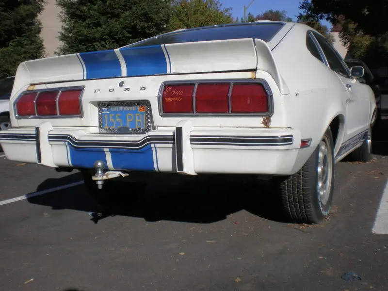

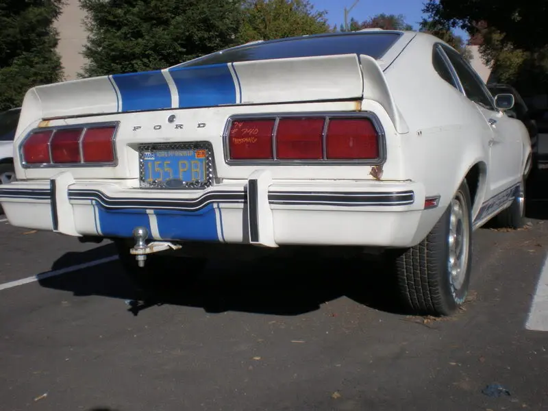

    As to your tailight Q's, I never found a thread (but then again I don't think I looked)
    To put it bluntly, all you really have to do is get a second set of lights, cut out the interiormost (red) lenses and then cut out the orange lenses from the ones you're putting back on the car and attach the new red ones. I was able to heat up the edges of my orange lens and pry it off. Then after cutting the red ones out, i used some outdoorsy glue to put it all together. My cutting could have been better, but I deem my set "good 'nuff"
