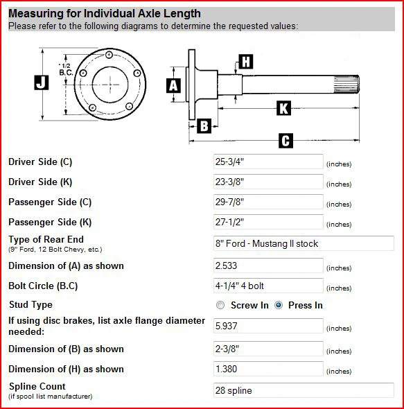

    If anyone needs any info, I'm ordering new Moser axles for my II, since after the last time at the track, I'm gonna have to go through some tough tech inspections for the first few races... So I thought I would pass this info along if anyone needs it!

    I ordered mine as well, pretty much the only measurements they need once they knew it was a stock style 8 inch was drivers sice (C), Drivers Side (K), Passenger side (c), and Passenger side (k) They already know H, and other than that whatever bolt pattern you want.

    How about everyone posting the measurements they used to order? I'd like to see if they match...

    I'm getting ready to order new axles from Moser. Here is what I measured using a digital caliper & tape measure. Dimensions taken with a tape measure were after I leveled the axle on my bench and then used another level to measure to off the end of the axle. I measured the axles twice on two different days and came up with the same results.
    Here are the stock Mustang II measurements with 4 lug 4-1/4" pattern:
    [IMG]
    Here are the stock Mustang II measurements with 5 lug 4-1/2" pattern:
    [IMG]
    Hope that helps someone.

    I came up with the same measurements, except for these:
    Code:
    Drivers Side (C) :       25 13/16
    Drivers Side (K) :       23 7/16
    Passenger Side (K) :  27 9/16
    The difference is 1/16" between yours and mine. I have yet to try fitting them in to see if there's any problem. Hopefully this weekend :)
