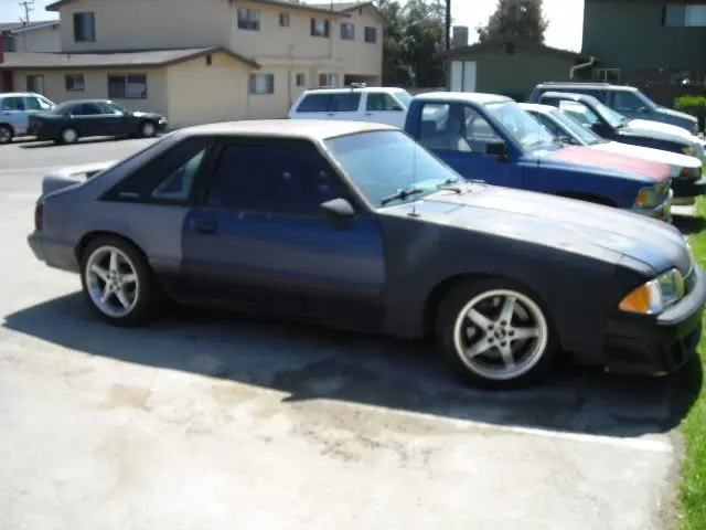

    I am finally able to announce that my little stang is finally getting the bodywork done and finished. Heres a little work shots for the rough work done so far. Images to come:

    was that a GT you switched over to an LX? and what are the 42# injectors for? what color you painting it?
    looks like its been a good project car so far. can't wait to see it painted

    It was originally an LX and I was going to do a cobra conversion, however I had a run in with a parking block. Tore that bumper to shreds and I realized that I loved the way it USED to look.
    I am going to paint it Bimimi Blue. Molding and all. The wheels are going to get re-powdered a darker grey, as they are silver right now.
    The 42# injectors were for a supercharger that I used to have. That is now mounted onto one of our fellow stangnet members vehicles. I still have em, but don't know what to do with them.
