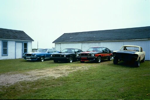

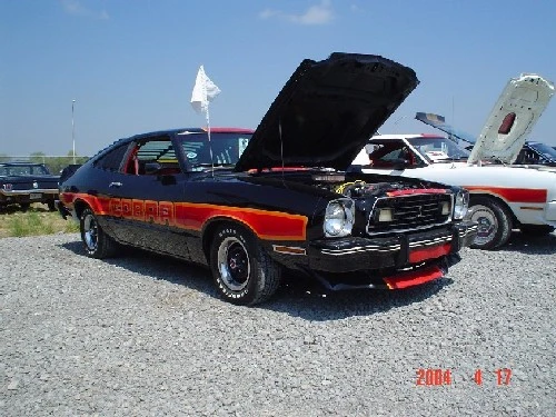

I thought my '78 sat too high in the front, so I cut 1 full coil off the top so it would fit back into the same pocket positions it was in. It dropped it at least 1" and looks much better. I did this about a week before the Nashville 40th, then drove it from Michigan and back. No changes to alignment, drove great, NO tire wear. I do have to be more careful on driveway approaches with the spoiler and on big bad bumps it does bottom out on the snubbers easier, but overall, I am pleased. Its not a daily driver, but I do drive it whenever I can on the weekends in nice weather. One thing to consider is that I am running the stock wheel and tires. Attached are 2 pics, maybe you can tell the difference. One is with the other Mustangs before the coil cut, the lone shot is after the cut.
