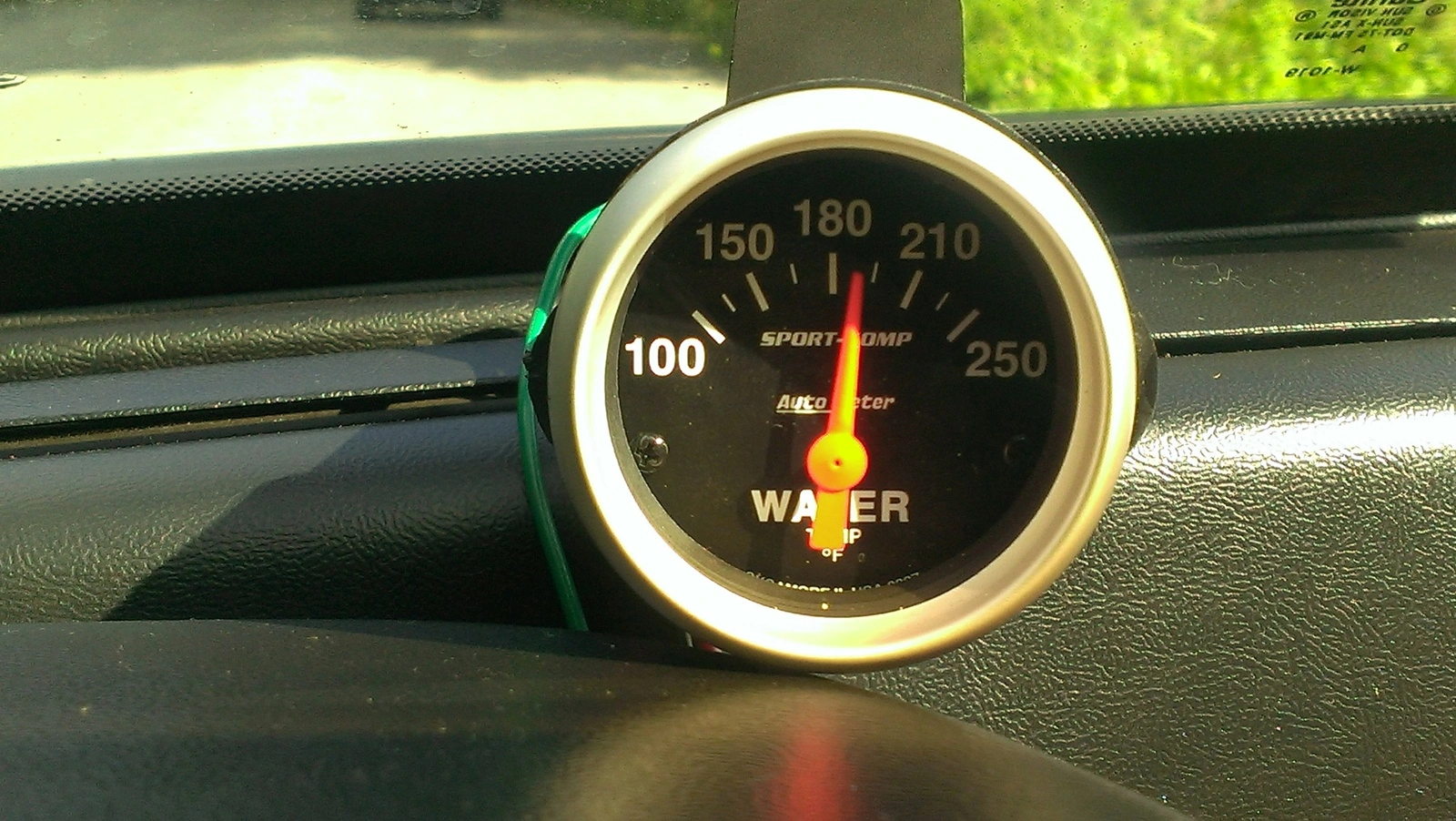

    So my anxiety got the better of me and I lost almost a week and a half of fun. Installed this today and after a 30 minute cruise and some 1st through 2nd rips all is well. Shouldn't have trusted the old stock gauge, it would have been almost pegged if it was hooked up. Temporary mounting location for the gauge, I am going to mount 3 under the radio.
    Just happy that I don't have to make any immediate changes to the coolant system.

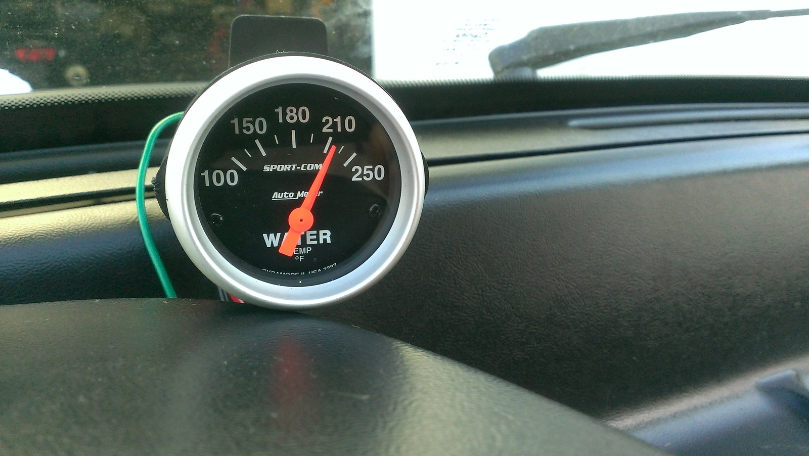

    Is that a pic of the real temperature?
    If so I wouldn't be so thrilled with 215+ degrees.
    I had mine setup to run 180 pretty much regardless of the weather. Some prefer 190, but close to 220 would make me nervous.

    uh... that ain't good IMO. If you have a 192 stat your car shouldn't be at 220. Maybe 5-10 over but not 20 degrees. Did you see the gauge go up to 200 or so and then drop when the stat opened or did it stay up.

    Damn. It dropped a little when stat opened then went up to 210, guess I am going to have to throw some money on maintenance issues. Drove the car today and when I shut it off the fuel pump stayed on. I think that just means a bad relay, correct?

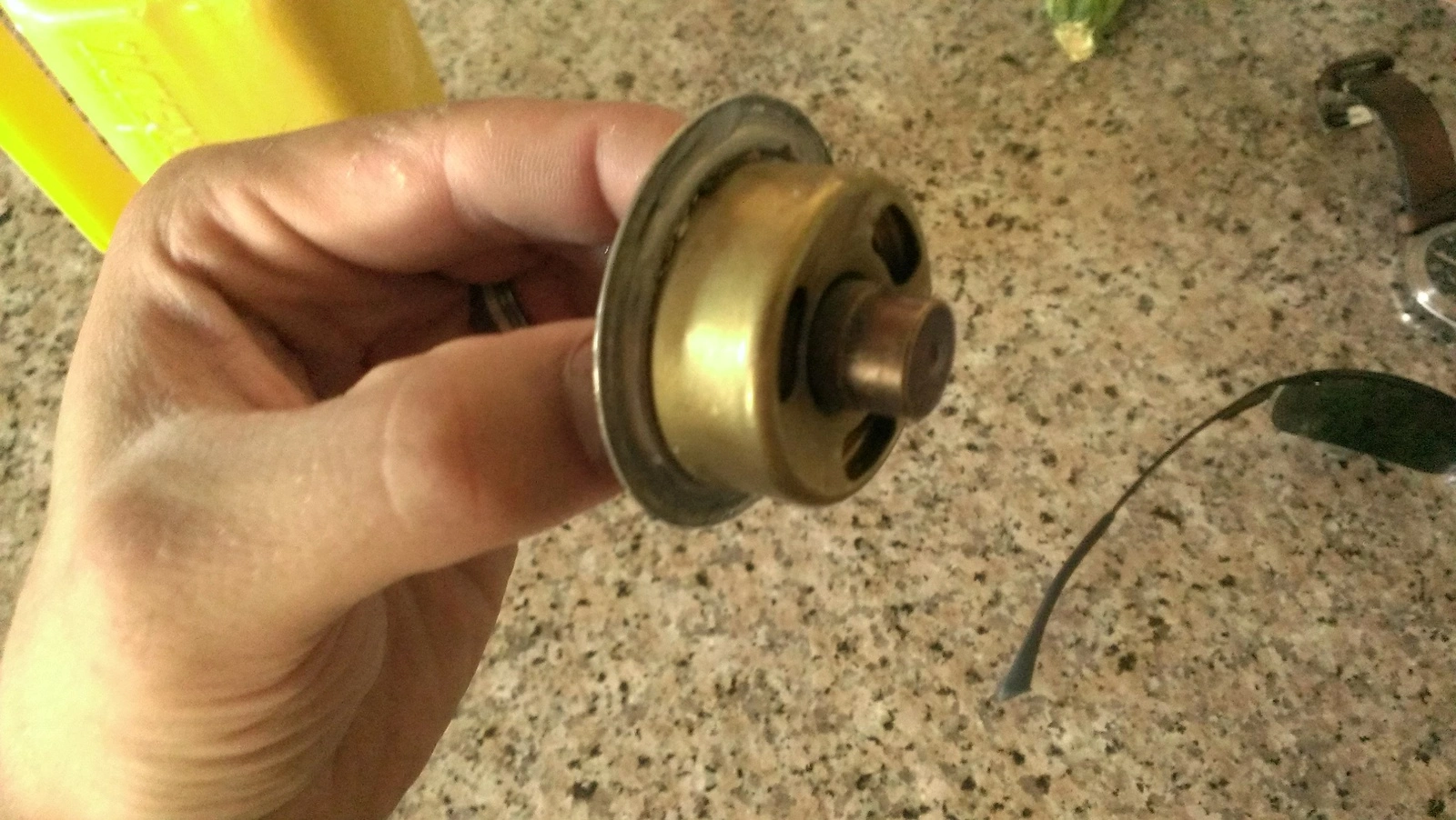

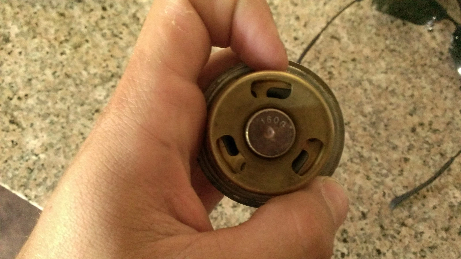

    This is the tstat that was in the car. It says it's 160, but I have never seen one like this before. I knew fluid was flowing before, but I dropped it into some boiling water just to be sure. It took about a minute and a half to open. May have been the main culprit all along but an upgraded radiator and fresh coolant can't hurt either.

    I prefer that brand, it's a mr gaskets. 160 is too low though, especially with an old radiator, it will basically run wide open all the time and the coolant never has time to cool.
