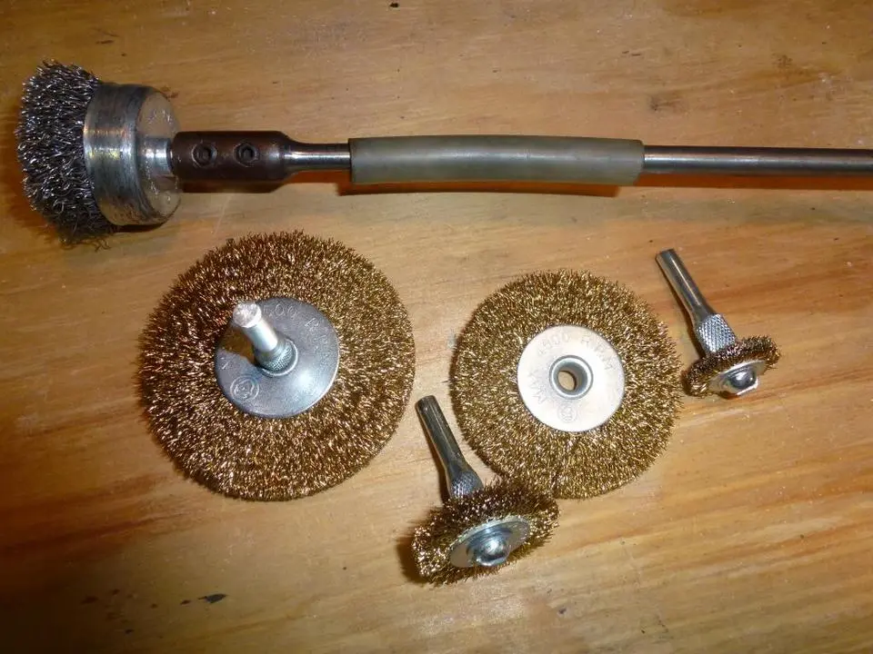

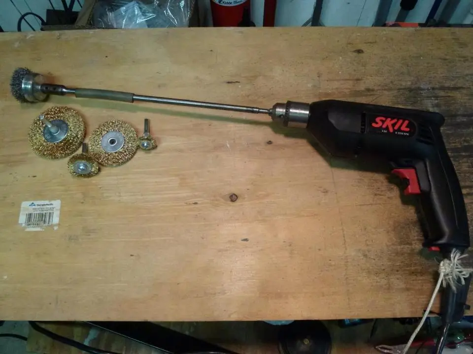

These are MY Favorite Rust Removal Tools - simple but effective.
The tips change out to those that can get into small spaces.
Notice the piece of rubber tubing on the shaft, I oil the shaft here and use the tubing as a holding stock while the shaft spins. The oil keeps the shaft from getting too hot in my hand.

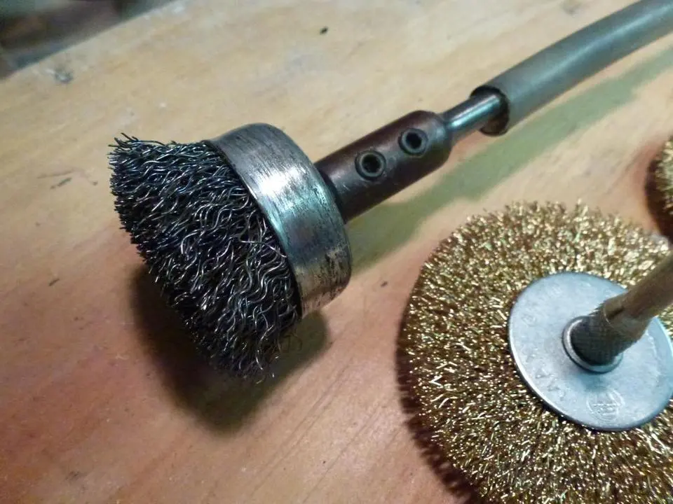

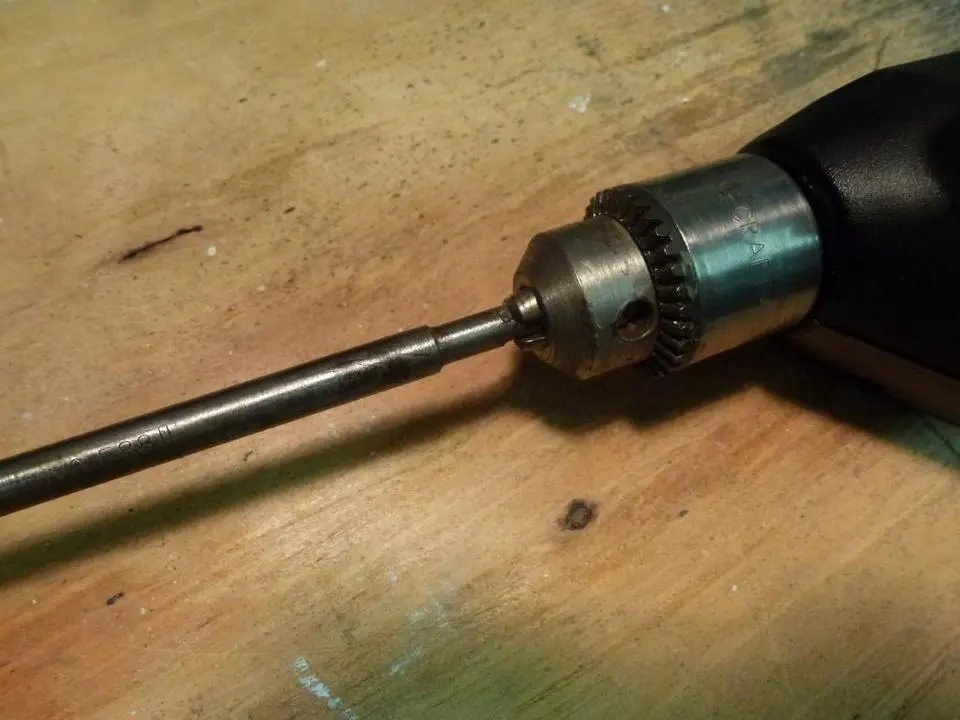

The key piece in this setup is the 12" shaft that is really and extension tool for drill bits etc. It attaches to any hand drill and is secured by a tapered, notched shank. The end that attaches the cup wire brush and other wire wheels uses allen screws to hold the brush shafts.
What I like most about this setup is that you can apply pressure to the shat while it is spinning to be as delicate or rough as you'd like. I taken off you pretty deep rust with this setup.
