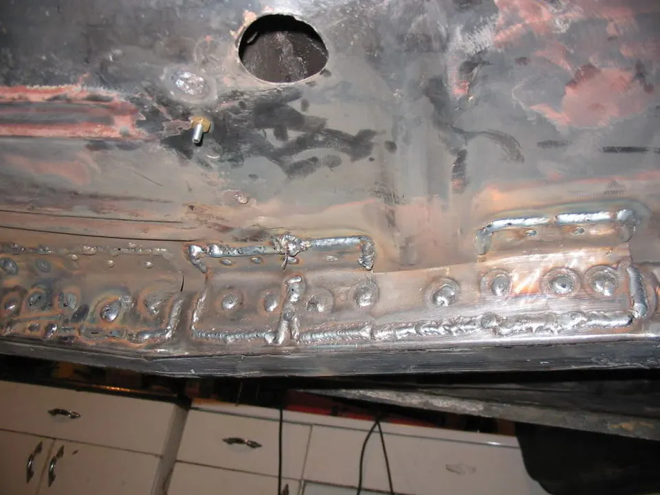

I would not leave the risers out if the rest of the unibody is stock. I think I am leaving mine out, but there is a lot of things I am doing to stiffen the unibody. The rockers carry a lot of the load and the risers give extra support the middle of the rocker. If you have frame connectors and tied them to the rocker and the pan it would give back some strength to the rockers.
I would guess subframe connectors would suffice. I bent up angles and welded mine right to the floorboards, and I wouldn't be afraid of taking the seat pans out. You can also tie the connectors into the rockers for additional peace of mind. Front torque boxes are a good idea, too, but they won't help much at the seat.
I have subframe connectors on there now but I'm replacing them with a newer set. I'm not sure if i want to tie into the rockers but the cars far from stock anyway so it might not be that big of a deal. I was planning on adding torque boxes but didn't have the time or money when I did the pans:nonono: If I could get a hold of a metal brake I'd make my own risers to work with the seats.

It ain't really much of a set-up, I just bent 18 Ga metal and welded to the floor and connector. I just mentioned connecting to the rocker, but I didn't do it.
Here's a shot:
