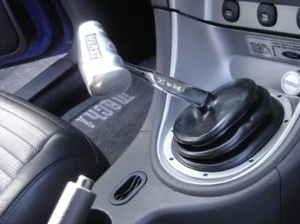

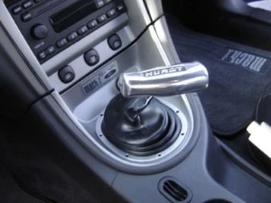

I have the setup like this one, its a MRT short throw shifter (built by Steeda) with a T-handle and stick from Jegs $85.00
The round boot is from a 1975 Ford p/u application still available in the parts system (fits perfect) $45.00
I have part numbers somewere in my notes if your interested...
D5TZ-7277-A
BOOT ASY
